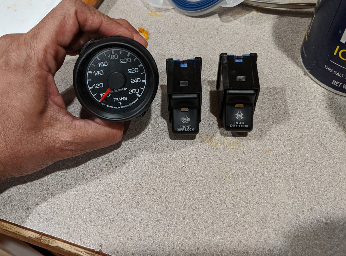

I just got this Autometer 8457 transmission temp gauge from eBay (I have the 42RLE) for a bit more than $80. I wanted something that looked nearly OEM and this fits the bill perfectly. It's backlit in the same green color as the interior TJ color, and it came with the sending unit, bung, wiring harness and detailed instructions. @mrblaine this is the one I mentioned.
Also in the picture are the switches for the independent locker mod in my TJR. I'm curious to prove to myself @jjvw's assertion on the rear vs front locker against steering question.
I just got this Autometer 8457 trans temp gauge from eBay (I have the 42RLE) for a bit more than $80. I wanted something that looked nearly OEM and this fits the bill perfectly. It's backlit in the same green color as the interior TJ color, and it came with the sending unit, bung, wiring harness and detailed instructions. @mrblaine this is the one I mentioned.

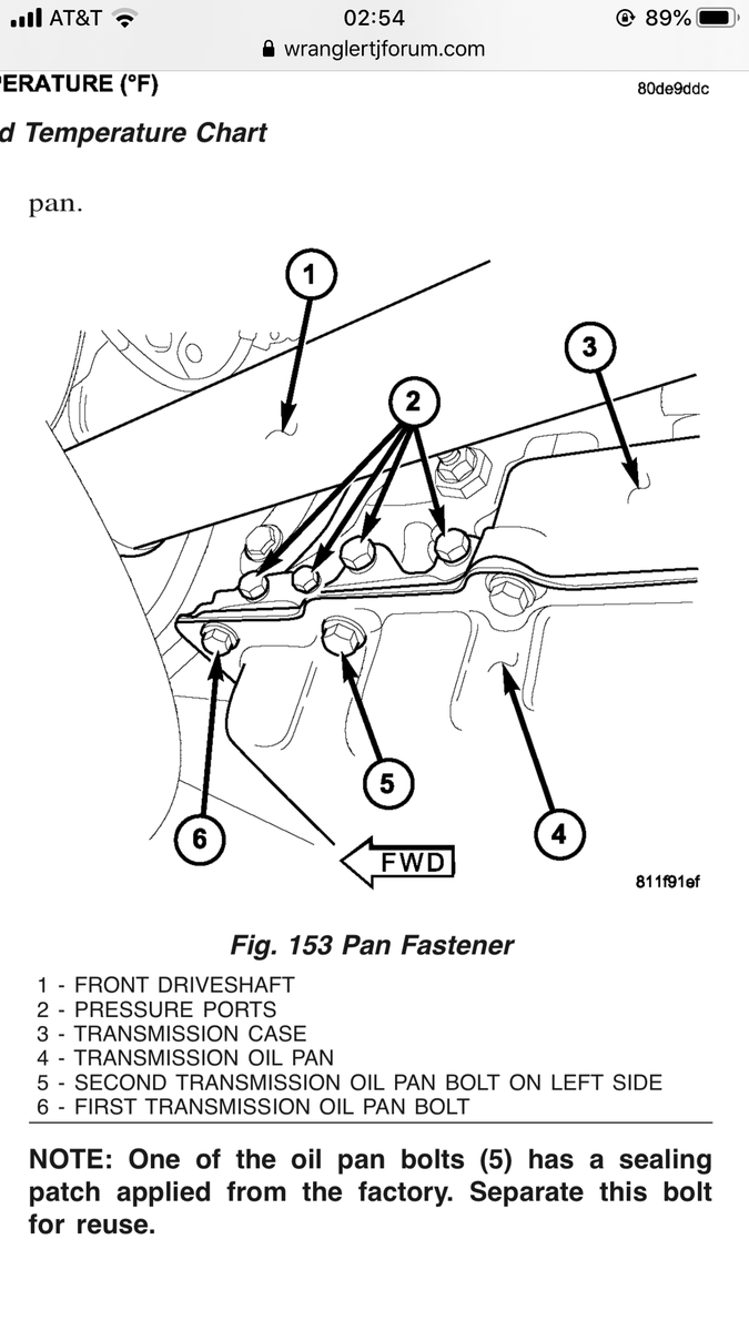

OP, are you drilling the factory pan or replacing it with one that has a drain plug in it? I'm curious, since I installed a temp gauge in my LJ by replacing the factory pan with a Dorman drain plug version. I saw numerous reviews about potential leaking problems, but haven't experienced any since doing the install. Something I wasn't aware of was that one of the pan bolts came from the factory with a thread sealant. This can be seen in post #389 in the link below.
https://wranglertjforum.com/threads/what-did-you-do-to-your-lj-today.22540/page-20#post-461342
Thanks for the info. Still deciding what to do ...

I replaced the pan with a Dorman that has the drain plug and then had a friend weld in a bung on a higher front side of the pan on the passengers side. I did replace the cooper washer with this one after reading amazon reviews of leaks from that area. No leaks yet. I used a Lube locker gasket too. The bolt with the red paint on it is the one that needs sealant. I used Permatex Ultra Black.
