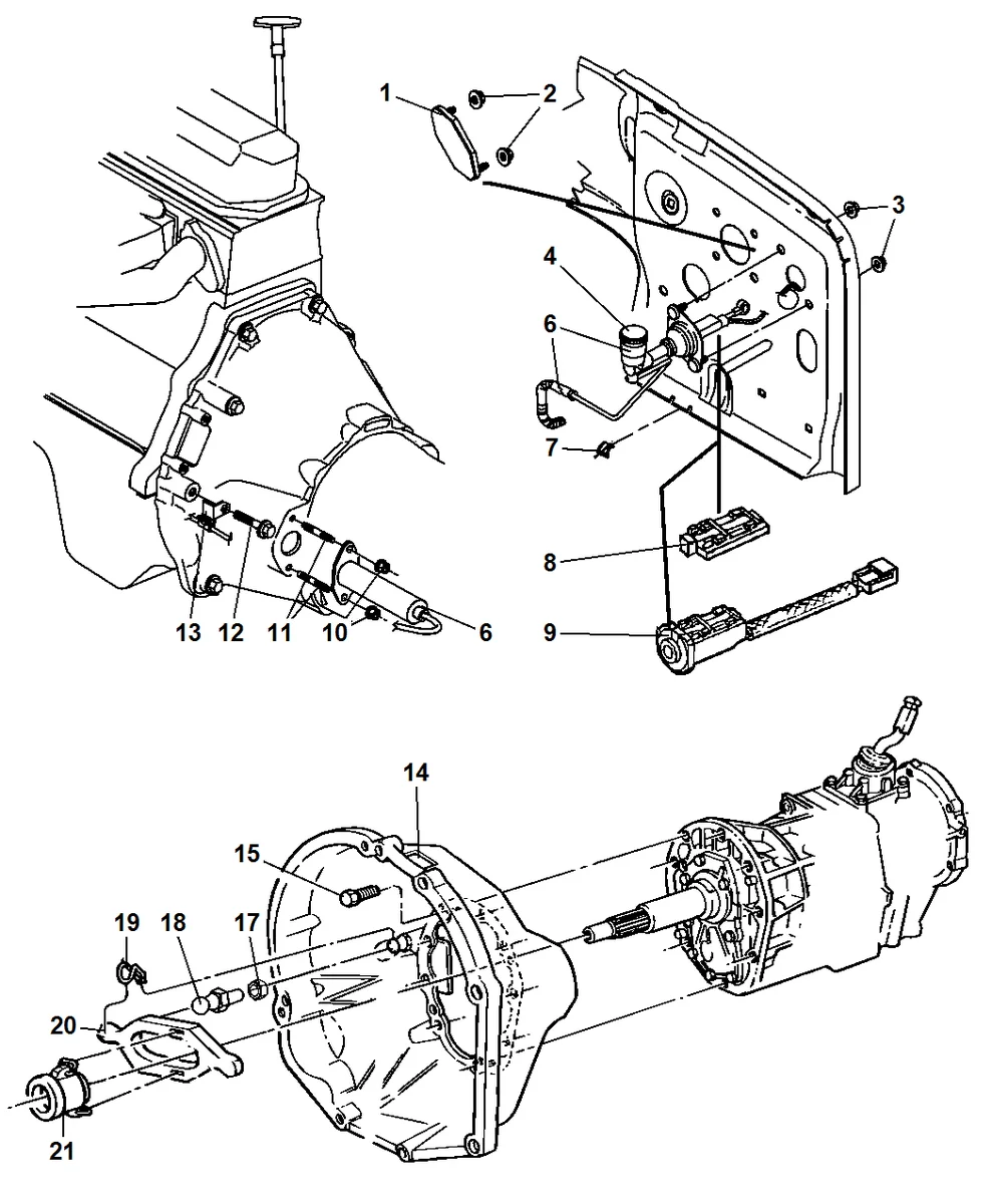

Sounds like your clutch master/slave cylinder assembly will need replaced soon. Number 6 in the diagram below.
That's what I was thinking initially. I'm going to keep an eye on it and if this issues starts to show up again I'll order one.
