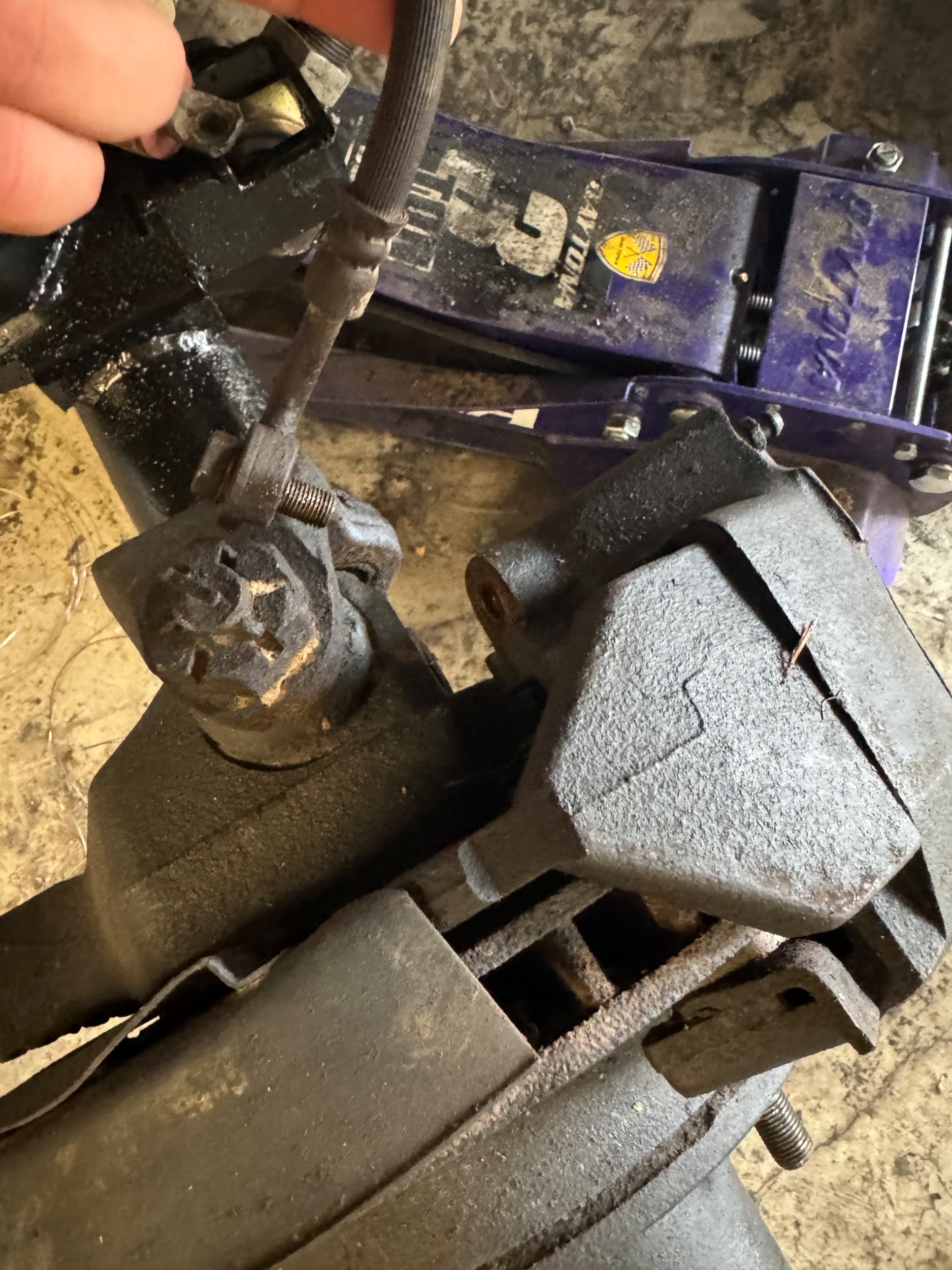

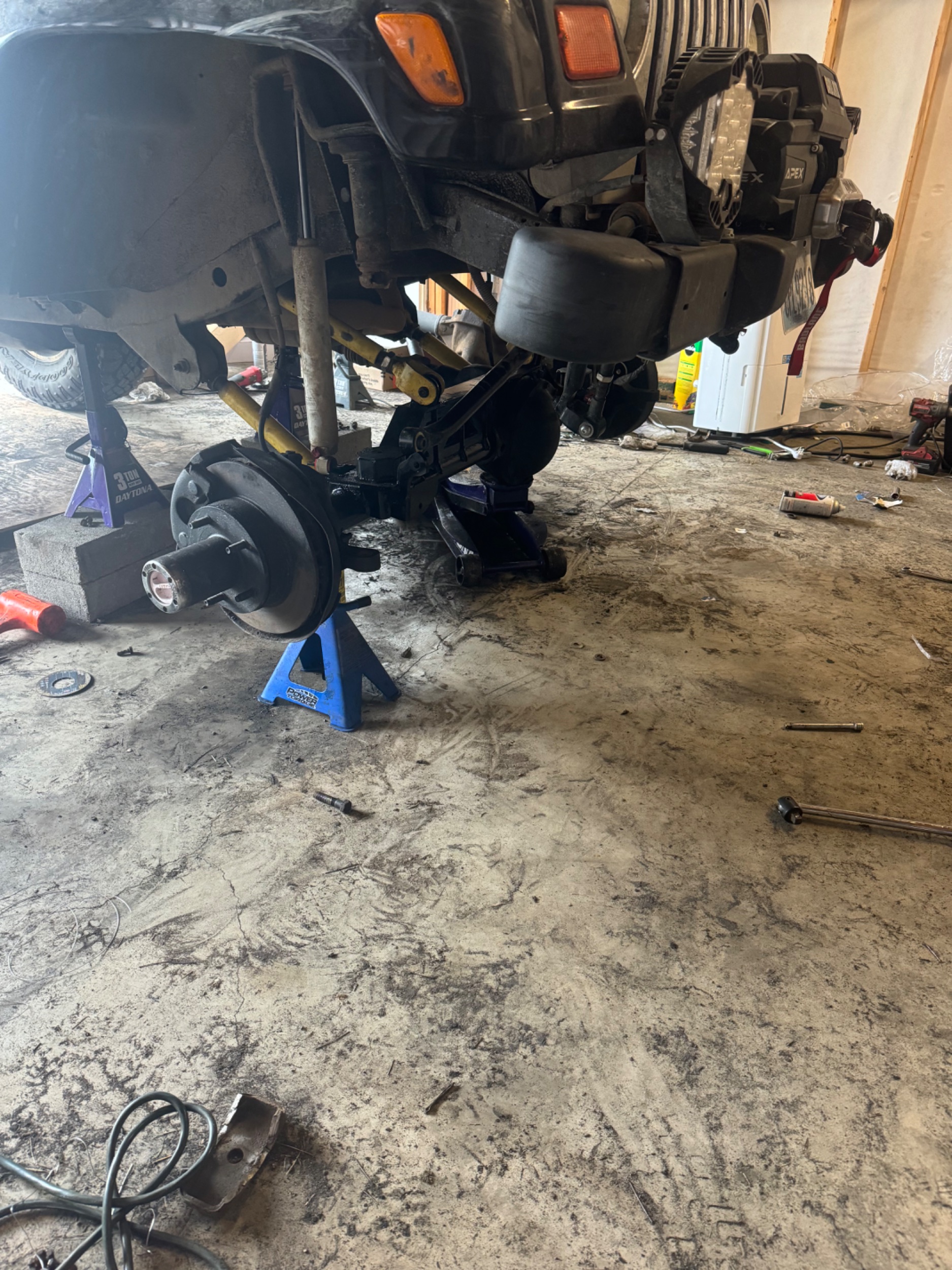

I’m half way through my 1976 F-100 Dana 44 high pinion front axle swap and I’m hung up a bit on the brake line situation.

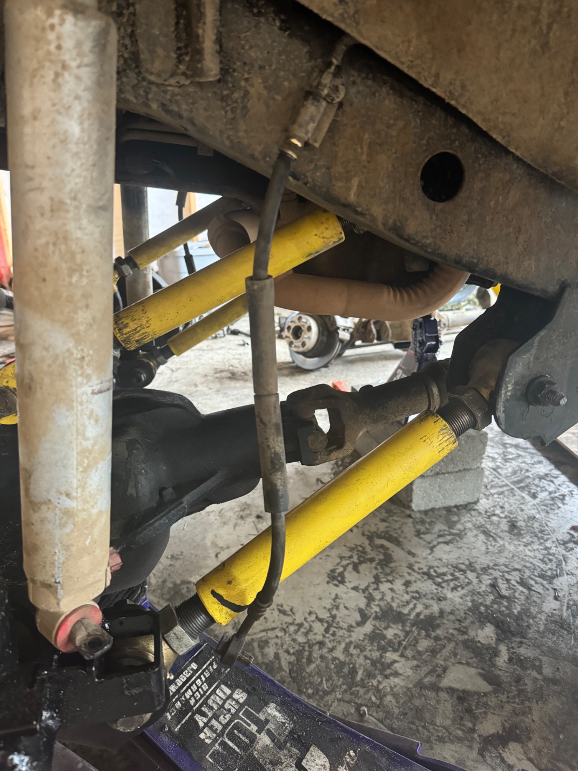

I ordered the original front brake lines for the f-100 and planed on running an extension from the frame hardline to the pig where I would tee it off to the f-100 stock lines, ultimately blocking off the unused port at the prop valve. But when I actually got into it I noticed I might be able to just get some yj lines and keep the brake lines separated from the prop valve.
Why question is, which of these methods would work better? Is there something in the prop valve that would put it off balance by blocking off an unused port? I noticed my TJ banjo bolts fit in the f-100 calipers just fine, but from researching it looks like the f-100 is supposed to be 3/8 while TJ stock is 10mm, so I’m not sure why that works.
Any chance anybody had experience and / or advice? (Pics because why not)

Stock TJ banjo bolt is 3/8-24. The combo valve plumbing for the front lines is just a Tee internally and one of them being capped off doesn't matter. We do it that way pretty often to run a single line down the upper to a Tee on the axle.

When I did my HP44 I had some new brake lines made to use the stock TJ lines at the frame and with the correct size banjo fitting. I had a 5" lift so also needed longer lines.
During my current rebuild I went to a single front line. I just capped off the unused port. It worked fine either way.
