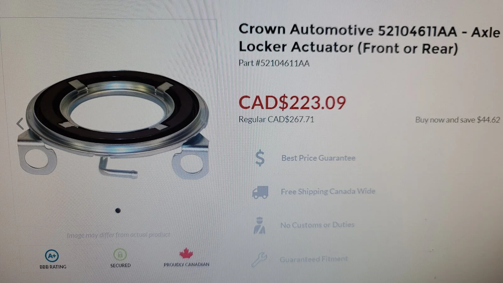

I hope this helps you decide which model and what to watch for. 2 months ago I purchased my first Rubicon. 2006 TJ, Dana 44 axels. Differential air lockers did not work. I fixed the front air pump (blown circuit board trace) and bought a used Kia air pump for the rear. Original was full of mud, water and oil. Both pumps tested to 5psi, all good. Then found that the rear differential actuator was ceased up. I worked it while applying pump pressure and freed it up to work intermittently. Front actuator just blows air right through it. Again, I can crimp the air line in the diff and the pump turns off at 5 PSI, no leaks in the lines. So for the past 3 weeks I've been scouring the planet for new or used air actuators made by Crown Automotive PN 52104611AA. I've contacted dozens of parts providers on-line and I've also talked to Crown and found that they intend to build a batch of lockers in August of 2021. I'm now considering switching the lockers to electric. Good news, I really enjoy my TJ. I've got 100 acres of farm, forest, trails, dunes and streams. I'm in it almost daily... can't wait for all 4 wheels to pull me up places I can't do with 3 wheels. Anyone out there with a spare air locker(s) please contact me. [email protected]
