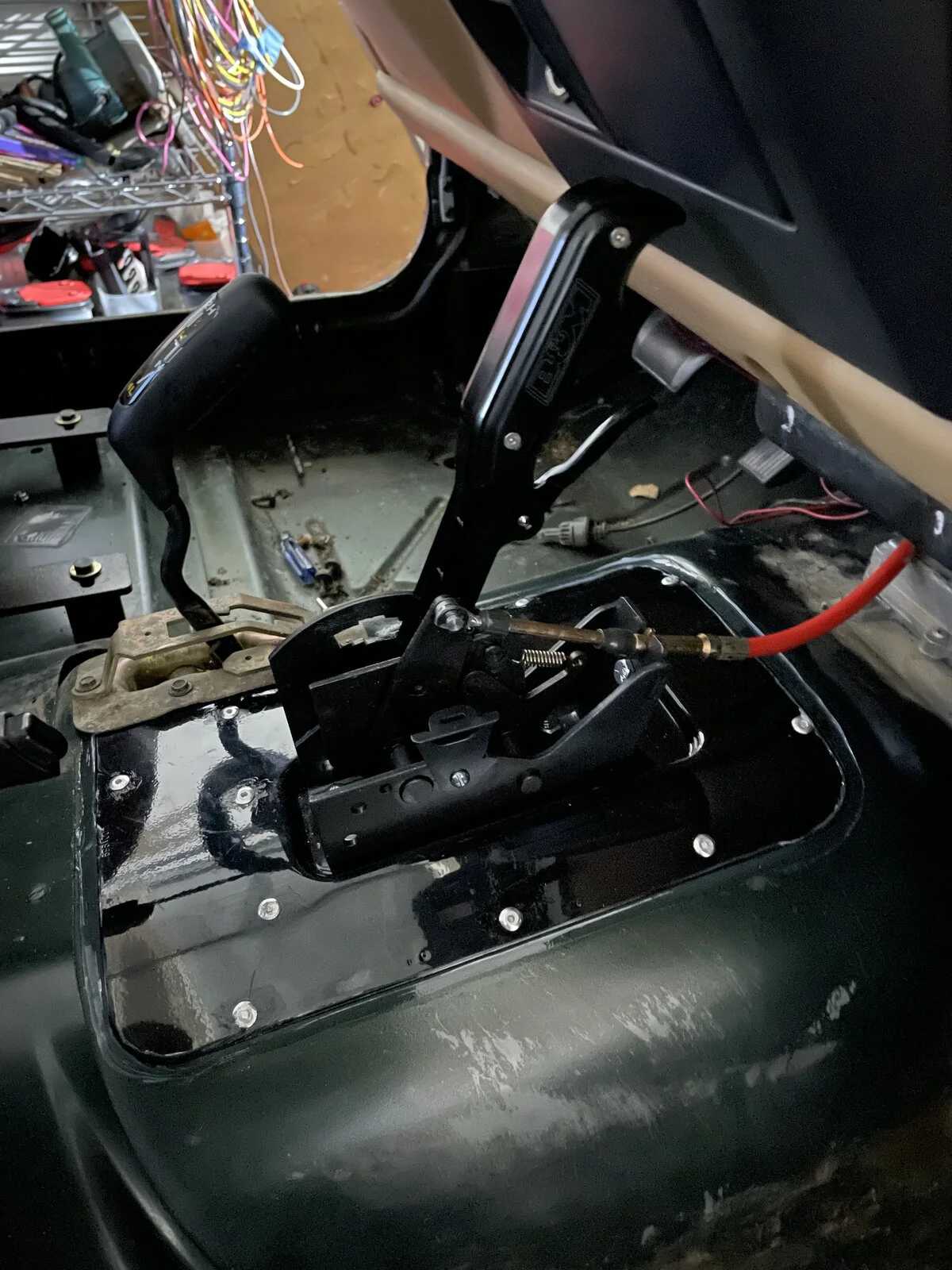

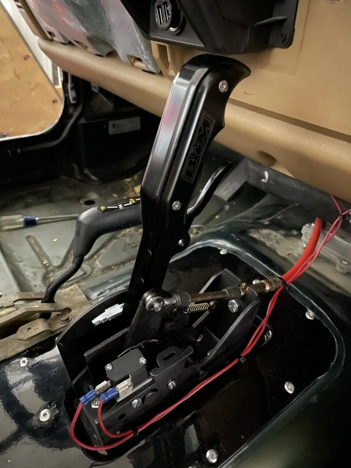

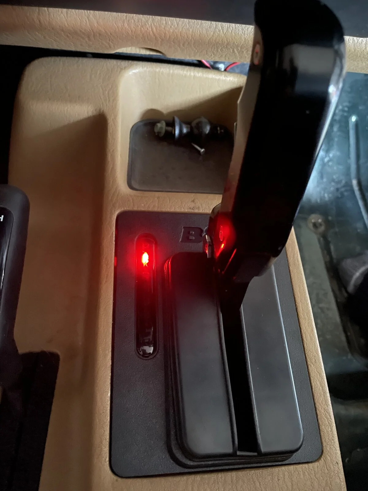

I thought I’d share some pics of this, as I hadn’t seen any pics/reviews of it yet.
Background: this is my fourth CJ/Wrangler but my first automatic. Although the auto is well worth it for both city traffic and my wife’s bum knee, I kinda miss the manual shifting. To try and scratch the customize itch and fix the annoying issue where the stock handle popped off constantly, I got the B&M Magnum Pro Stick shifter part number 81187.
Install was smooth enough and I love both the look and the feel. Completely unnecessary, but hey…oh well.
Let me know if you have any questions.

It looks cool, what's the trigger for?

Is the trigger only required to shift out of park & reverse or to shift from any gear?

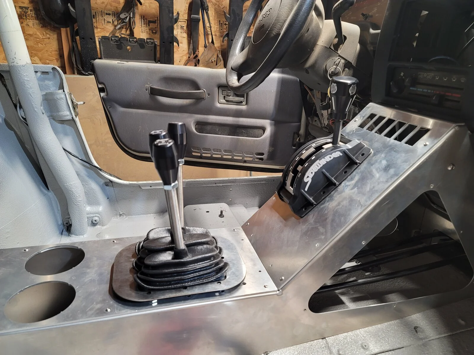

I have a V-8 swapped into my TJ and have a 46RE auto in mine and have a Sidewinder gated shifter.
This gate has “off road” in mind according to B&M’s blurb. You can actually shift from R to D without the trigger. You can also go from 1 to D without the trigger. You do need to engage it to get in and out of park, though.

Did the kit come with everything to install onto your transmission?
WOW I just went and looked at it. It's nice that someone is FINALLY actually making a shifter for out Jeeps. And that it fits the 32RE and 42RLE and AW4 and 904 is pretty cool. I had to make everything to make my shifter work in my rig. The install kit I had was for the old TF 727 and they don't offer a kit for any of the new transmission. So it's nice to see B&M stepping up.
@Wildman no offense taken - yeah, this was a whole kit. I didnt have to fab anything! It even comes with various adapters for an XJ, etc.
I had looked at other options and I agree - it was gonna take a ton of custom work to get a good solution. This one is ready out of the box and was extremely simple to install. Its super new and I couldnt find many real world reviews online…hence this thread!

Looks great, got any pictures of the gear indicator on the drivers side? I'd be curious to see what that looks like. The pictures on the Holley site are pretty poor, just show some red lights.

Really hard to get a good photo in the dark of my garage, but here you go. It is a bit hard to see the slider unlit, but I’ve also included some lit pics (and i will splice this in to a hot wire to be lit with the ignition)
Reactions: frank1 and pagrey
Those are great, thanks.
Edit: nice write up by the way, I think some of your pictures are better than the instructions I saw from B&M
Thank you…I struggled with their instructions. Pro tip: the instructions online are in color, unlike their b&w ones that come with the kit.
They also dont mention that you have to splice in the reverse lights separately, which is what those red wires are in my photos. You need to purchase B&M 130-80844 (and space it up to hit the correct spot) for that.

Why do you have to splice into the reverse circuit? That isn't done at the transmission Park/Reverse/Neutral switch? I wonder if that is only on some models?
Which brings up another point - you remove the shift interlock with this kit…so maybe that also controls the reverse lights?
Full disclosure: my PO had already wired in a janky reverse circuit and weird NSS wiring before I bought it. So this made it an easy transition for me. Your results may vary!
I just installed this shifter this weekend...I didn't have to do anything (extra) with my reverse lights to get them to work.

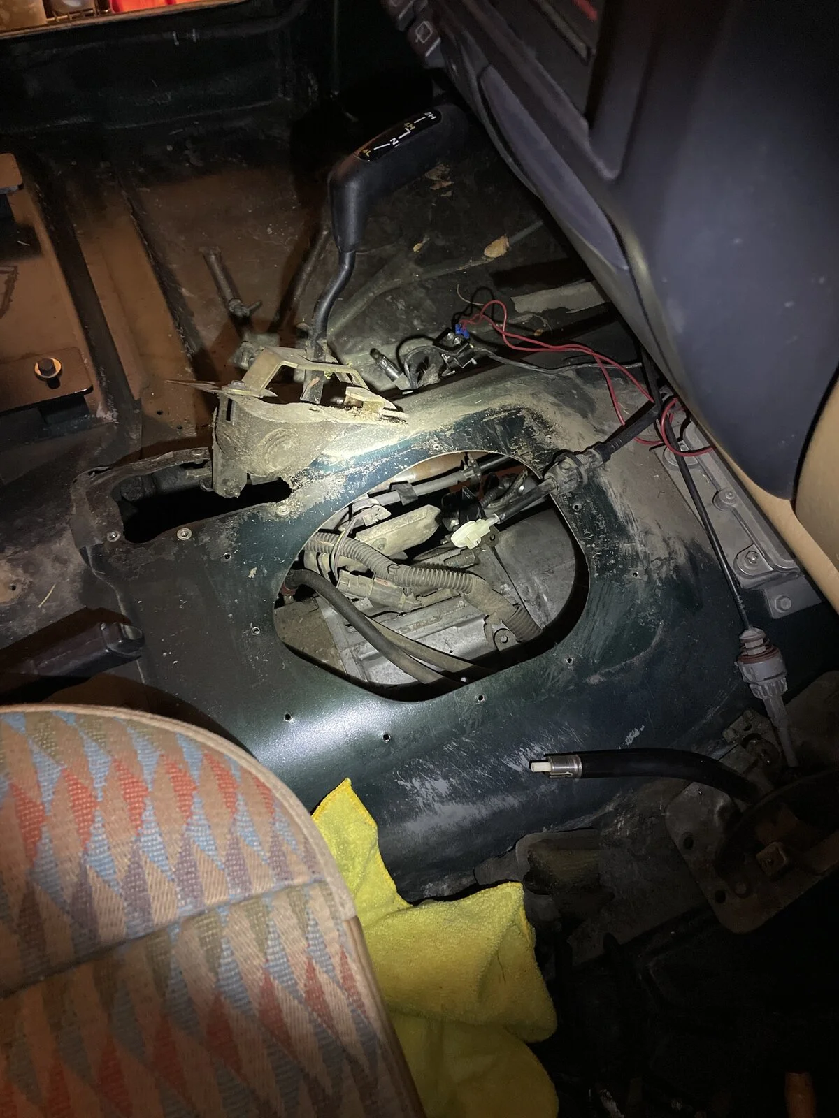

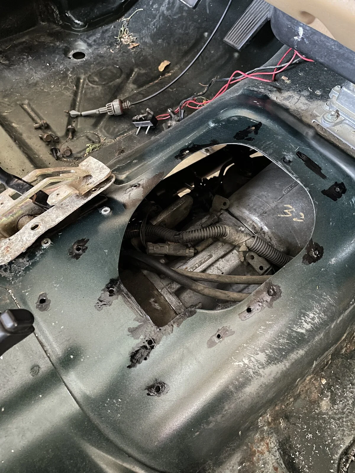

I will say, a couple other things that help with the install...1) need to drop the from driveshaft 2) need to drop the transmission cross member, or in my case, I have the poison spyder belly pan with built in transmission support. That thing weighs a ton! I=
I do like the shifter...very very solid!
