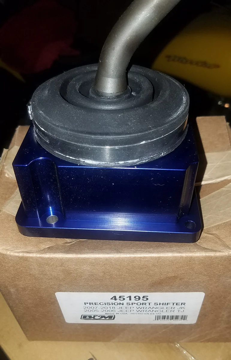

Definitely shortens shifter throw to about 4" from 1st to 2nd. Less slop. I would install it again.
The only thing that I've noticed (not a problem with the shifter itself) is going into first or second. Where there "was" a notchy point with the OEM shifter going into those gears, is now the actual limit of the shift throw. I keep trying to shift further past, like I'm still using the OEM unit. I have to re-train myself and my muscle memory for the new shifter.
