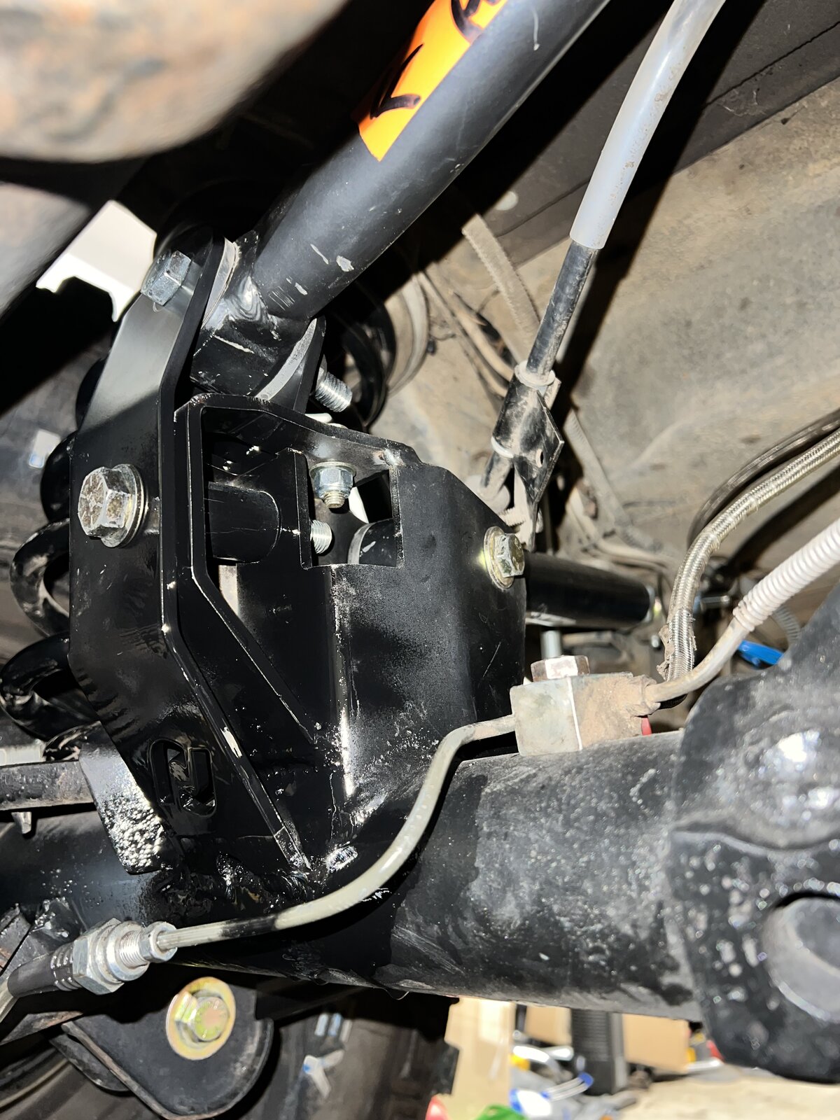

Pulled the rear axle and did a little surgery to get new control arm/track bar brackets from Barnes 4x4 welded up. I briefly considered outboarding, since it was out anyway...but I see tons and coils in the (somewhat near) future.

Got MCE fenders on, had to do a little trimming, I might scallop the edges some, since it looks a little "square."
Got the new track bar/CA mount all fitted up, too (ignore the fresh and shitty rattle can).
