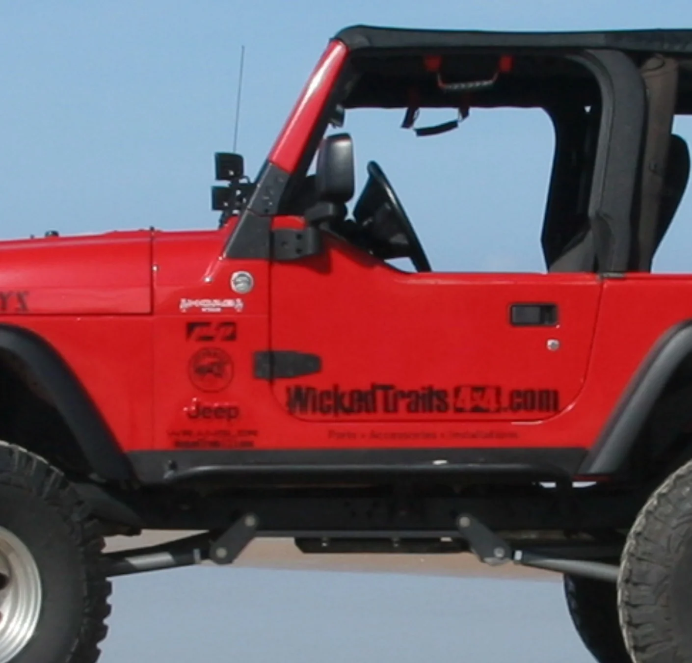

On a long arm the ride quality is superb. You can see the arm angle is a lot less than the shirt arm. The more the arms are closer to being parallel to the frame the better. Also from my personal experience I get much better results crawling on rock's with my long arm than I had with a short arm.
It seems like you may damage the arms while crawling more easily though??
Yes there is that possibility just like damaging the front driveshaft is it is usually running a very similar angle. When they are built well they will take a beating and keep on going. I have plenty of scars on mine but they are still going strong. Some lifts like the RE have straight arms while others have a bend in them keeping them higher and bend down closer to the axle.
When they are well built they are strong and can handle what you dish out.
Reactions: NicKnack
Here is a pic of my arms and you can see the front driveshaft angle a bit steeper then my arms
