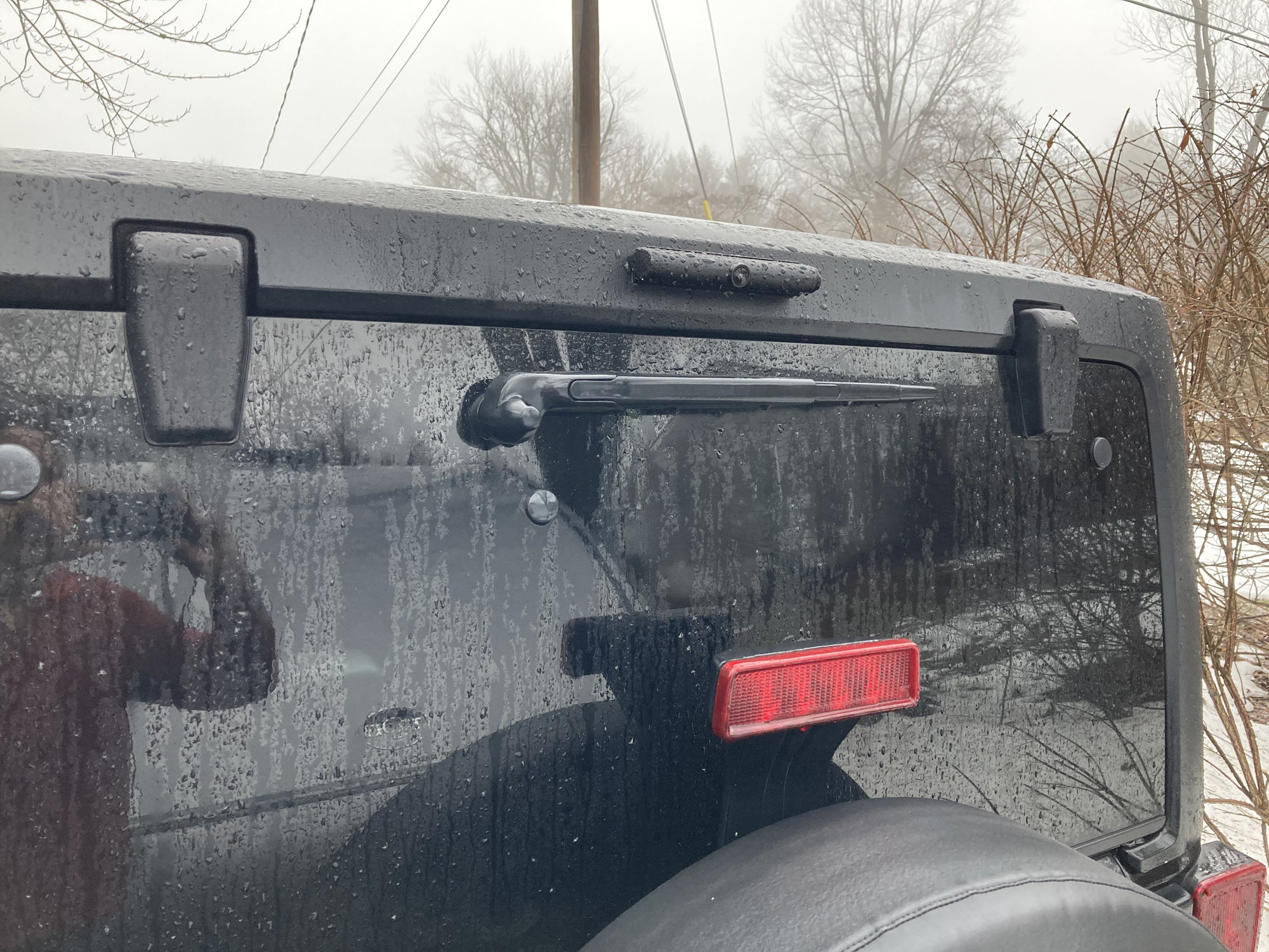

A lot of the JK/JL community choose to mount their backup cameras along the upper edge of the hard-top.
Which in my mind makes the most sense, and where I plan to mount mine as well.
(protected from breaking, mounted high for a better view, and simple to run wiring along the interior)

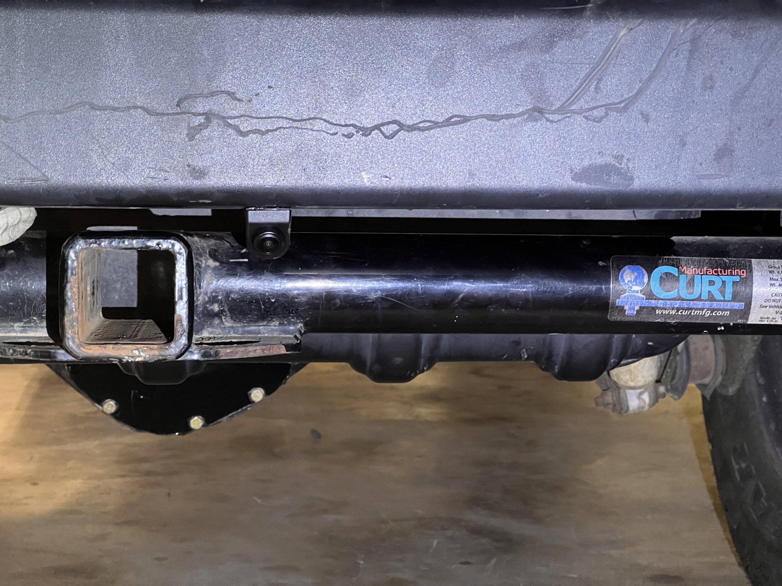

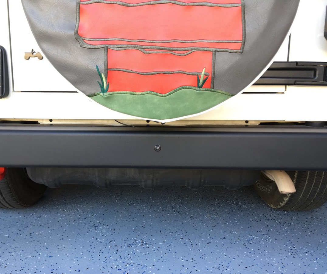

Mounted mine on the bumper. It works well I’m hoping the hitch provides some protection. But if it gets damaged it was only $30 something and I can replace it quickly.

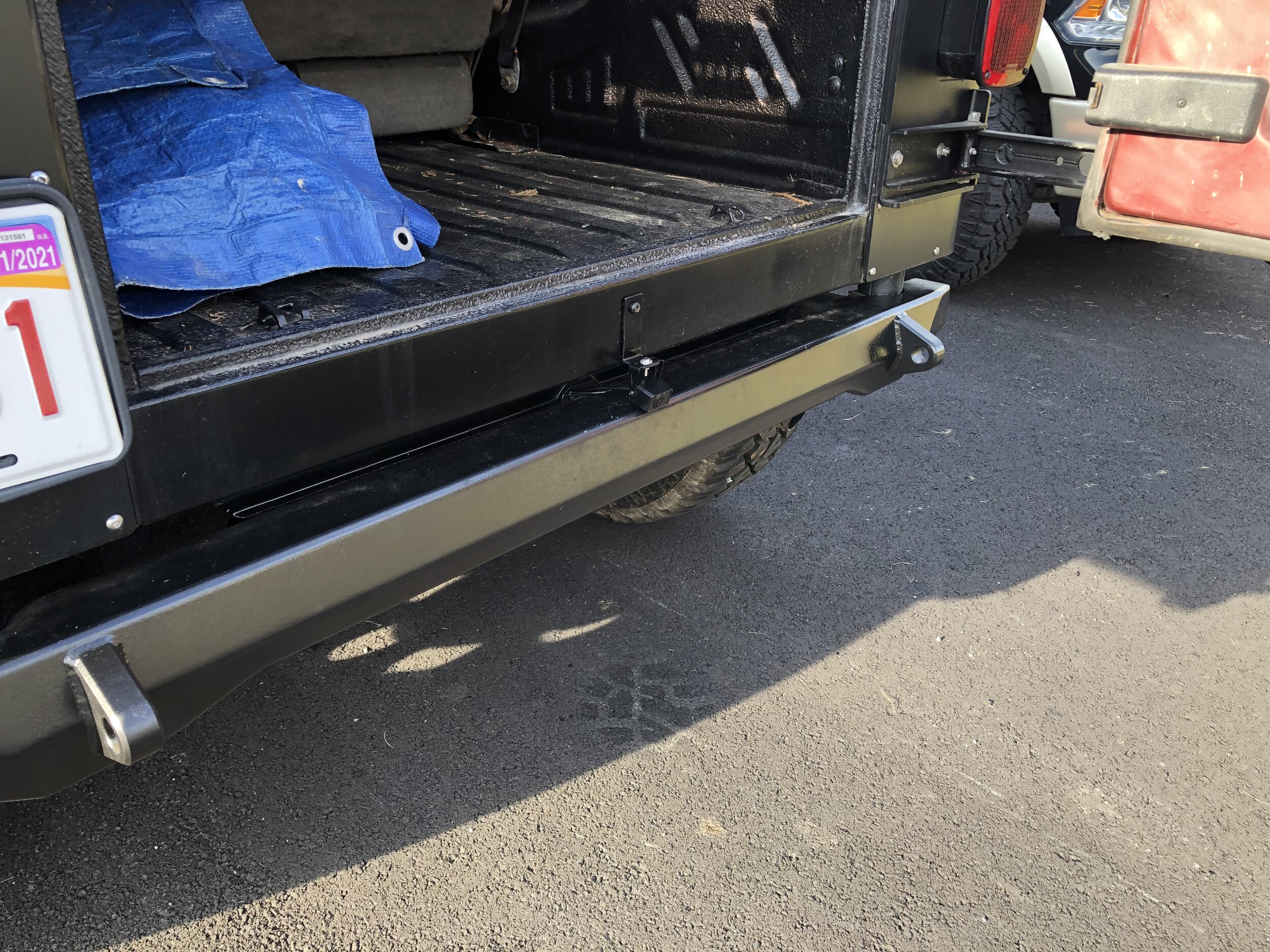

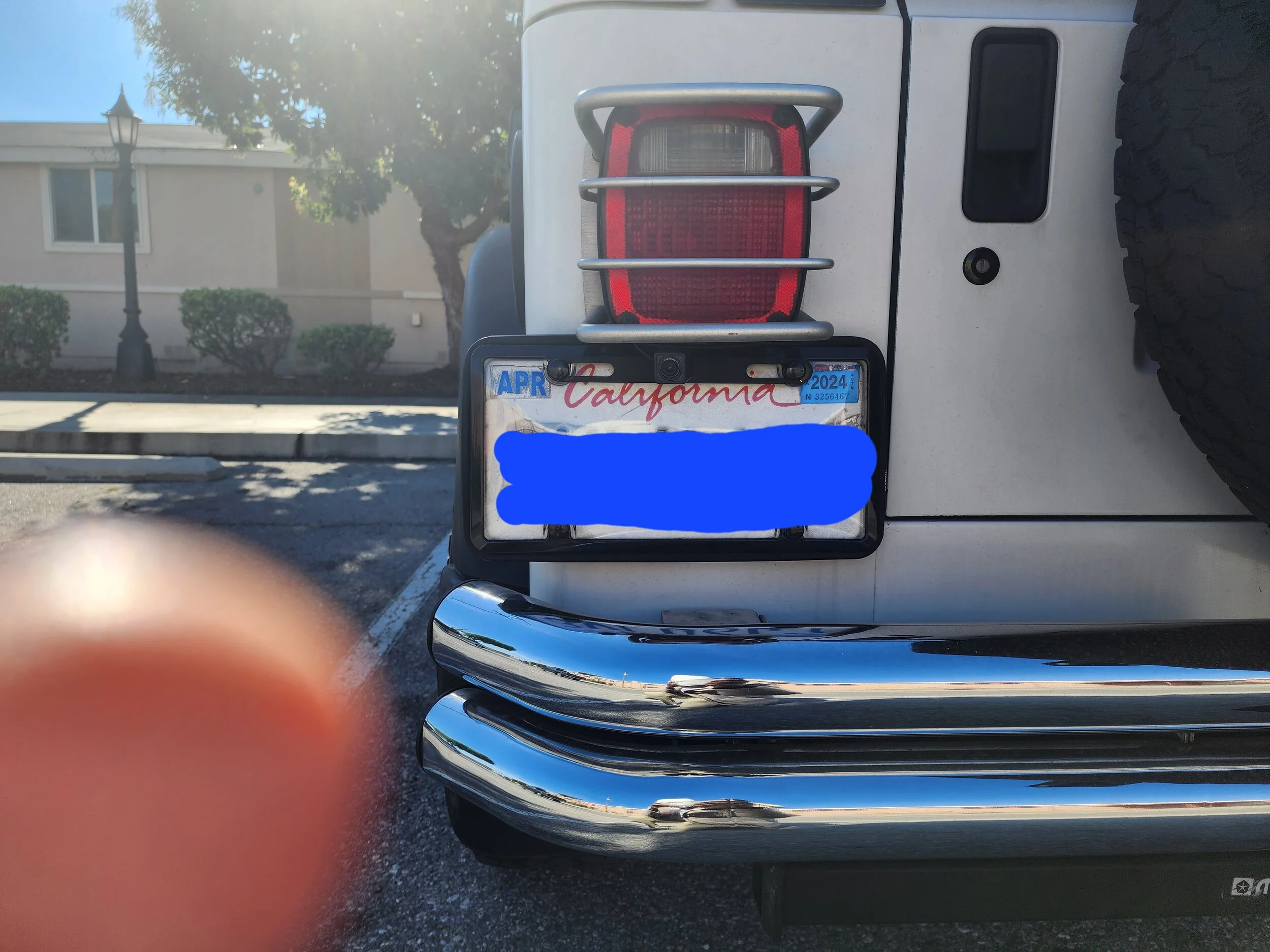

Bracket above the License plate on the two frame bolts. It didn't matter if it was centered on mine. You just focus it a little bit to the other side. Inconspicuous and out of sight.

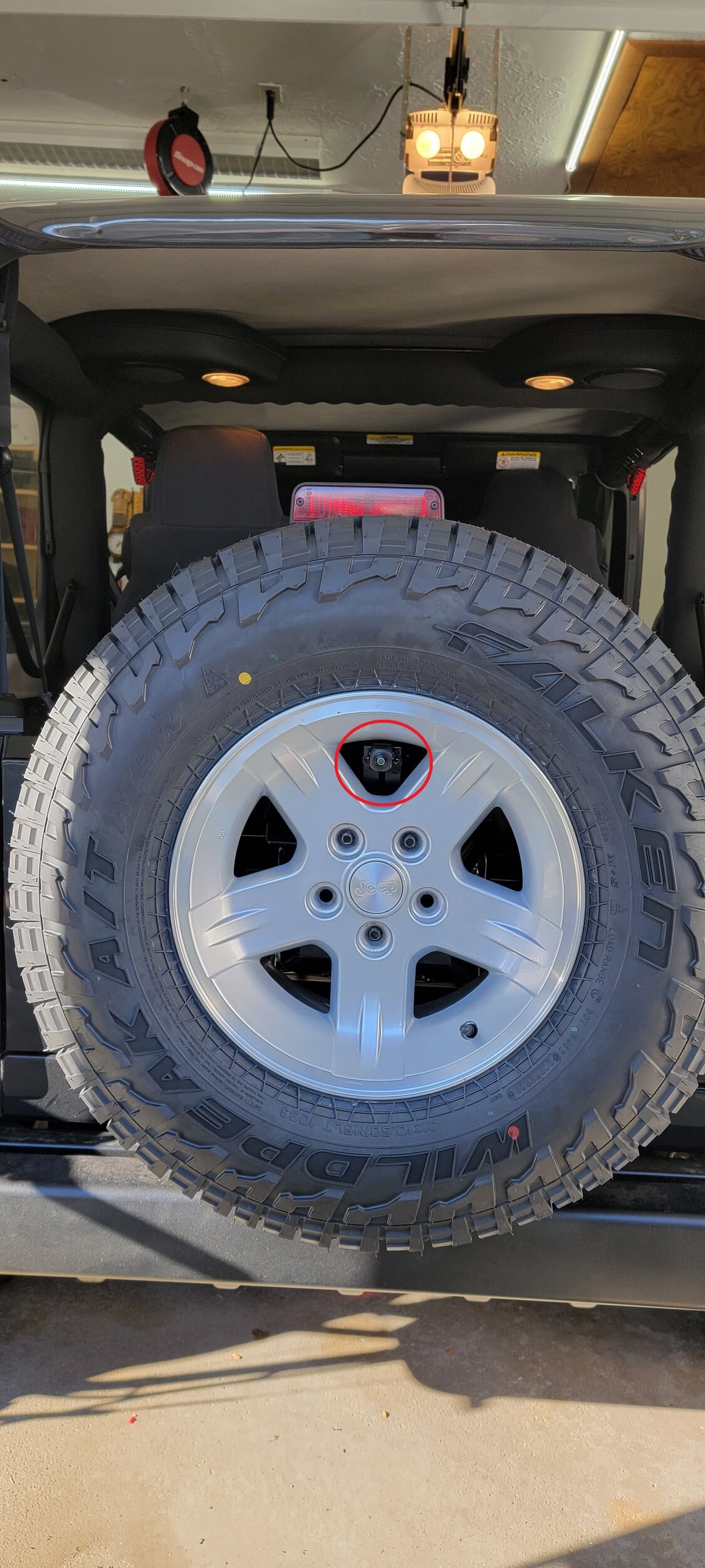

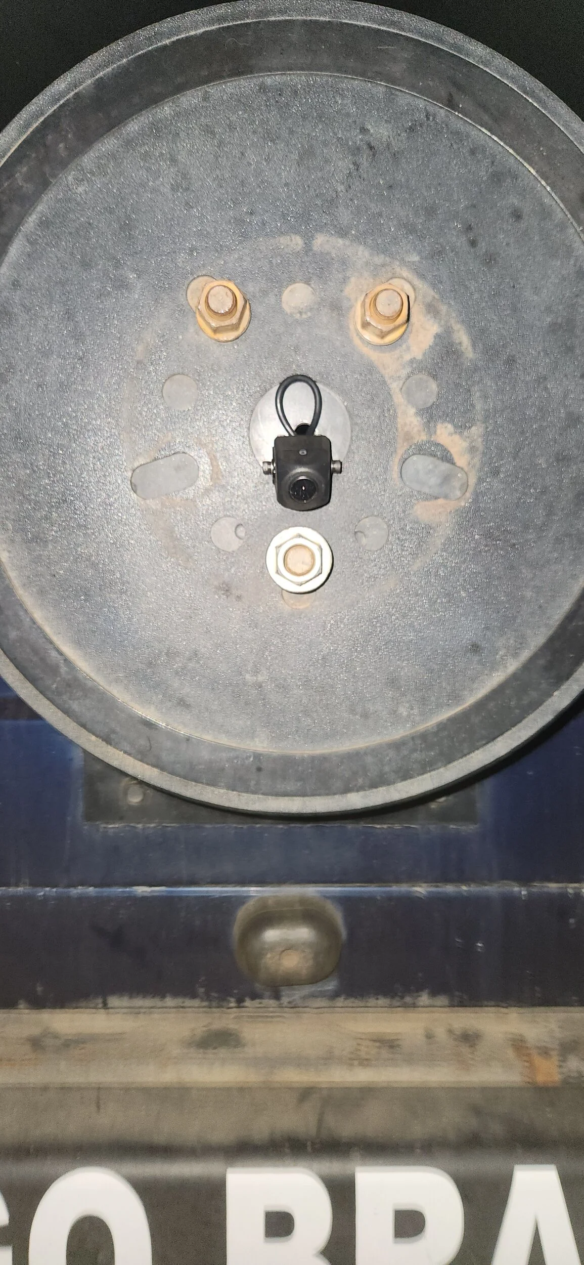

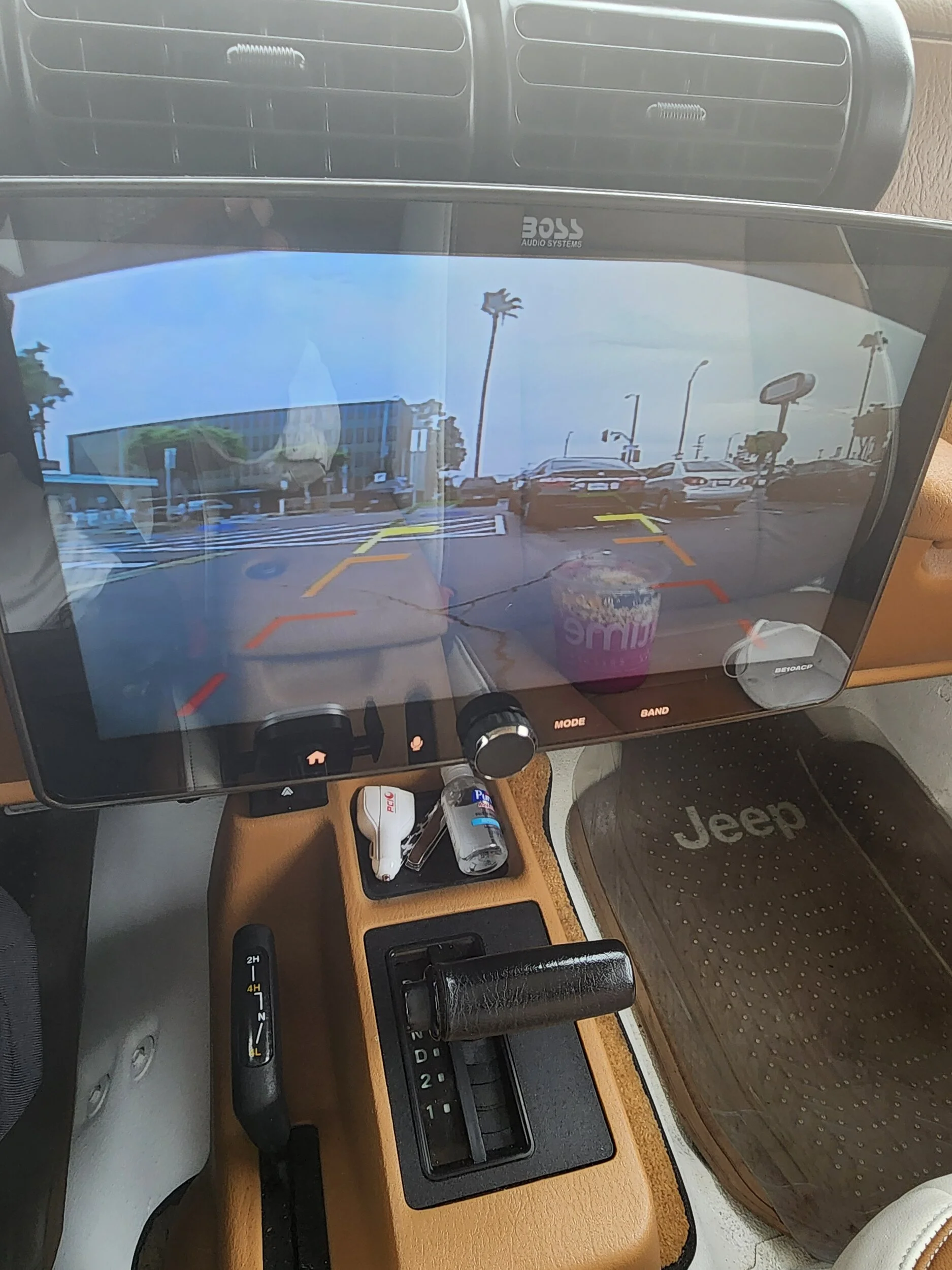

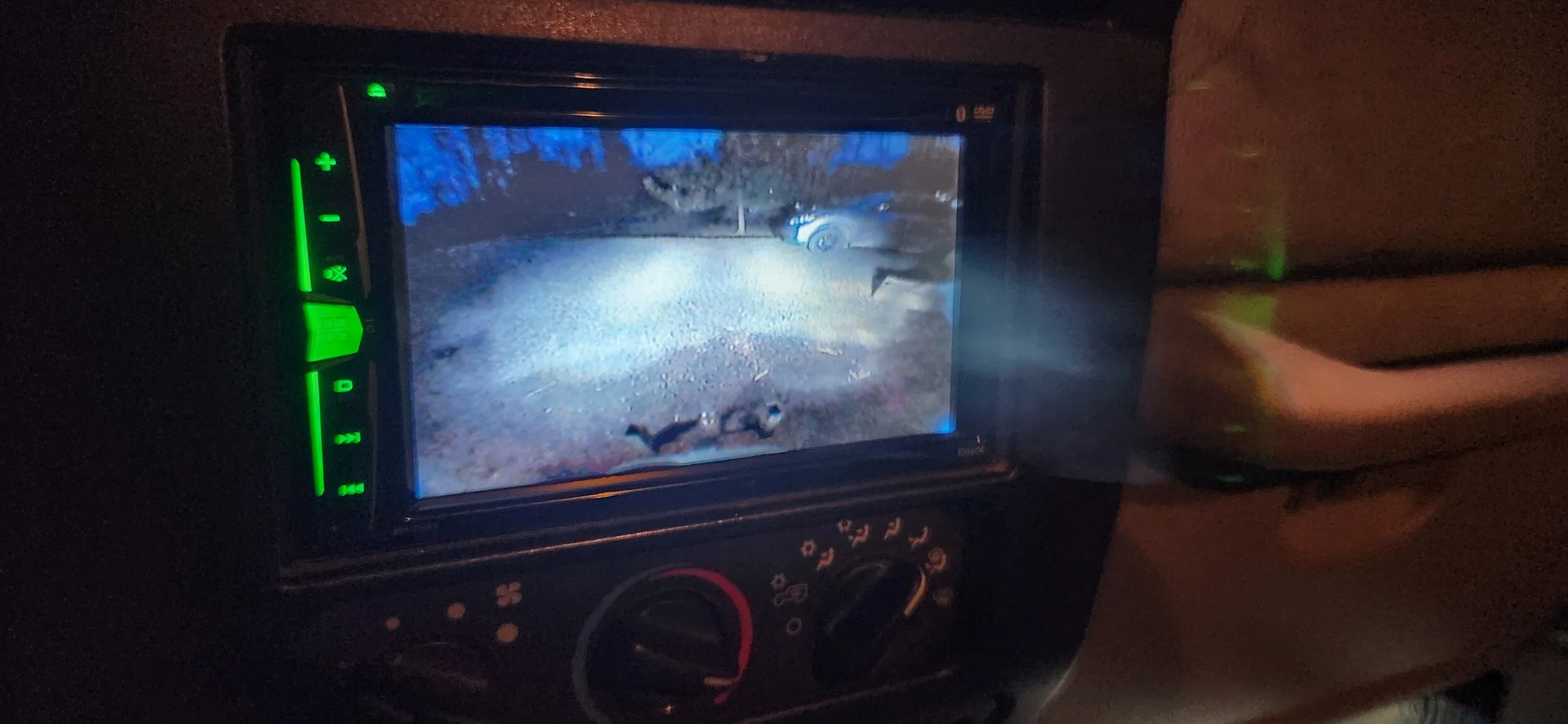

So I mounted it in the middle of the spare ... thats not on the jeep.. I have it just no tire .. long story kinda, here's the camera and the view. Thanks for the input

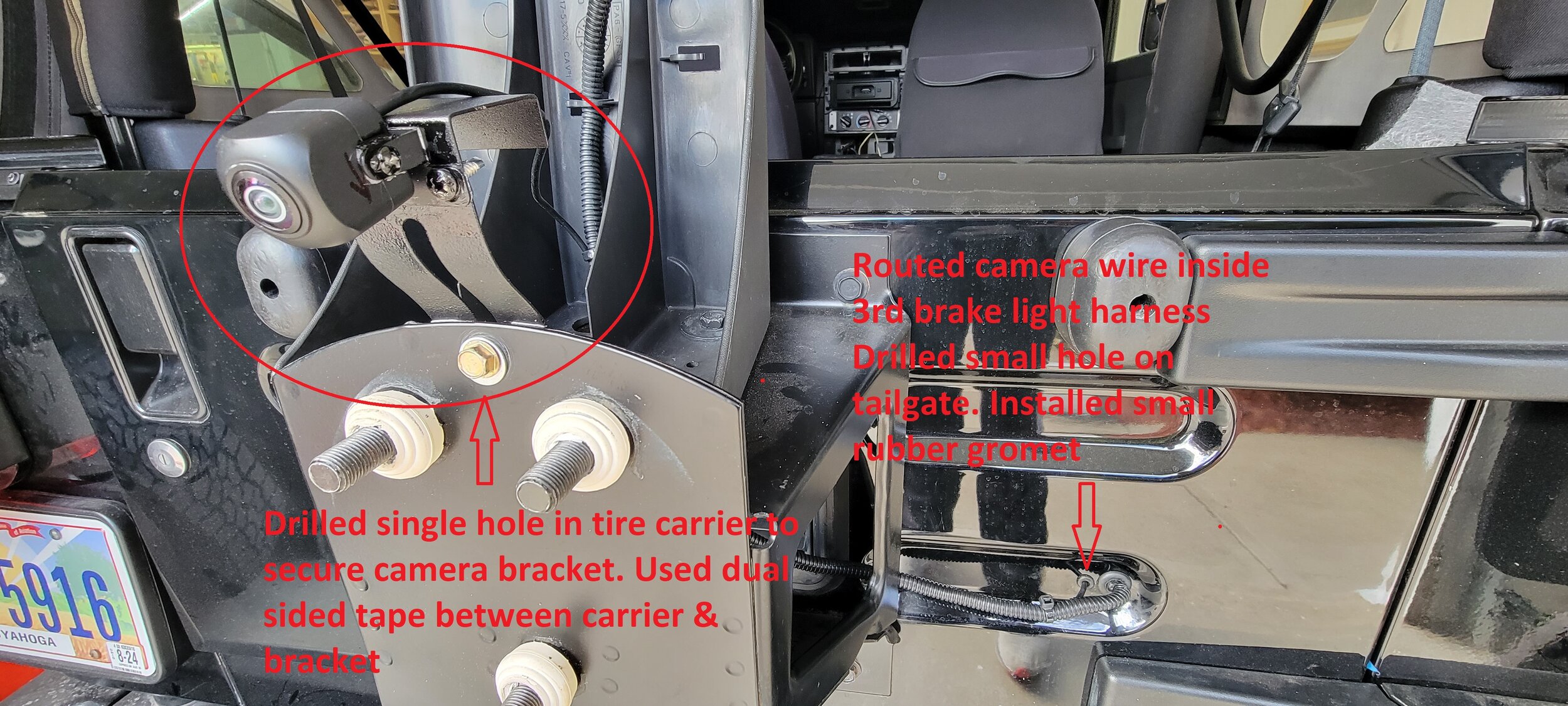

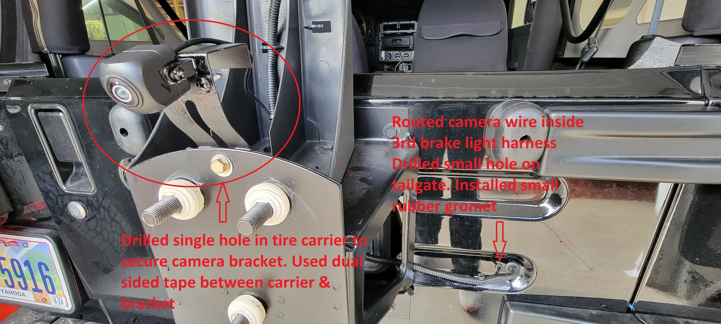

I plan to mount a backup camera, and I'd really like to find a way to mod the JL mount (center of spare) so it fits a TJ... mainly so that I have the option of adding a spare tire cover without interfering with the camera. Has anyone done that? Maybe I can scrounge up a mount at a pick-and-pull and figure something out.
I see @8rent made a bracket like what I'm looking for, shown in his video at 7:20-ish. I really need to get my printer back up & running so I can fabricate this sort of stuff.
