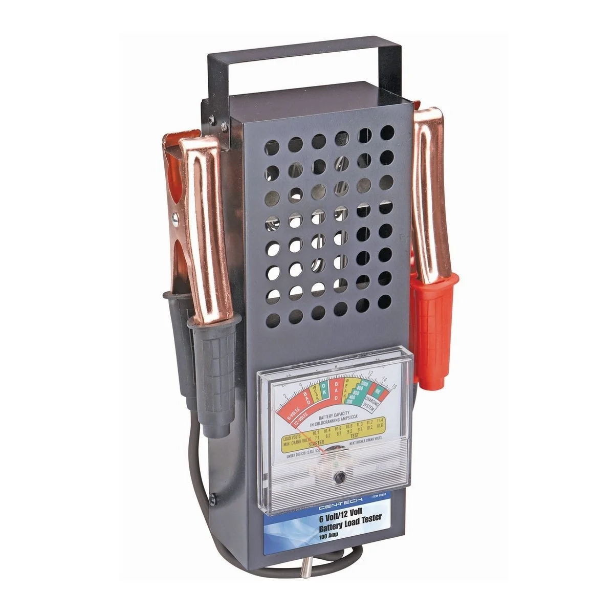

Disconnect, clean terminals, make sure battery has distilled water in cells (if a serviceable battery), hook up to a bench charger and charge overnight. After the battery is fully charged let it sit 24 hours and then load test it.
I use an old fashioned "cheese grater style" load tester, like this one available from Harbor Freight:

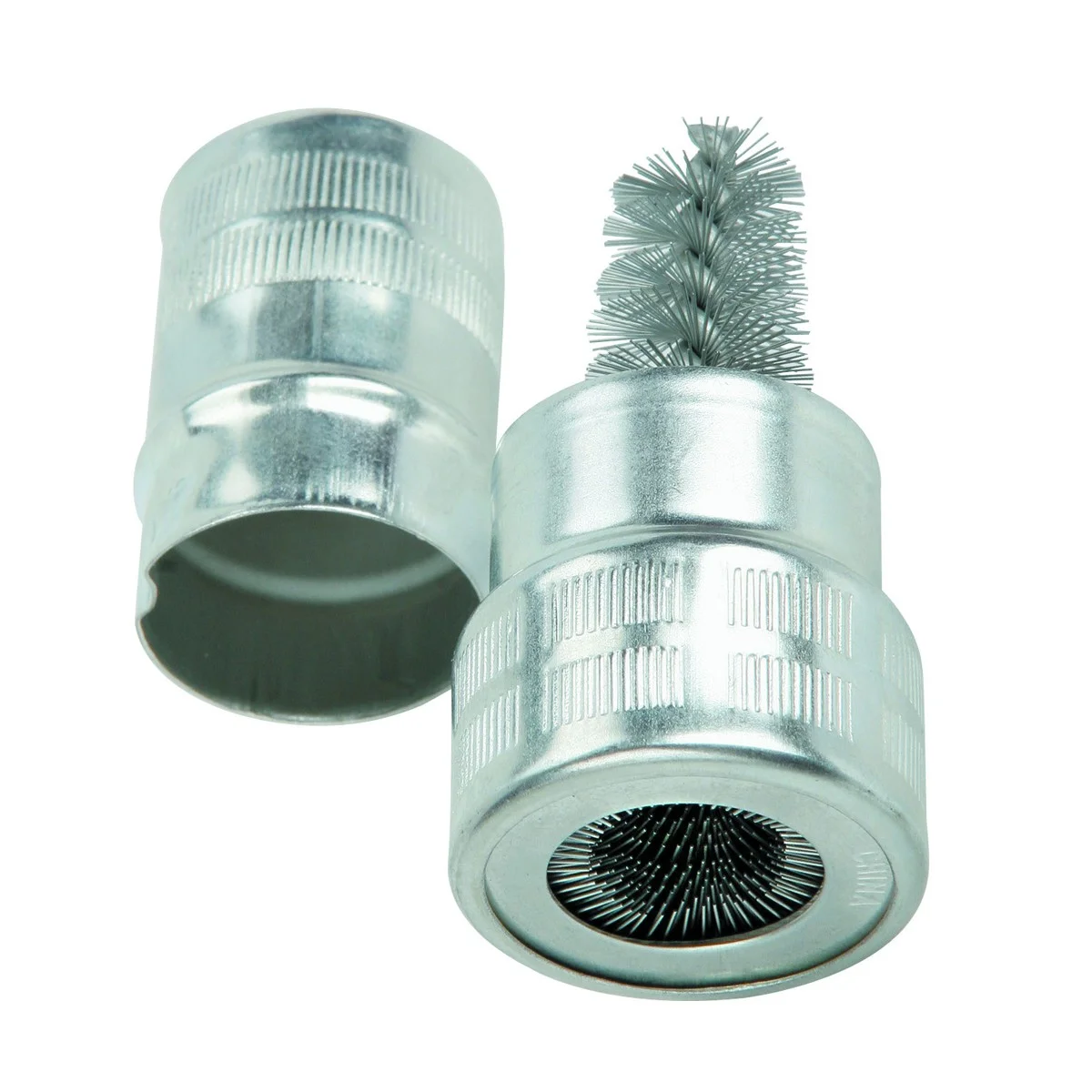

If you buy one, buy one of these while you are there:
Sometimes a bad cell makes things go haywire also. Let us know what you figure out.
