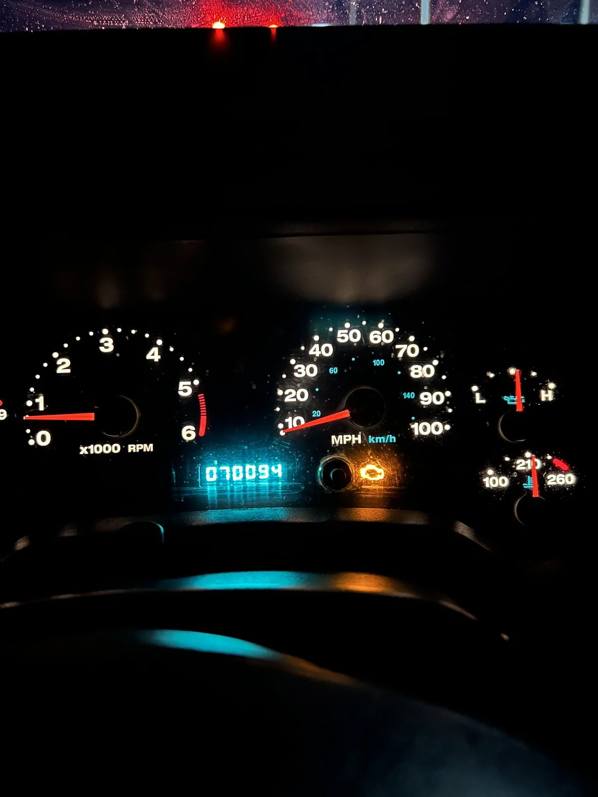

I have never been happier to see this light come on. Immediately plugged in my code reader and a bad 02 Sensor was the culprit. I had a feeling that was it but a code was thrown. I didn’t want to overreact. The 3 month bad MPG mystery is solved.
