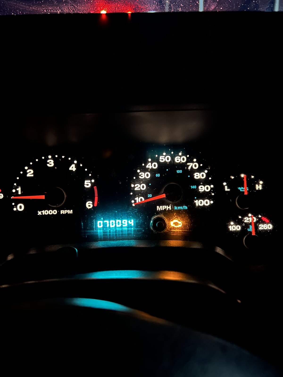

I have never been happier to see this light come on. Immediately plugged in my code reader and a bad 02 Sensor was the culprit. I had a feeling that was it but a code was thrown. I didn’t want to overreact. The 3 month bad MPG mystery is solved.
I glad you got a CEL to lead you in the proper direction. Does Nevada use a summer blend of fuel? Some of these blends can reduce mileage.
