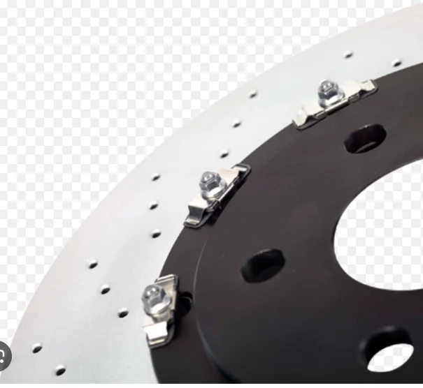

If that were even remotely true, every time it rains in SoCal every single mechanic shop would have lines of cars to get rotors replaced. There isn't. The other way you know that isn't remotely accurate is due to the non-existence of floating rotor hats on OEM vehicles. The race world uses a rotor hat with a rim that has holes for bolts and some easy misalignment mechanism that allows the rotor to run slightly out of perpindicular to the bearing axis when high loads in turns tilt the hubs on the bearings. The rotor bolts to the hat typically with a spring mechanism of some sort.

That is exceptionally rare and you have listed two entirely different methods of damaging a rotor, one is nearly impossible, the other was addressed above.
