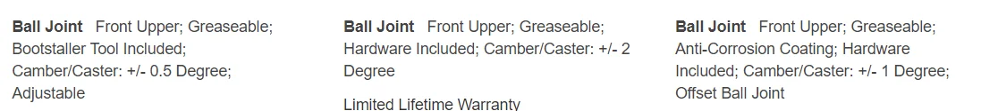

I understand what you are saying however when I am looking at ball joints, there are so many options. I want to make sure I get the correct ones. Below is an example of what I am seeing.
Yes, I just looked on Rockauto and there are many to choose from.
I assumed stock was non-adjustable. :unsure:
Maybe someone else (with a '97) can help.
