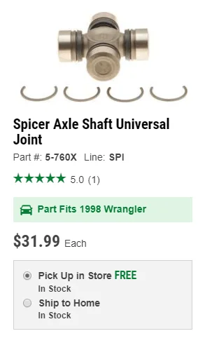

For u-joints, also stick with Spicer. Spicer 5-760x for the front axle shafts, Spicer 5-1310x for the driveshafts for all Wrangler TJ models except for the Rubicon which requires different driveshaft u-joints.

Awesome. And they have them in stock too.
