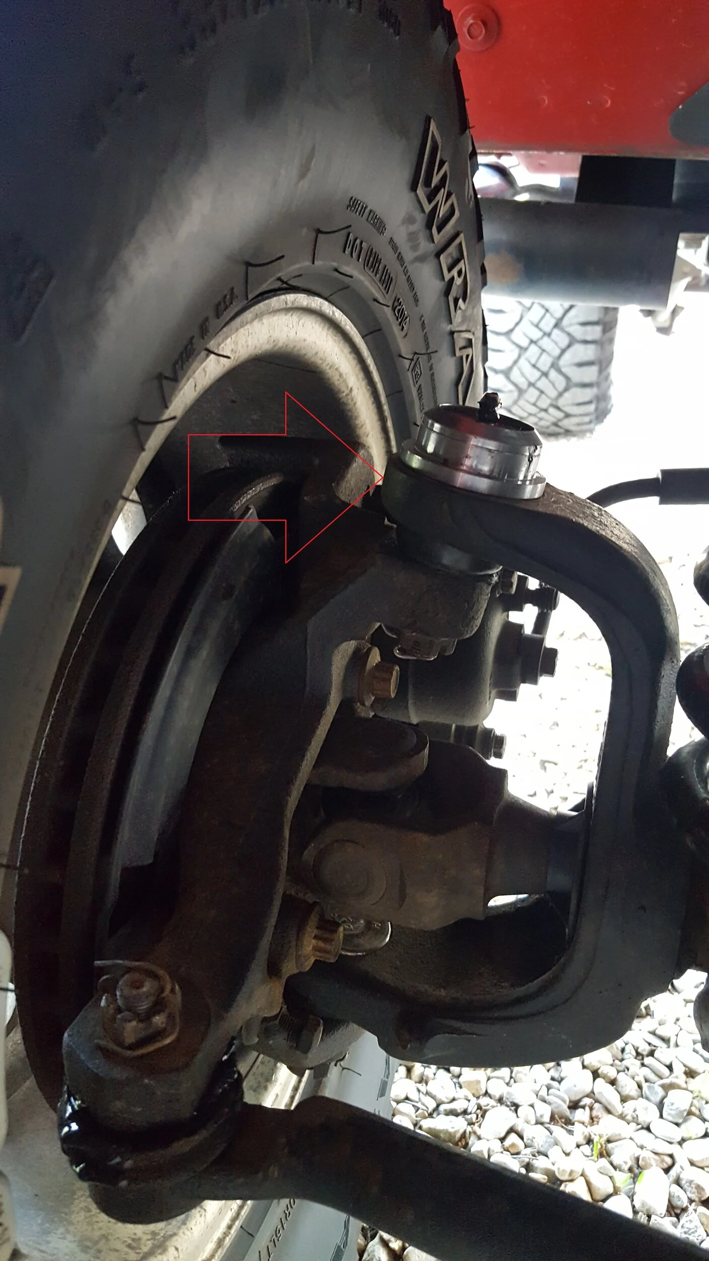

What do you mean by this?
The press gets torqued to remove the old ball joints from the inner C. Whacking the end of the C on the axle (where the lower and upper ball joints are located) relieves that pressure the ball joints are seeing and the press doesn't need as much torque to remove the ball joints.
