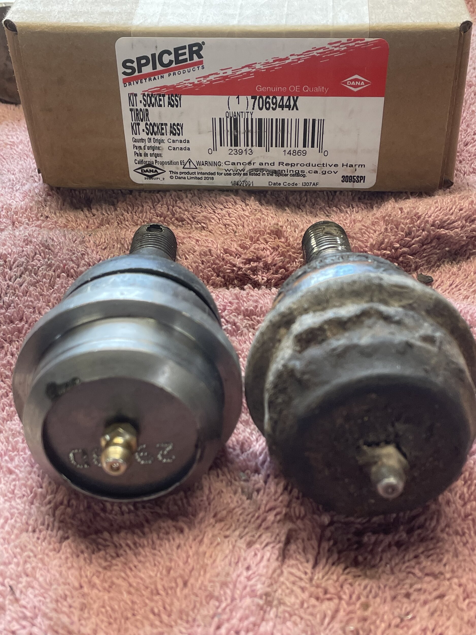

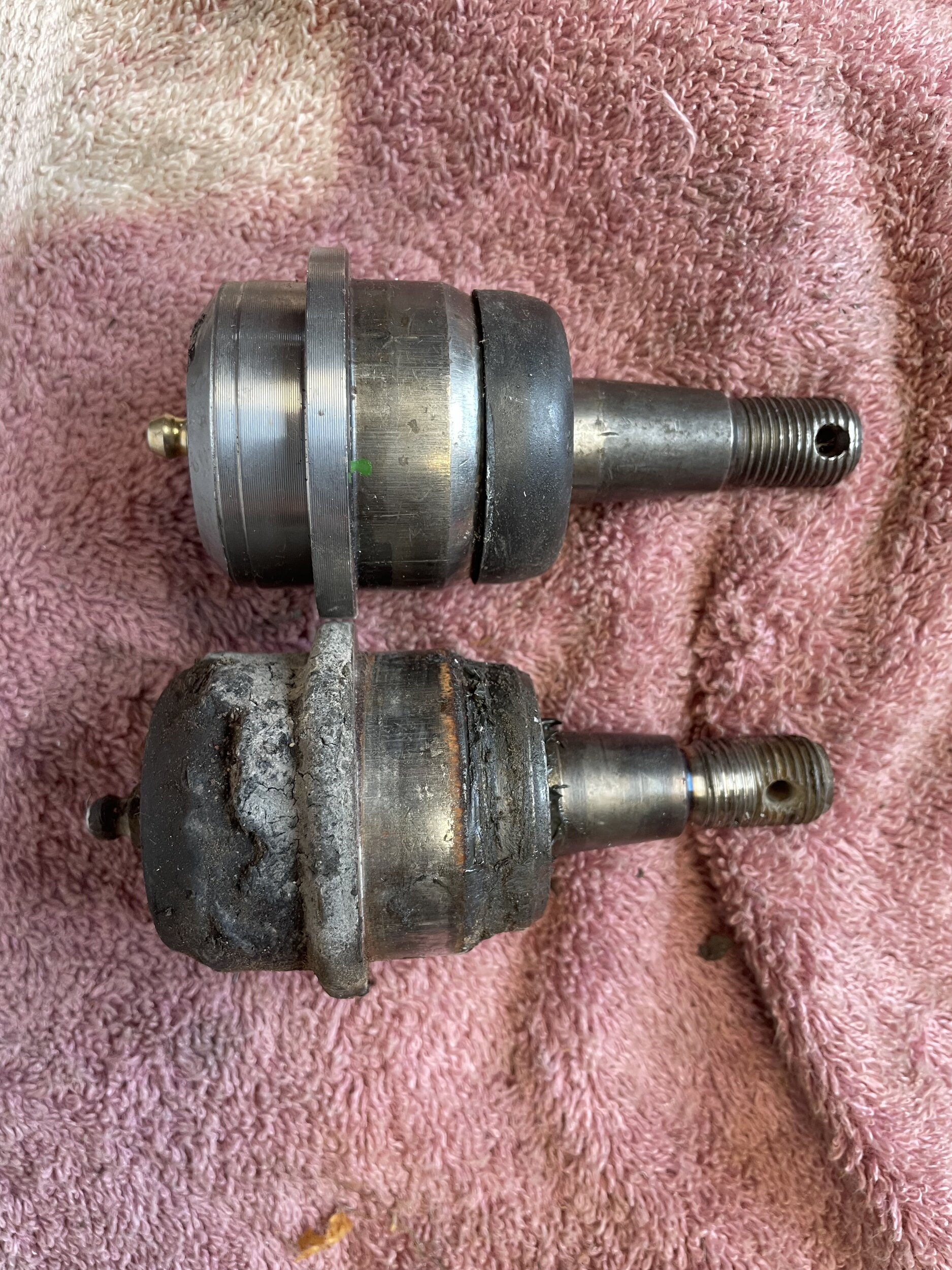

So, I got the proper spicer ball joints, upper and lower, and as you can see from photo, the new ones have a longer shank. The longer threads don’t concern me, but where the solid shank starts is closer to the joint on the oem ones.
Has anyone found this to be the case, too and it’s not a problem or should I send them back and get different ones?
Basically I don’t want to press them in just to find out they are the incorrect part and have to press both upper and lower back out.
Thoughts?
Thoughts?
Are you sure the old one doesn't appear shorter because it's shot/worn out? Just a guess...

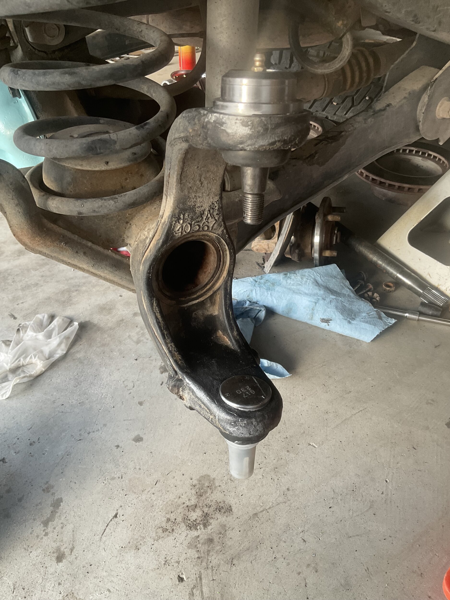

Excellent advice and much appreciated. Even without the jeep angled press adapter being sent with an amazon order, I pressed them all in with no issues. Frankly it was far easier than I anticipated. Getting the old ones out was far more of an issue. Now onto the tie rod upgrade. Appreciate the support of this group.
