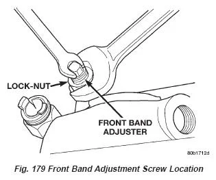

From the FSM:
FRONT BAND ADJUSTMENT
The front (kickdown) band adjusting screw is
located on the left side of the transmission case
above the manual valve and throttle valvelevers.
(1) Raise vehicle.
(2) Loosen band adjusting screw locknut (Fig. 179).
Then back locknut off 3-5 turns. Be sure adjusting
screw turns freely in case. Apply lubricantto screw
threads if necessary.
(3) Tighten band adjusting screw to 8 N·m (72 in.
lbs.) torque with Inch Pound Torque Wrench
C-3380-A, a 3-in. extension and 5/16 socket.
(4) Back off front band adjusting screw 2-1/2 turns
for the 30RHand 2-1/4 turns for the 32RH.
(5) Hold adjuster screw in position and tighten
locknut to 41 N·m (30 ft. lbs.) torque.
(6) Lower vehicle.

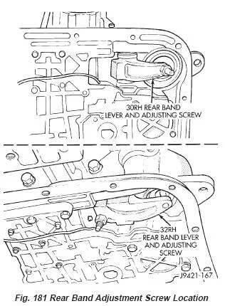

REAR BAND ADJUSTMENT
The transmission oilpan must be removed for
access to the rear band adjusting screw.
(1) Raise vehicle.
(2) Remove transmission oilpan and drain fluid.
(3) Loosen band adjusting screw locknut 5-6 turns.
Be sure adjusting screw turns freely in lever.
(4) Tighten adjusting screw to 5 N·m (41 in. lbs.)
for the 30RHand 8 N·m (72 in. lbs.) torque for the
32RH (Fig. 181).
(5) Back off adjusting screw 7turns for the 30RH
and 4 turns for the 32RH.
(6) Hold adjusting screw in place and tighten locknut
to 34 N·m (25 ft. lbs.) torque.
(7) Position new gasket on oil pan and install pan
on transmission. Tighten pan bolts to 17 N·m (13 ft.
lbs.) torque.
(8) Lower vehicle and refill transmission with
Mopart ATF Plus 3, Type 7176, fluid.
(1) Raise vehicle.
(6) Lower vehicle.
(1) Raise vehicle.
32RH (Fig. 181).
lbs.) torque.
