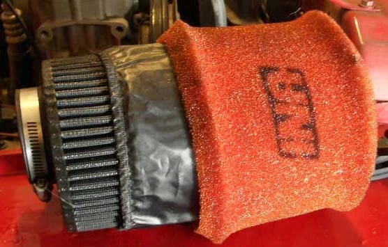

A CAI won't help performance. My second TJ I bought used came with one, I replaced it with the OE air intake system within the first couple weeks after buying it. And if it included an air filter like the K&N, place a couple pre-filters over the top of it. K&N air filters and their imitators don't filter the air well enough, they easily pass fine dust, silicates, etc. which would be in great abundance in places where offroading takes place.
I made the mistake of installing a K&N something like 15 years ago before I learned just what a shitty filter they really are. A friend showed me how filthy my air intake system was, it was grimy with grit.
This is that K&N, I had to install two prefilters over the top of it before I could get the air intake system to start remaining clean. They're pulled back so you can see the layers it took to keep the engine clean. Never again.

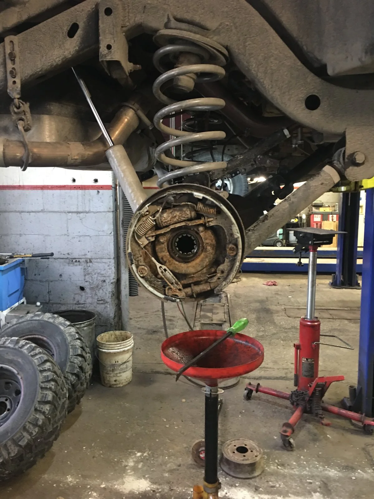

Axle bearings and wheel lug studs lol. I nees an adjustable rear track bar. Any recommendations?
I run a Currie rear track bar. It's a bit pricey, but like everything Currie makes, it's probably the best you can buy.
