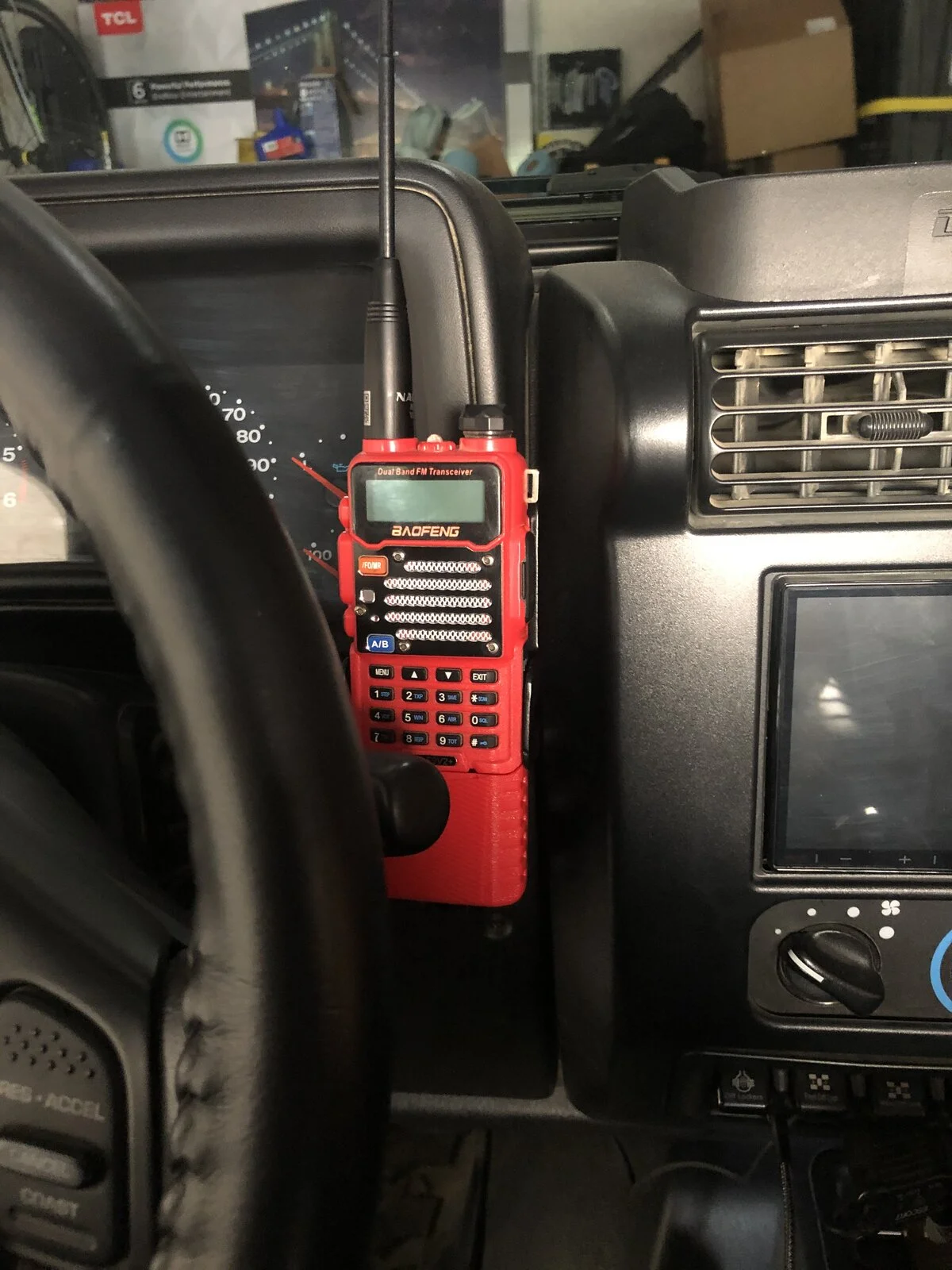

A lot of the guys I jeep with use those over-priced, potentially illegal Rugged Radios hand held's. No way I would pay what they charge, so I got a Baofeng and programed all the Rugged channels. I wanted a good mount that fit in the TJ so I ended up piecing together some RAM mount 1" hardware and found a nice little radio holder on Ebay.

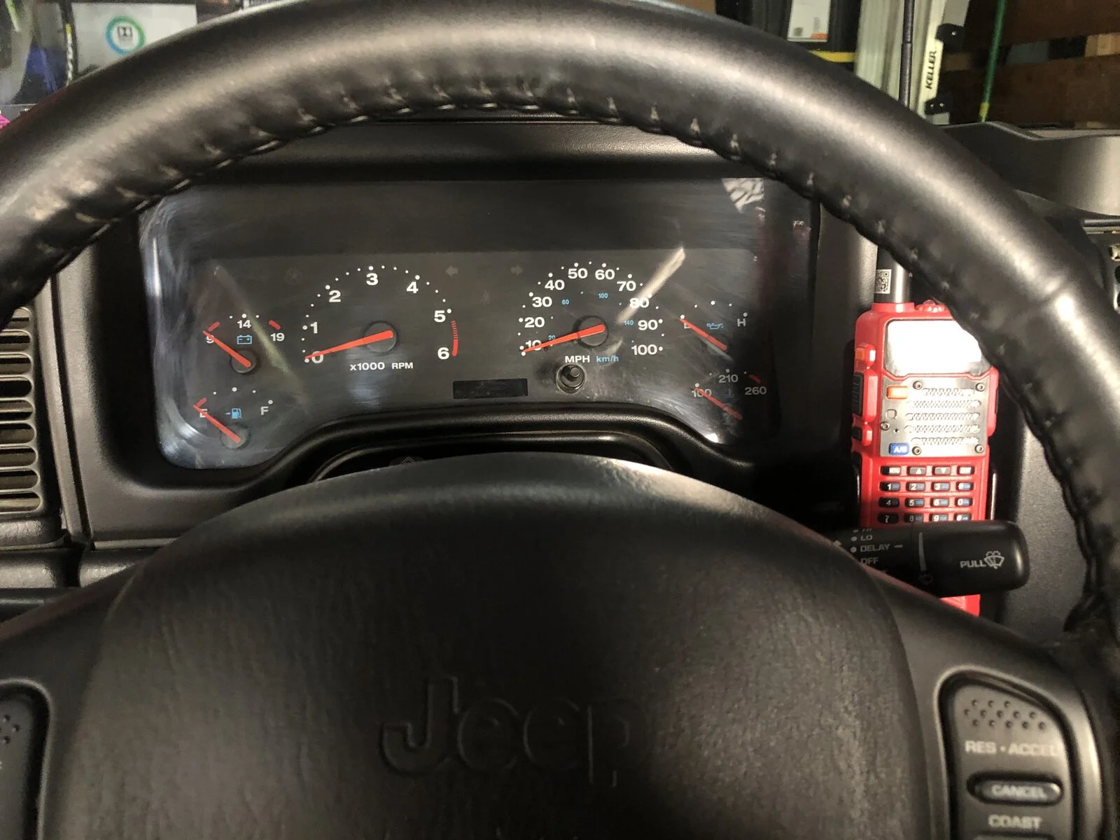

I would say it turned out great. Puts it out of the way of the ignition key, even with the extended battery. Doesn't block the gauges and its easy to grab if I need to hop out of the jeep. I used some 10-24 bolts to attach the RAM base to the knee bolster.

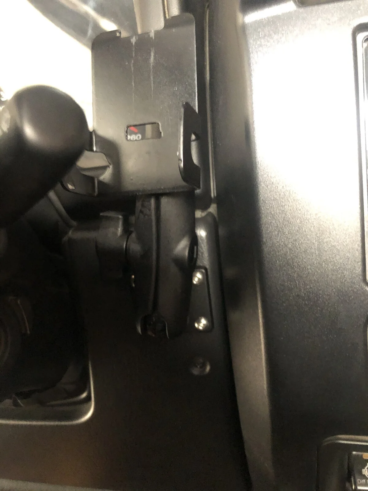

Just to confirm... you did have to drill in the knee dash?

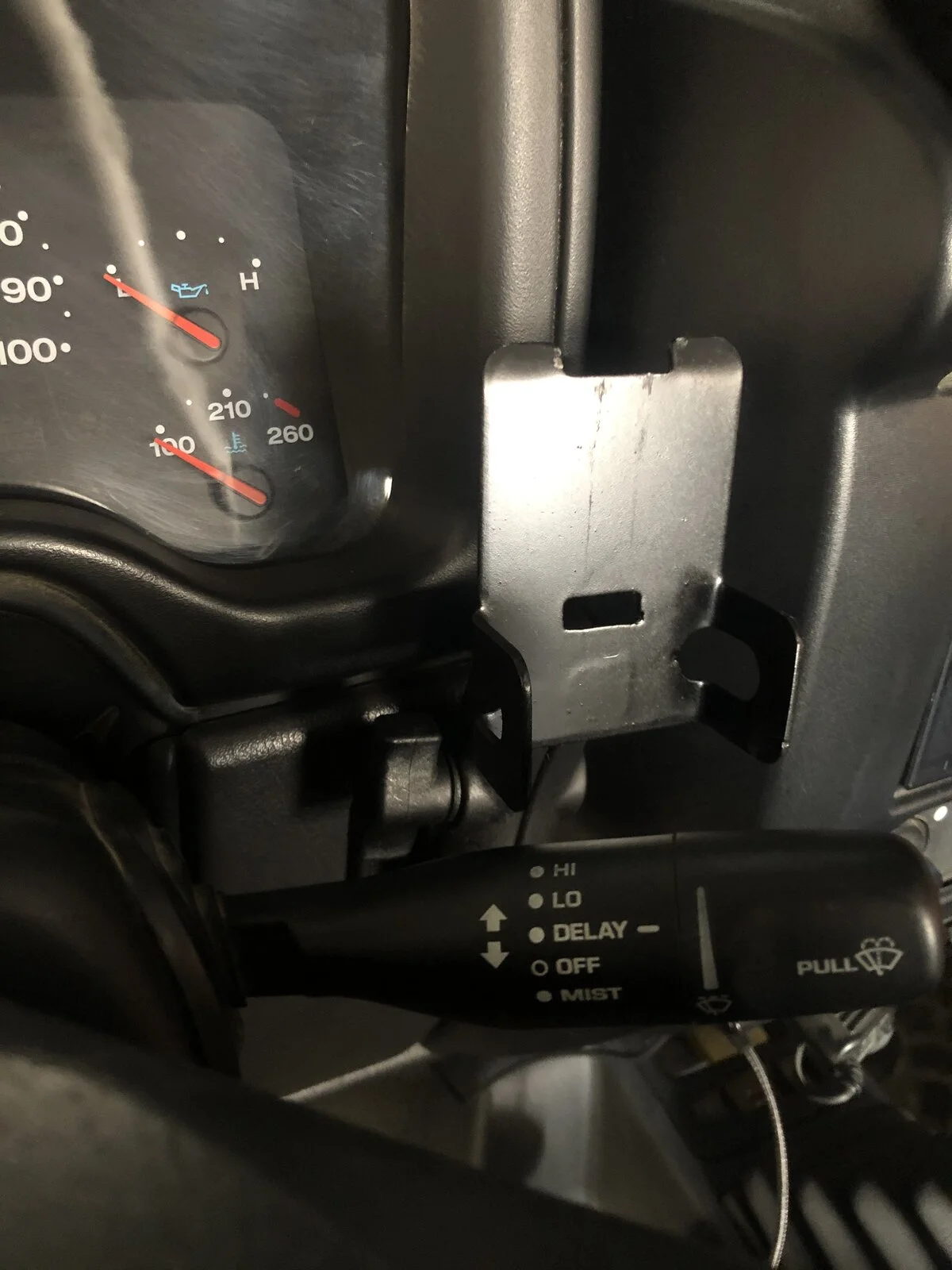

Whats it look like without the radio.. when not in use?
I drilled 4 small holes to mount the RAM AMPs base to the knee bolster.

Here are the photos without the radio.

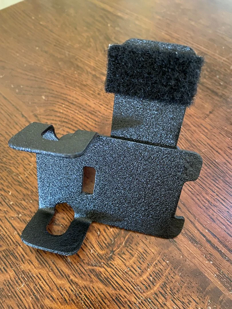

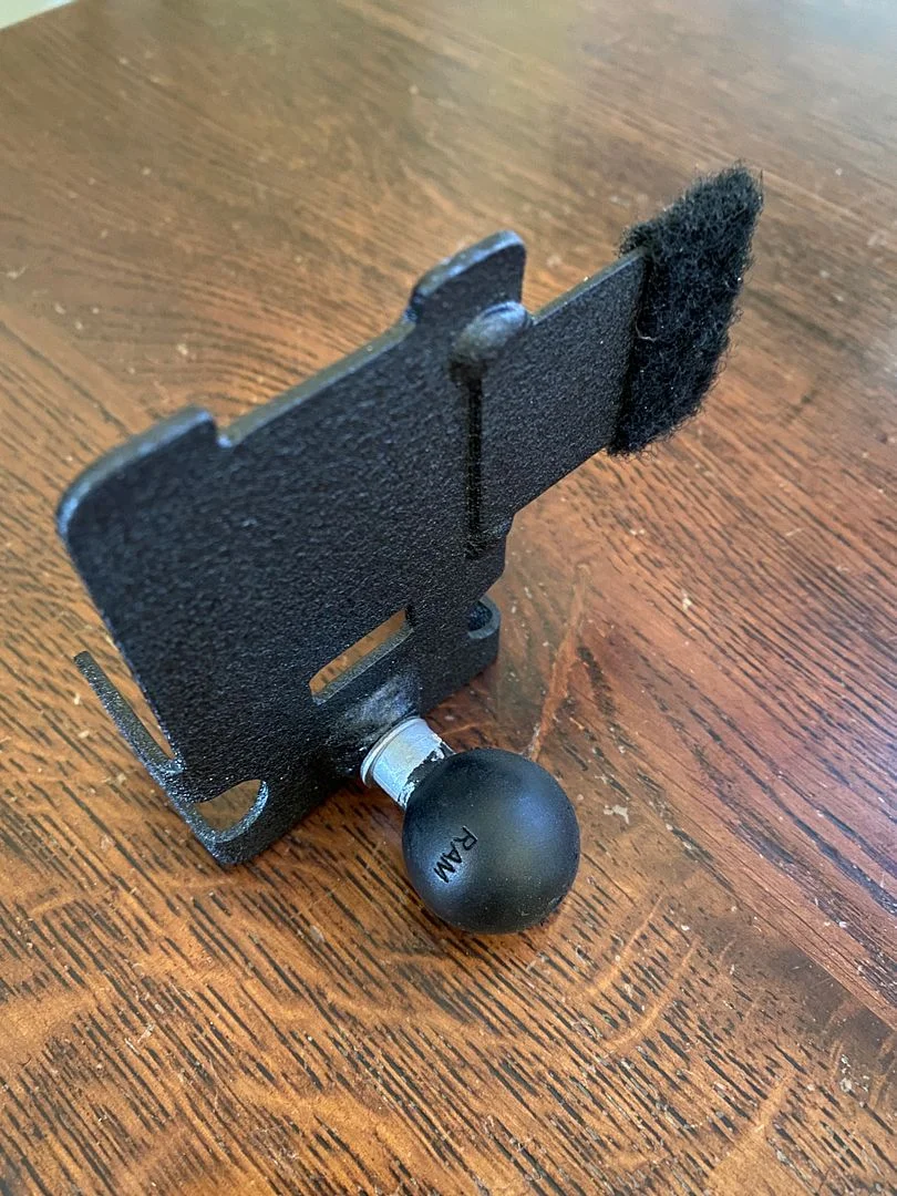

Looks like I bought the same mount. I have four of them that I added a little side tab and a ram ball too then wrinkle powder coated them. The side tab has a wrap of velcro to hold a speaker mic. the tab can work in three ways, either a magnet, velcro or clipped over the tab. The ram ball and mount combo really hold great.
Reactions: j8ksdad
