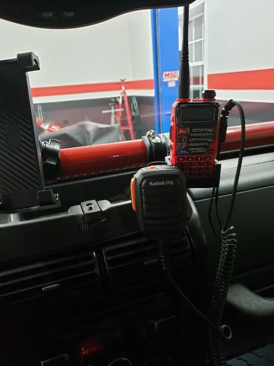

I run the microphone cord up over the radio, and drape it to the left of the mount arm that I use. Haven’t had a problem since doing that. I use the Radiodity mic but it’s the same design with the same problem.
My big problem with the UV5r is being able to hear over the sound of my Jeep. Whether using the radio or the speaker mic as sound output, I just can’t understand what other people are saying if I’m not idling.

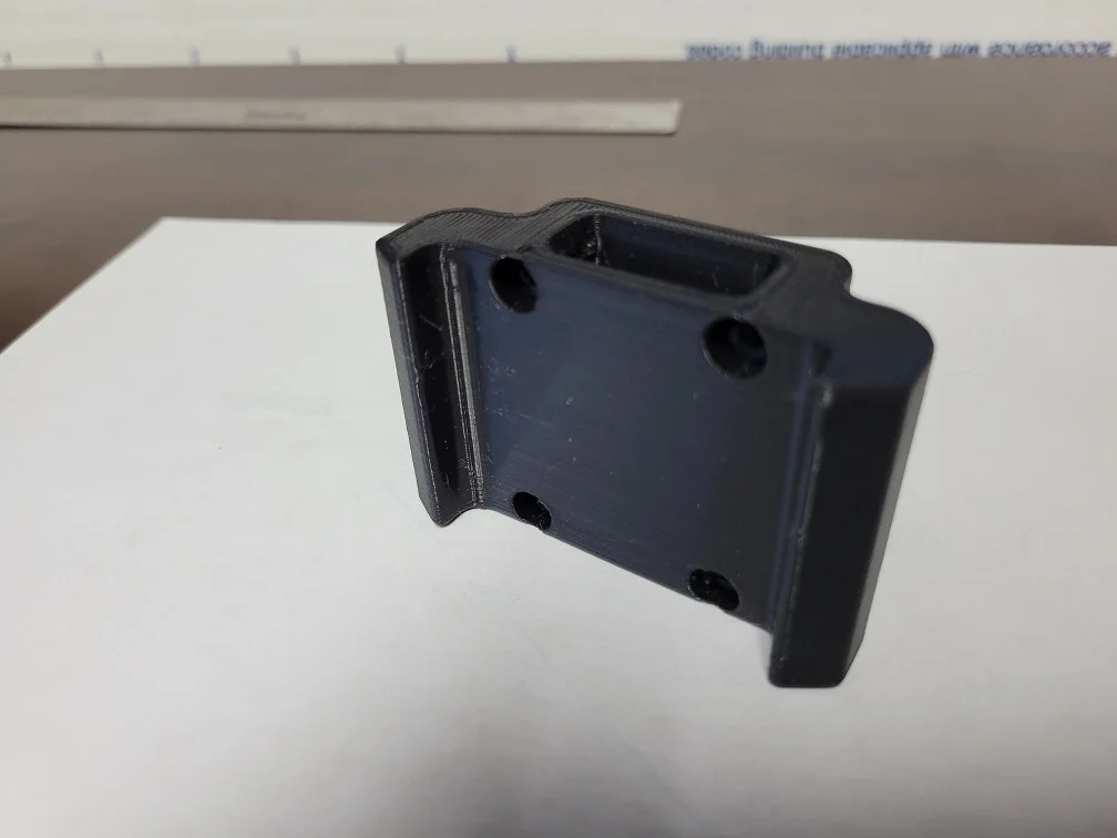

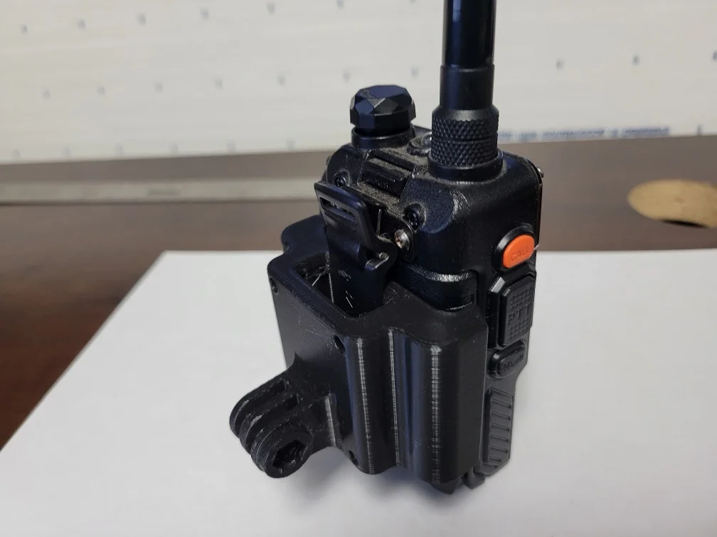

This thread got me thinking...dangerous for sure, but sometimes it works out. It just so happens that my wife got me a 3D printer for Christmas. I got on Thingiverse, a clearinghouse for 3D print ideas and files, and found about a dozen different mounts for the UV5R. I went with one that uses GoPro's mounting system.

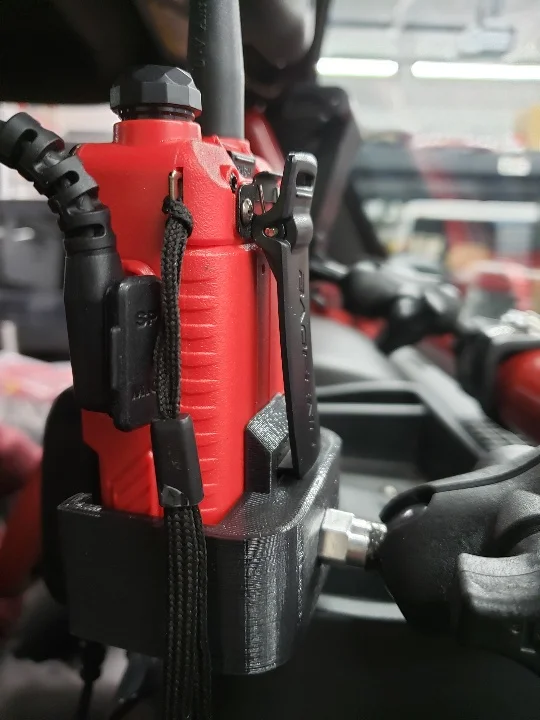

The "Etsy" mount arrived today in a small, well packaged box. I had a female RAM ball adapter so I picked up a 1/4-20 automotive stud and mounted the assembly to my windshield bar. The radio is held in place firmly by use of the belt clip snapping into a small detent printed into the plastic. Seems it will work well.
