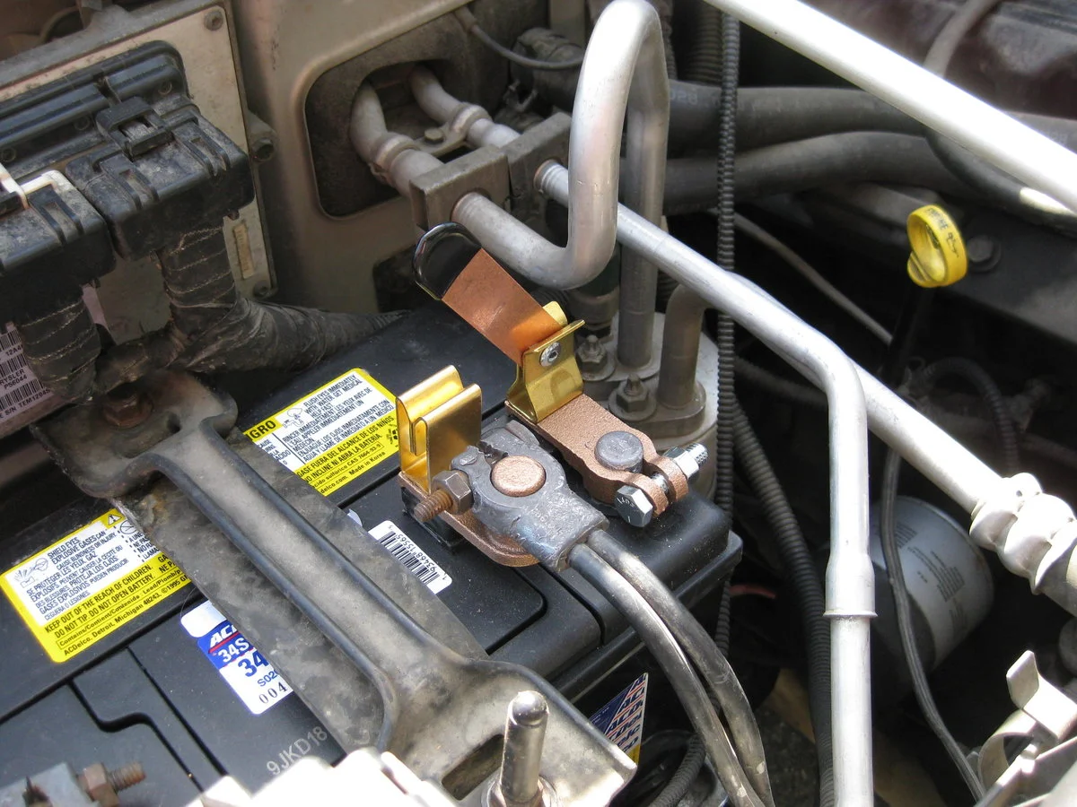

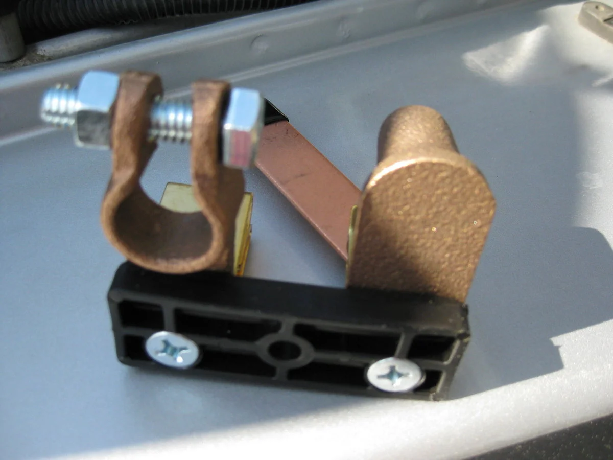

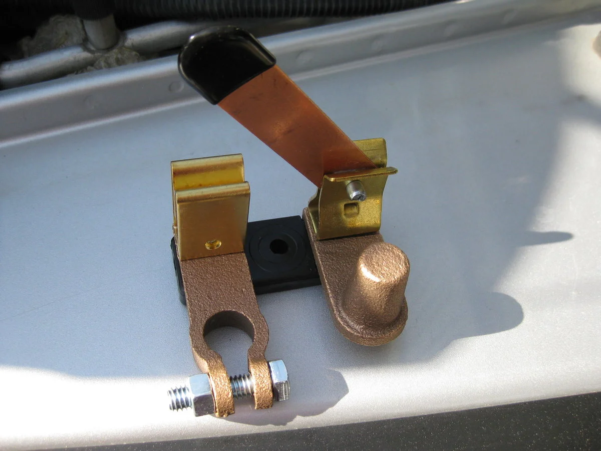

Just a simple knife blade switch. American made. Had to swap the posts around to make it work. Not intended to be a theft determent, only to stop the parasitic battery draw.
