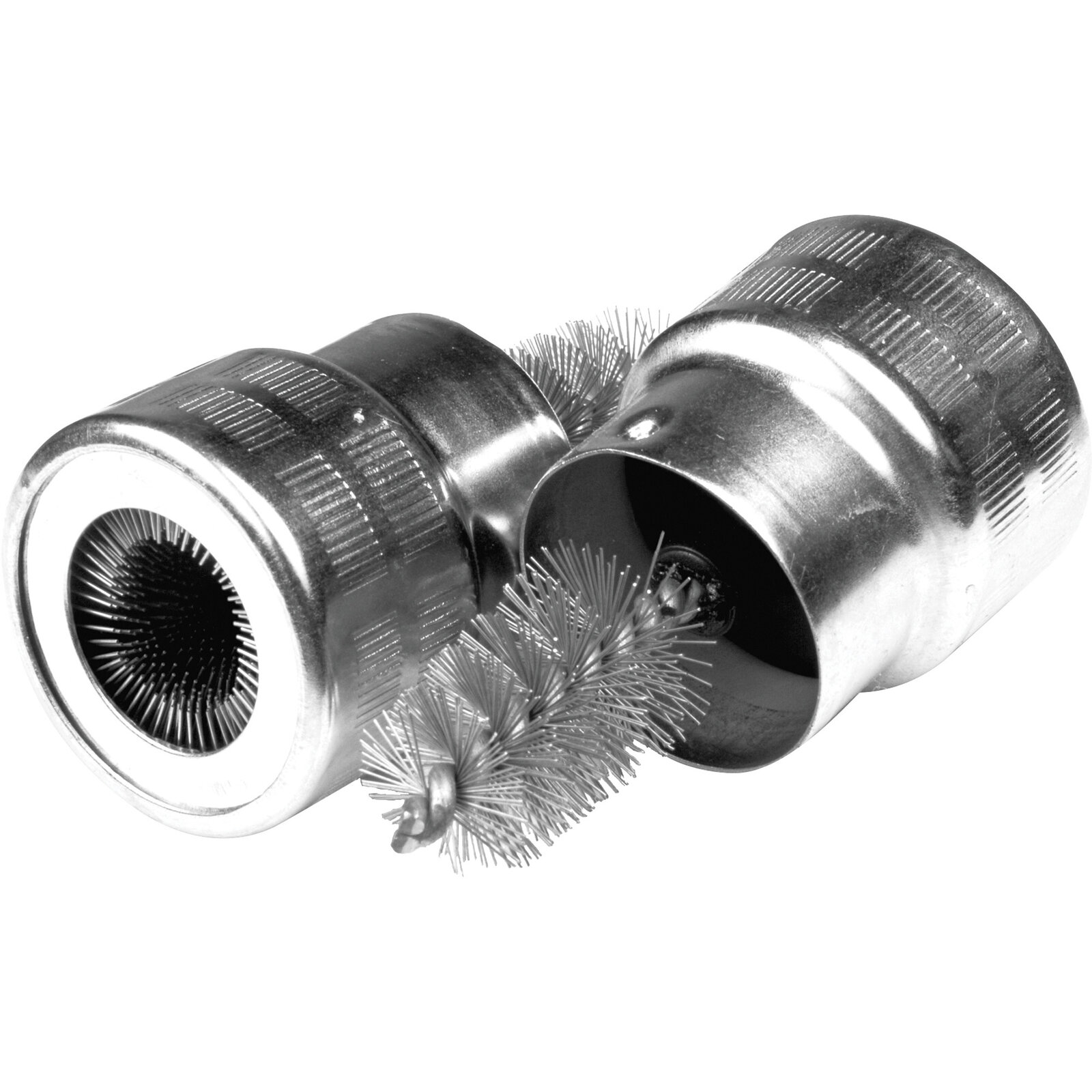

Corroded, dirty, or simply loose battery connections cause a LOT of problems. Even when the battery connections look good they can be bad and the source of intermittent problems.
You can buy a simple battery cleaner that will clean the terminals and the cable clamps for a few dollars at any auto parts store.
