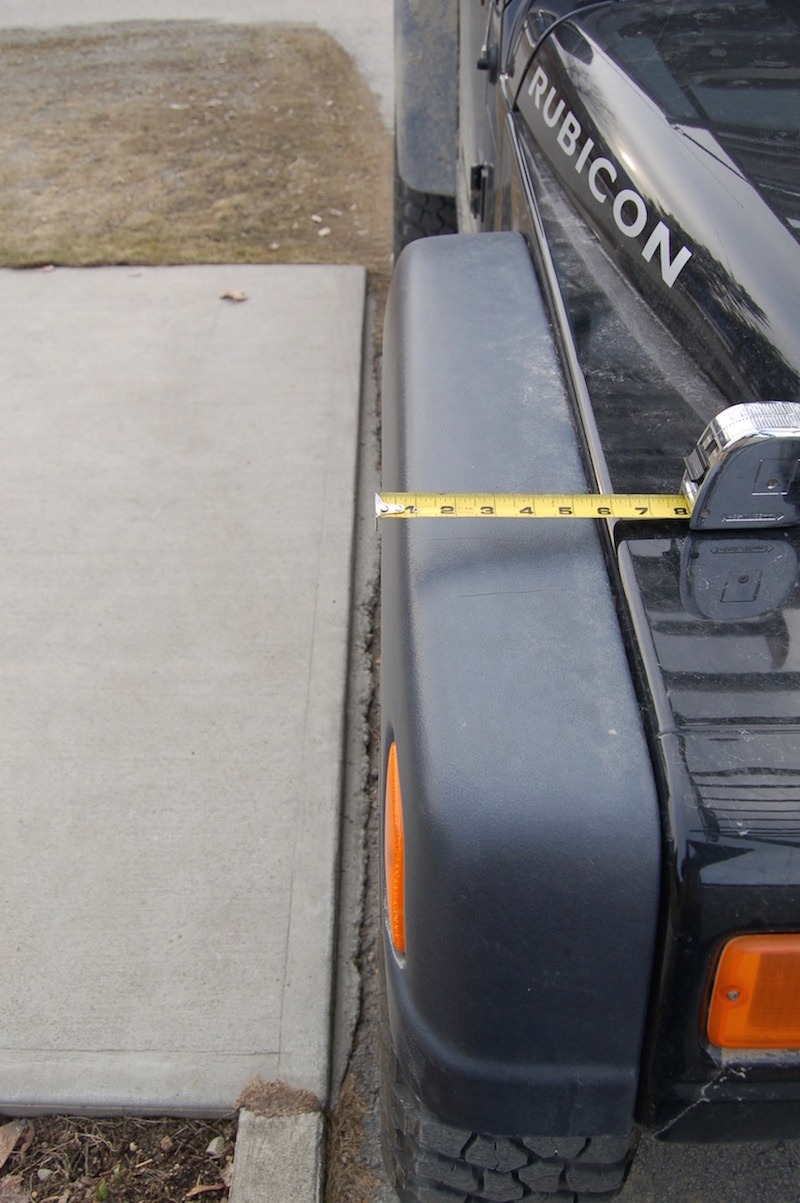

My only concern with the 7 inch fender flares, is that my tires are going to stick out enough to make it look flush. It may be time for some wheel spacers or different wheels with different backspacing.

My wheels are sticking out about 1" past my stock Rubicon flares, so we will see.
I too am also getting mud everywhere!

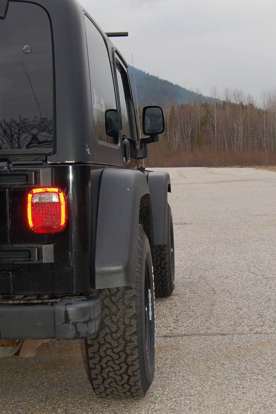

6" Flare with ProComp 17x8 Rims, 4.25 Backspace, 245/75R17 KOs

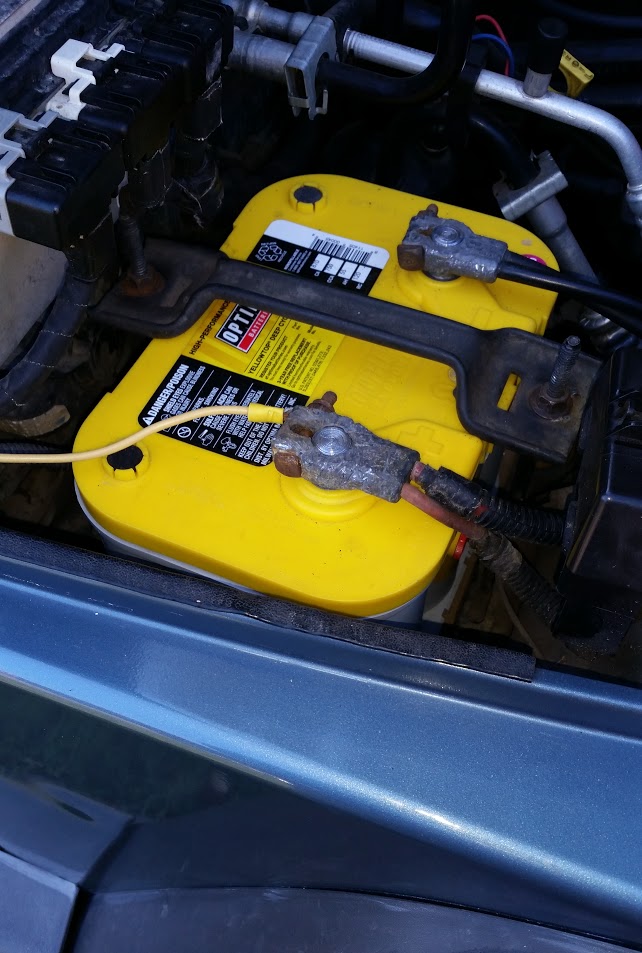

Actually, I do!
Why the yellow top instead of the red top? It's been so long I can't even remember which one is better for what.
I do too!

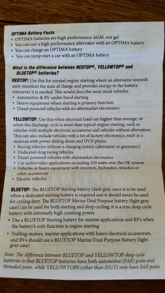

The yellow top is dual purpose and the red top is just a starting battery. Supposedly dual purpose is better for all the auxiliary power needed for winches, light bars and such . I haven't even read the sheet that came with it that tells about the differences.
Reactions: Bermudacat
I do too!
Good point. I'd rather have the dual purpose on my rig for powering a winch, lights, etc.
I use the Blue Top (light gray case) deep cycle on my crawler with a 105 amp alt, it has electric fans for the transmission, power steering coolers and one on the radiator for engine cooling plus a 8724 warn winch. They say that OPTIMA quality has suffered but you cant prove it by me, been running a Red top in a F150 Heritage since 2005.
