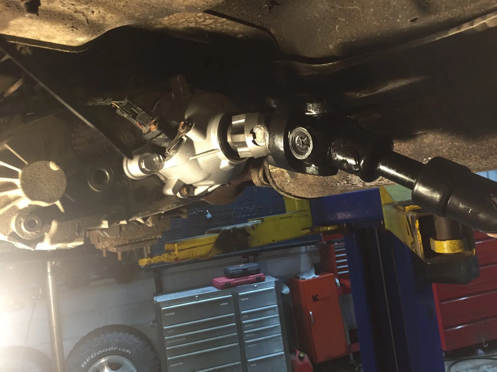

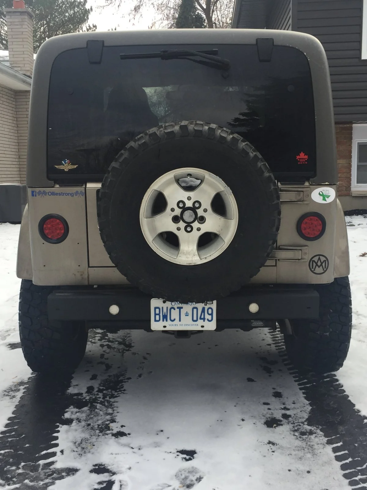

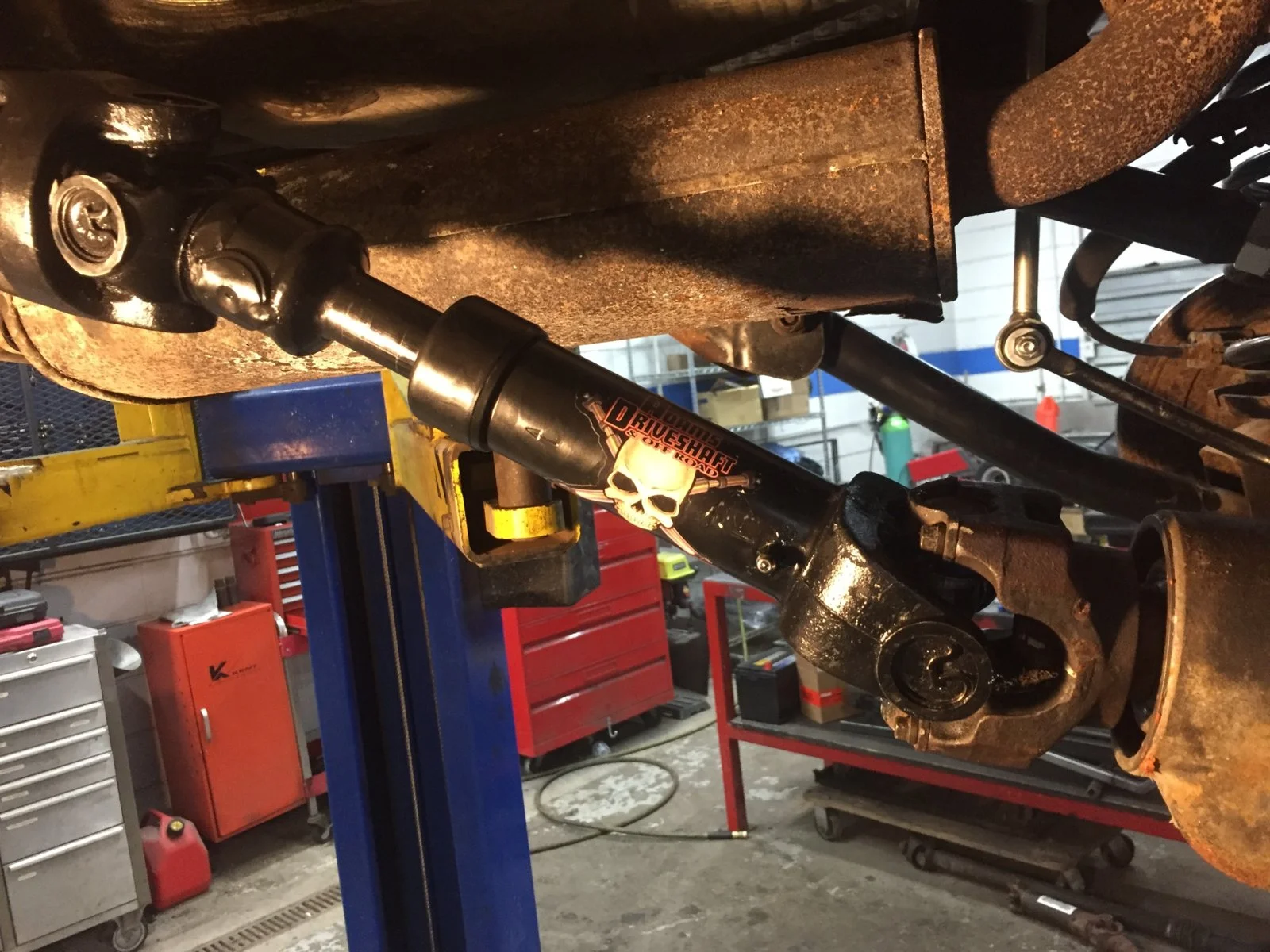

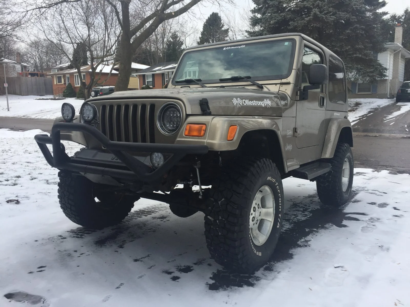

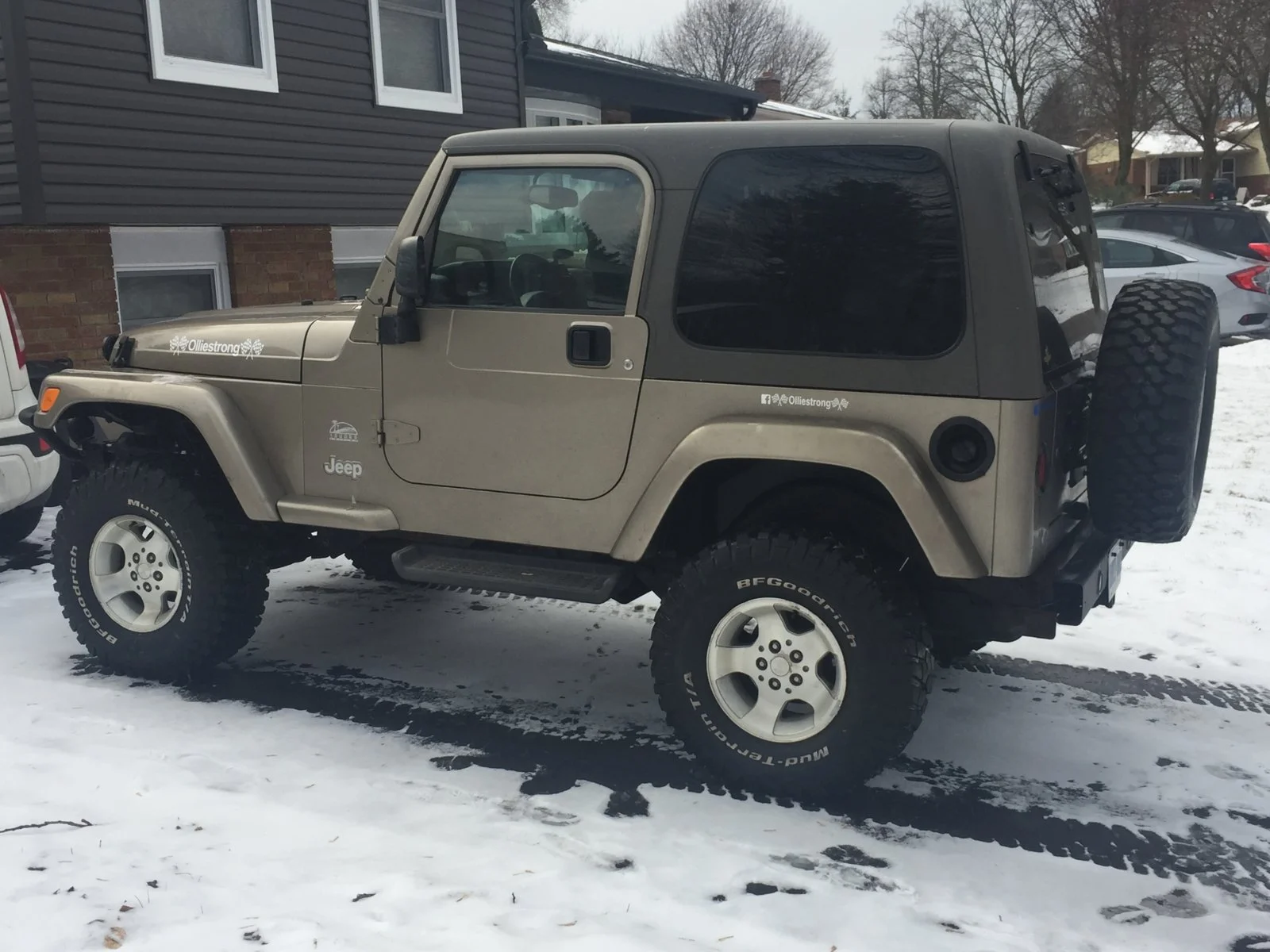

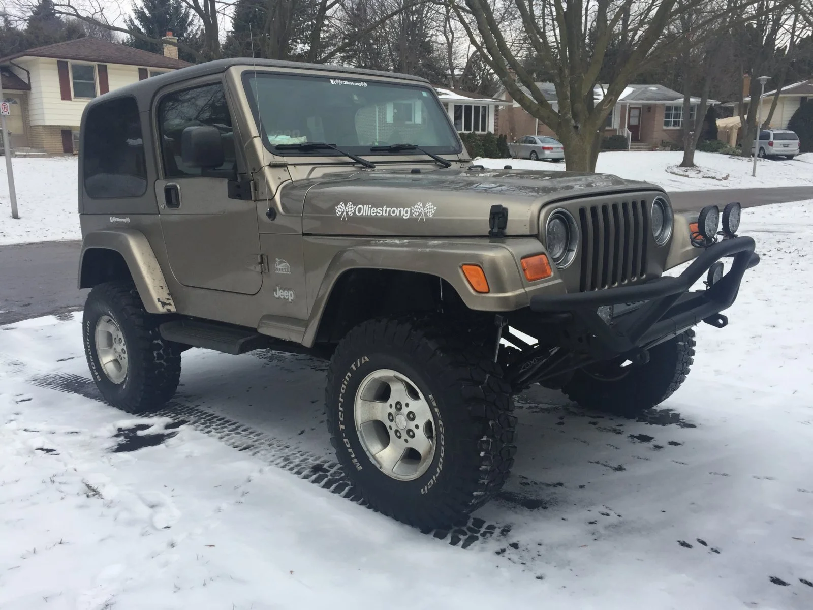

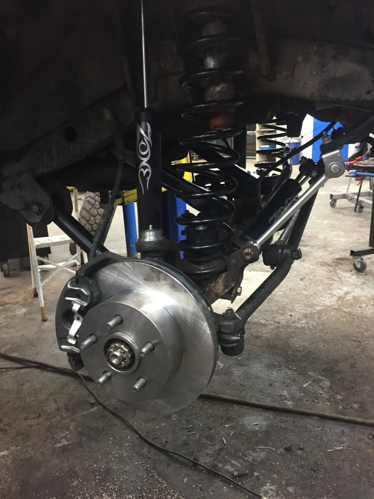

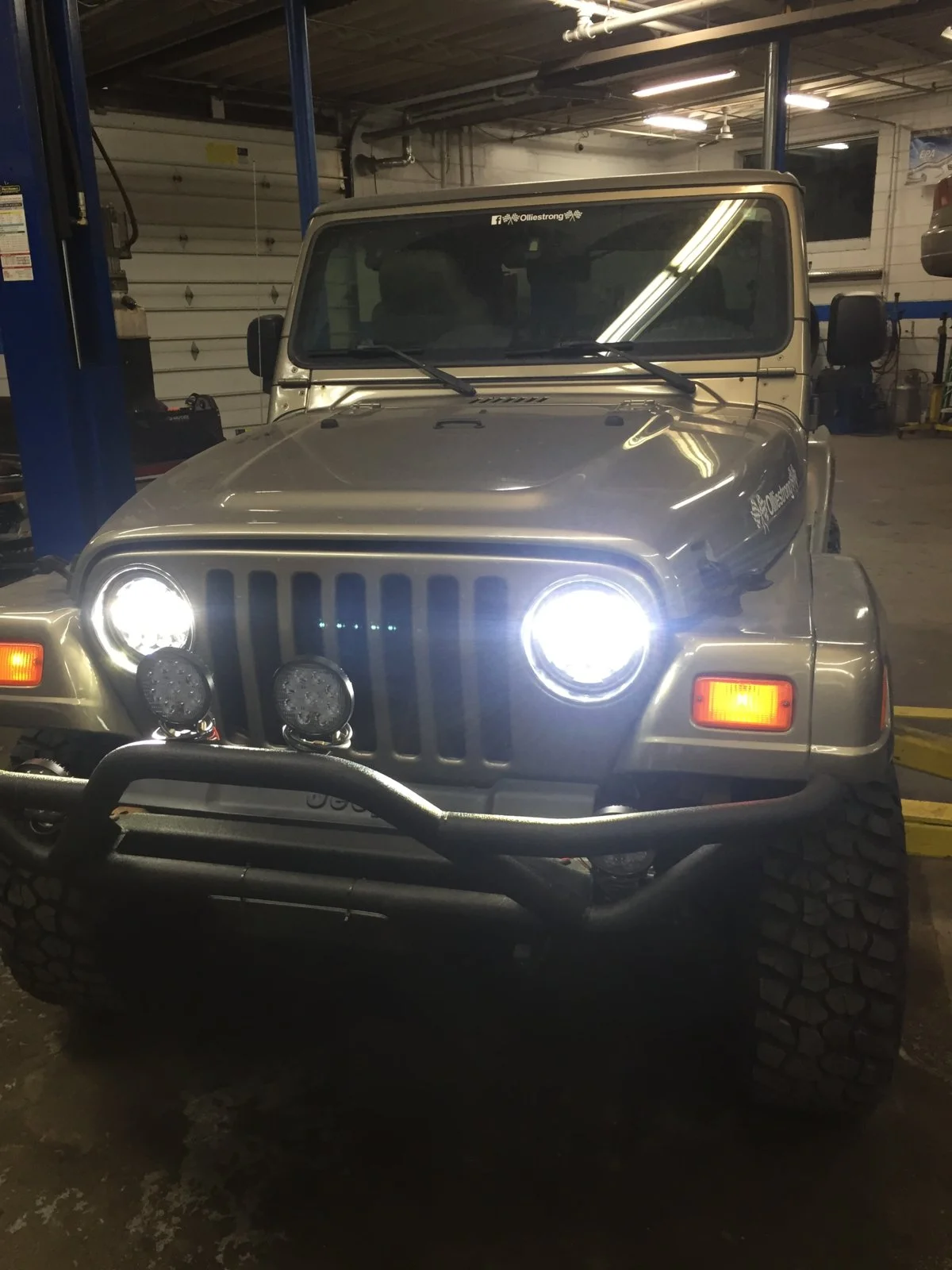

Hey guys. I just wanted to give a little update and thank all those who pitched in with advice. I went ahead and installed a Zone 4" suspension w/Nitro shocks and steering stabilizer. I also bought a SYE and double cardan driveshaft from Adams Driveshaft. Really nice stuff. I also swapped out my front axle housing and put my old 3.73 gears in. All new bearing and seals. Then I did the ball joints (remember my previous axle was honed out and the BJ's just fell in and out). Rubicon Express adjustable track bar. Freedom Offroad adjustable rear upper control arms and did the rear pinion bearing and seals. All new calipers, rotors and pads, e-brake shoes and kit. I did some LED headlights, 4" round LED tails, 2" reverse LED's relocated to the rear bumper and then license plate bolt lights, which I relocated under the spare on the rear. Smittybilt front bumper. I got a lot of stuff if not most, from Amazon and eBay, while I was in Cincinnati for my son's bone marrow transplant. I got it all back to London, Ontario, Canada with no issues and a friend helped me install everything at his shop. Thank goodness for that. After all this, I still have the nasty bearing noise, but it's a bad release bearing, which will be done next week, as well as a polyurethane tranny mount. Thinking about some 33" Deegan 38's. Phew. Done. Here's a couple pics. Thanks guys.
Wow, looks like a totally new vehicle @Rob F!
You did what I did and ordered a ton of crap and installed it all at once. I like the end result!
