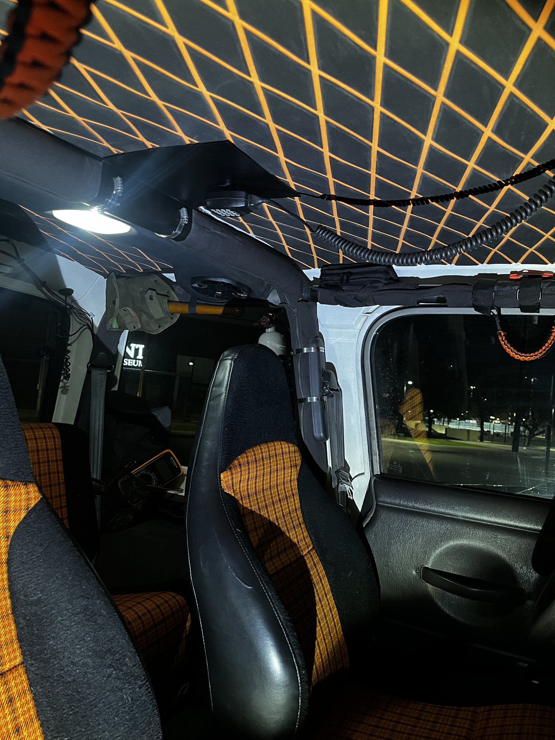

Custom Interior
full sound deadening Noico 80Mil

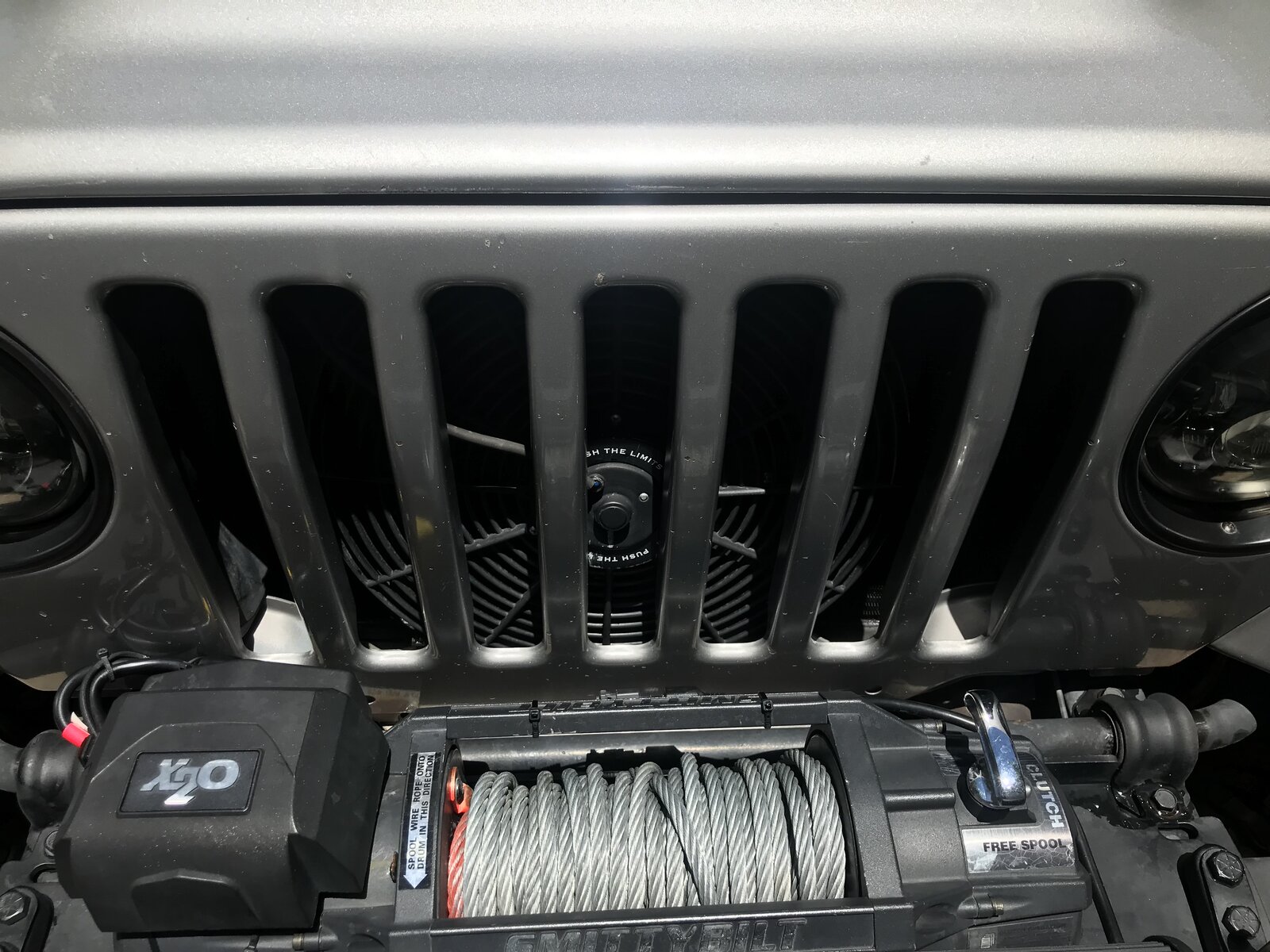

The Problem: I have been fighting an overheating problem with the Jeep, especially at low speed or when sitting in drive-through/pickup lines. I'm aware that the MOPAR cooling system is widely regarded as gold around here and while after a full replacement, it did technically keep the jeep below 230, she was regularly hitting the high 220's - more than I was comfortable with. Keep in mind this is in 100+* humid Texas heat with the AC running full blast and sucking several other cars exhaust, no forward movement or change in engine RPM for sometimes hours, basically worst case scenario.
The Solution! - an electric fan, which can reach peak cooling potential regardless of engine RPM, but I didn't want to sacrifice the CFM that the engine driven fan can pull when it needs to, so I decided on adding a auxiliary pusher fan on the front of the condenser. This leaves the OE system to operate as intended, with exceeeeeedingly limited drawbacks (it does block some airflow) and the ability to pull extra CFM at idle or low RPM when needed.
The Install: After extensive tape measure work, the largest/highest CFM fan you possibly can fit is a Mishimoto SLIM STRAIGHT 16" fan this is mostly due to the limited clearance between the back of the grill and the front of the condenser. I do recommend going with a name brand Mishimoto, SPAL or other fan. This install is a bit of a PITA and you don't want to be going though this headache to replace your lifetime warranty amazon special every couple of months, my Mishimoto has been running great for 2 seasons now with zero complaints. To install the fan I had to remove the radiator and core support and slide the condenser back toward the engine out of the way. I wound up trimming most of the top of the electric fan shroud down with a Dremel in order to get it to tuck under the back of the hood latch location. I then zip-tied it in place and re-installed all the hardware. I wound up having to trim down and re-bend the secondary hood latch in order to prevent it from pressing down on the fan shroud and contacting the fan blades, this wasn't hard but be careful not to over-trim it, this would make the hood very difficult to open.
Through the grill
Trimming the safety latch
Fan control Module
How far to trim
How much to trim/clearance
Then it was just a matter of wiring, I started with just a simple toggle switch and eventually bough Mishimoto's Fan Control Kit, I stuck the prob up by the passengers headlight through the radiator, it does occasionally get a little heat soaked on short stops there, but I figurer it just helps cool down the fuel injector rail which is still giving me hot-start problems. I have the fan set to come on at about 215* and it turns off again at 205*. it pretty much only ever comes on when I have been sitting for 15+min in the hot summer, or when I flip the switch to tell it to.
Benefits: The fan does quickly drop temperatures at idle, not only is it capable of sustaining a temp but it will bring the Jeep back down from 215 to 200 in 5-10 min. Most surprisingly it noticeably drops the AC in-cab temp, maybe 5*. doesn't sound like Much but it can make a HUUUGE difference when your sitting in stop and go traffic for 2 hours. I regularly find myself reaching down to switch on the fan long before the engine needs it, but simply because I want the extra airflow through the A/C.
Downsides: This sucker is LOUD, I mean like, annoyingly loud. If you're out working around the front of the jeep, you will hear it. Inside its fine but I have had complaints from SXS's in-front of me on the trail and it gets inside your head after a while. for whatever reason the frequency seems to be a bit of an earworm and can get tiresome after and hour or 2 working around the jeep in hot weather. I think this could be mitigated with a SPAL fan (fewer max CFM) that has speed control, especially if you could route it through the PCM somehow but I've seen limited success. Unfortunately the Mishimoto is pretty much all or nothing, and the slim fan that we need to fit in the space is just Drift car fan loud, does move a ridiculous amount of air. Other than that, I'm sure theres a perfectly good reason I shouldn't have removed the core support, but it hasn't given me any problems and the fan is pretty rigid, kinda doubles as one, so meh.
All in all, if you live in Texas and spend much of your time at low speed, I would recommend it. If nothing else for the extra AC efficiency, the engine might be "ok" as is in this heat, but I'm not!

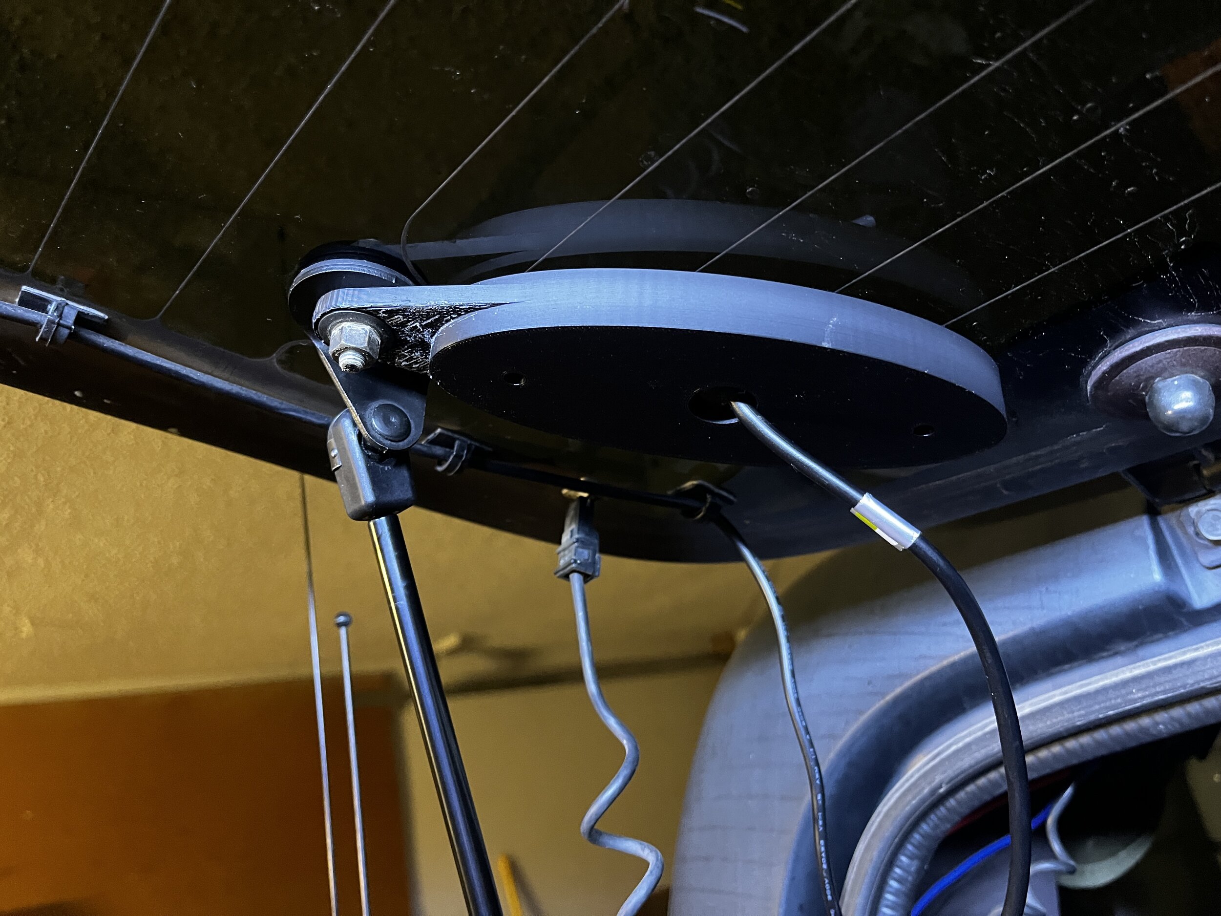

Added a "real horn" cause I'm tired of having people pull out in front of me and being politely asked to move along. If I am being honest the horn is waaaay louder than it has any right being and I was really just going for a "deeper" or "wider" horn tone as apposed to louder, but we'll run this for a little while and see what I think.

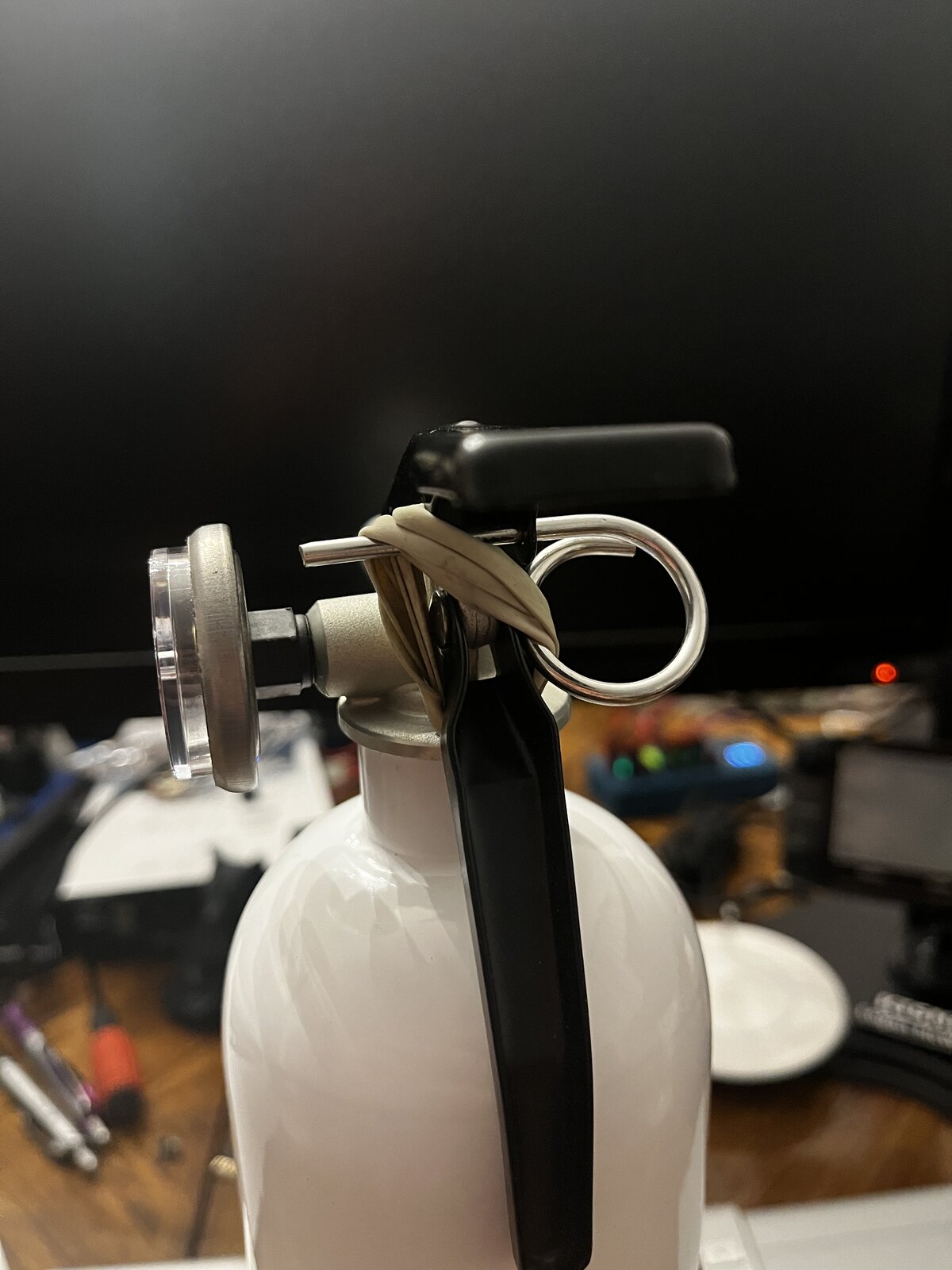

I finally got around to installing a fire extinguisher mounted to the roll bar which is actually a plastic mount. At first I was skeptical, but in combination with a well placed rubber band it doesn't rattle at all. I can reach the extinguisher from the drivers seat, from outside the drivers door and from the cargo area (with a bit of a stretch). its not the Jerry below the seat option, but I have radios in t9he way of mounting there.

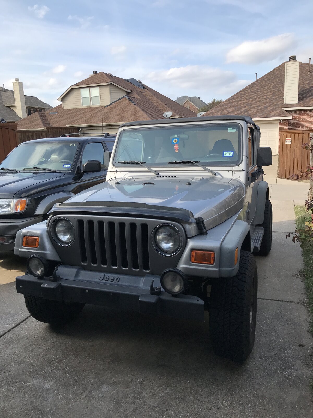

I have decided to start a build thread for the Shoebox, i've had her for about 6 months now, so the first page of this thread was me catching up. she's a 2001 4.0 5spd, silverstone metallic no frame rust or other significant rust 250,000 miles when purchased. came with a soft top and 2 inch spacer lift, aftermarket radio head. rolling on 31's and canyon wheels.
Tentative build plan is 2.5 OME, 1.25 body, 33's, AR767 style wheels, bumpers, winch, lockers, maybe a tummy tuck.
Ok, so his is her the day I brought her home, wonderful base but entirely to bland, someone has to do something about that monotone color scheme.
I am her 3rd owner bought buy a guy in Vermont who moved down here andowned her until 2016ish then a ex-marine bought her Form his friend after the first owner died. he drive her as a second car for afew years and then sold her to me valintines weekend, feb 2020. 4K out the door. (She was missing a sway bar link so she drove like junk, threw a pin in and drove her home.)

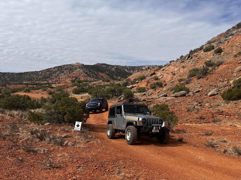

Did the Oklahoma Jeep invasion at Robbers Cave in OK - last weekend in April
had a great trip running with a buddy of mine in the blue F-150

Got the new headliner and a custom fabbed mic mount plate installed - The Headliner uses a layer of nocio, followed by a heat barrier, and then EVA boat flooring for the final pattern. It does wonders to cut down heat, road noise, and rain noise. highly recommend for anyone that drives long-distance
The mic mount plate is just a bent piece of 10ga sheet metal painted and worm geared onto the roll hoop - it loads up against the roof and easily holds 2-3 mics (magnets epoxyed to the back of the mic)
Swapped over to a D-710 for main 2M/440 functions, as well as a custom APRS system running through a raspberry pi and a Moto phone (all over RF) digital functions have been taken over by a Moto 5550e and a CDM220mhz is soon to be added
^Moto 5550 hidden beneath the passanger seat
Still need to find somewhere to tuck the CDM, likely hidden up on the rear wheel tub or somewhere, still need to find a good spot.

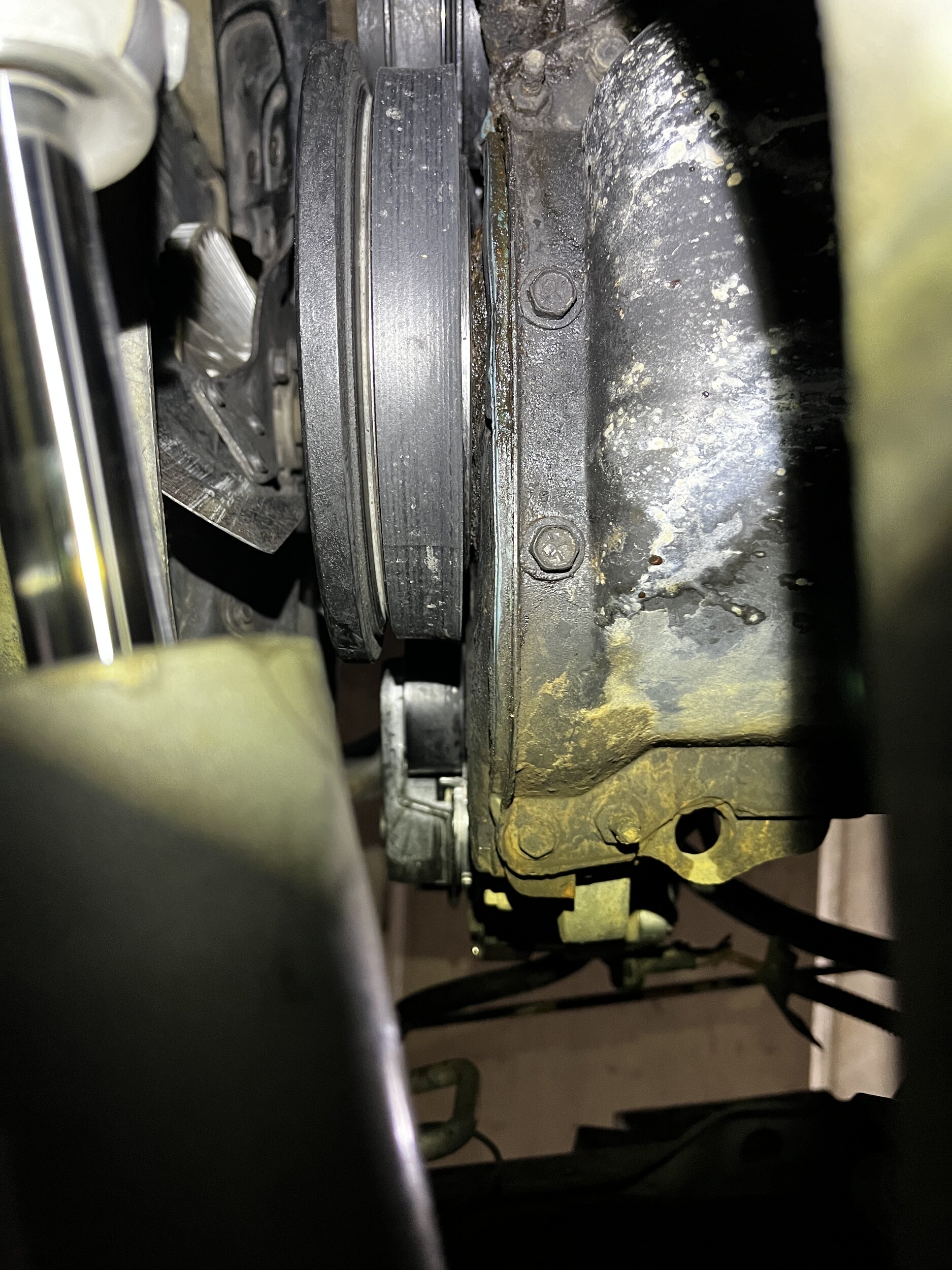

Harmonic balancer decided to split at the rubber and throw the belt after 300,000 miles. Thankfully it failed in the parking garage, so I got to tear the jeep apart and fix that in the uni parking garage. She got me home, but only just.
