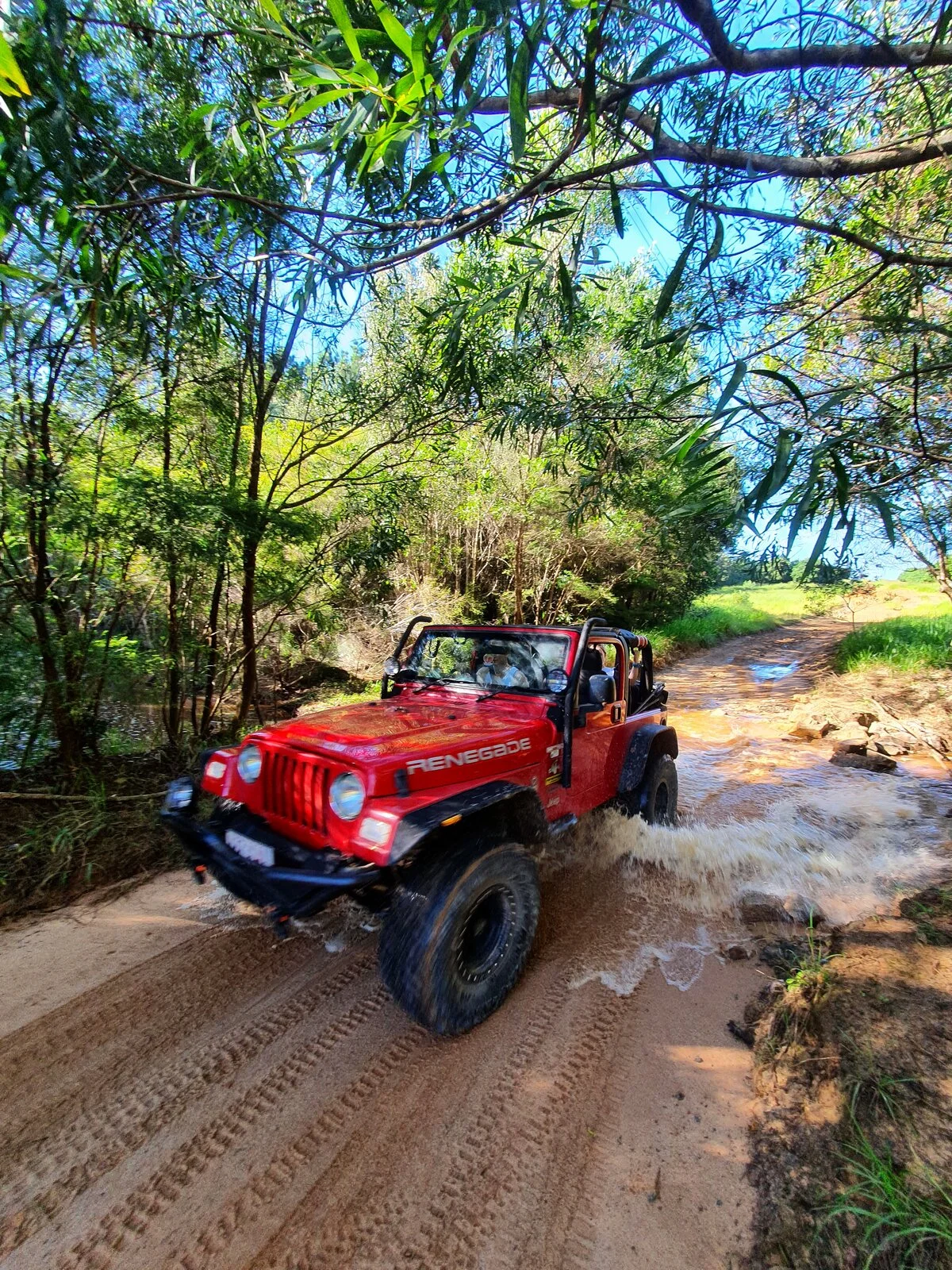

Haha mate literally did a few hours of 4x4 in glasshouse today in the jeep! Went for an overnight camp just off the trails there.Was awesome 👌 we live 20 minutes from glasshouse, little and big red are nuts will try with new lift.
