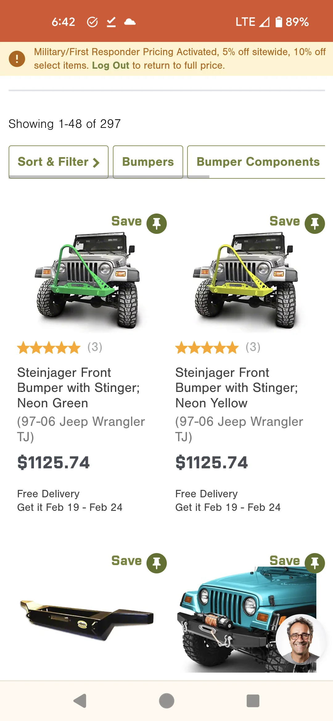

This is the most expensive front bumper for a TJ on Extreme Terrain (quick search). Definitely NOT better than the plethora of options for a fraction of the price. And honestly, this one surprised the heck out of me! Who's paying THAT for THAT!?
Nobody is doubting quality brands building legitimate quality products and charging realistic market prices. And by no means am I trying to argue you with on here. But, I think you can see what I'm saying, and have to agree, it can't be used as a blanket statement.
