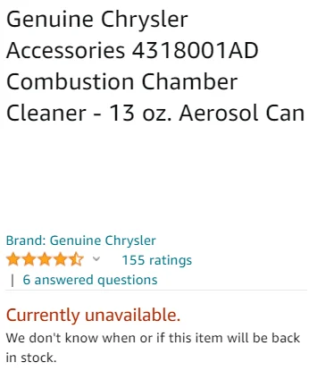

Techron, Cataclean or something else? Let the debate begin!
Seafoam.
Old timers used to dribble water into the carb, which effectively steam cleans the cylinders. It works, but I'm not a fan of water in my engine.

Seafoam.
Water in the engine when used like that absolutely will NOT harm the engine in any way. No way no how. In fact water injection has been used in internal combustion engines since at least the 1940's which is when it was discovered how clean the engines were internally with its use. It is still used, it's even used in some jet engines. Water is injected to add power to the engine.
We're not talking about dumping water into an engine that would cause hydrolock, we're talking about dribbling it in or spraying it in as a mist. Even Mopar's Combustion Chamber Cleaner used by dealerships is mostly water with a little ammonia added.
