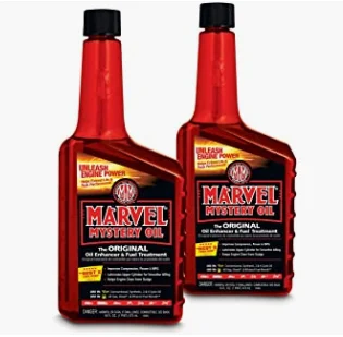

I took off this morning in first gear using my automatic transmission. Went to 4,200 RPM. Threw a misfire on cylinder #4. Reset the code and put Marvel Mystery oil in my gas.
Not going to help an engine revving to 4200 rpms. That's most likely caused by a vacuum leak or even the transmission being low on ATF causing the ATF pickup to suck in air which makes the transmission slip like it's in Neutral.
