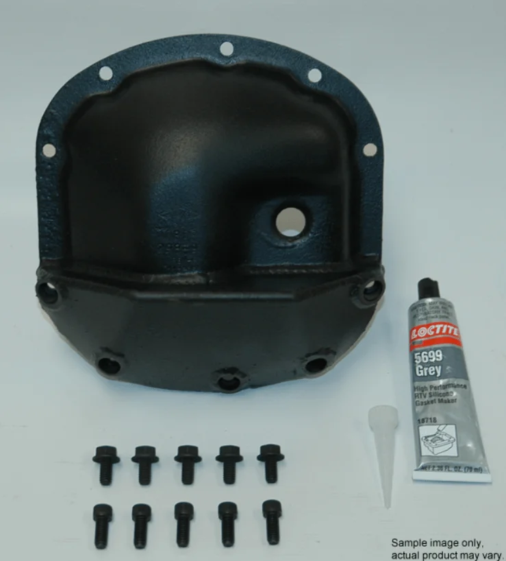

I picked it up today. It turned out to be a brand-new never installed T&J differential cover, the brand that Barnett took over. I knew it was old because it still had the T&J business card in the box. $40, new-in-box complete with a gasket and all the bolts. The guy who sold it to me won it many years ago & never installed it since he has f/r ARB lockers.
I am so stoked, I don't often run across a deal like I just got. What's cool about the design is they left the top of the cover alone so it can't interfere with any of the steering components like the tie-rod.

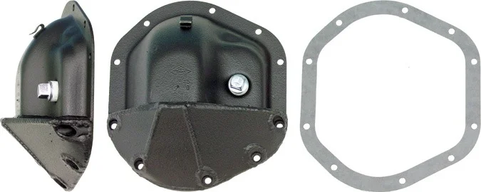

Only when you don't understand its benefits. Plus its higher cost is because it's not just a piece of cast steel like Solid's is. The T&J/Barrett cover design requires skill and welding to build... they don't just pour steel into a mold and paint it.
That Barrett design, originally made by T&J, is a very popular diff cover for high-end builds, I've had a couple of them. I had the exact cover you're recommending but I'm no longer running one. Thick heavy covers reduce clearance in front of them and many builds won't tolerate any reduced clearance. Especially up front where thicker designs like from Solid commonly cause the tie rod to rub against it.

By the way if you are going to run that "awesome" Barnett modified OEM cover, be sure to follow their directions: Upon installation of this cover, before operating the vehicle, check the inside clearances of the oil filler plug to be certain that the plug does not contact with the inner differential carrier, case, locker unit, or ring gear. Use of a marking compound is recommended to accomplish the inspection. If the fill plug does come in contact with inner components of the differential, the inner portion of the plug must be slightly ground to eliminate any such contact. Failure to do so will result in driveline related damage.

I had the Barnett as well and returned it like you did, the welds were compromised on my first ride with it.

Furthermore, the fact that the fill plug on the Barnett will make contact with the carrier and require grinding is a little over the top for some new Jeep guys.
Only when you don't understand its benefits. That design, originally from T&J and now made by Barrett, is a very popular diff cover for high-end builds, I've had a couple of them. I had the exact cover you're recommending but I'm no longer running one. Thick heavy covers reduce clearance in front of them and many builds won't tolerate any reduced clearance.
This is ESPECIALLY IMPORTANT on low lift builds. Most, if not all, of the more expensive and "cooler" looking covers WILL contact your drag link or track bar and cause things to bend or break. It's something that you absolutely have to check for on, say, less than 2-1/2" of lift. Cycle the suspension and carefully look for interference. The Barnett cover and the stock Dana heavy duty cover are actually your best bet on low lift rigs.
