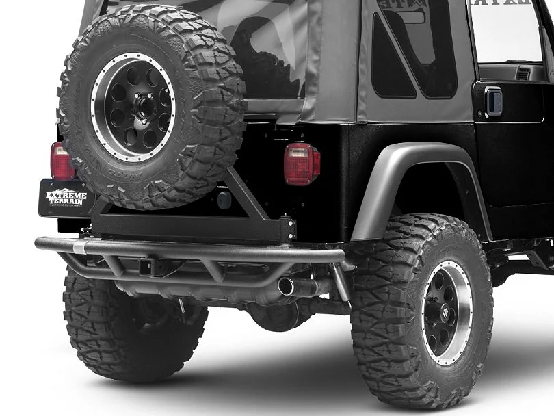

I have a Smittybilt (I know "Shittybilt".) tubular SRC rear bumper with tire carrier sitting in my garage. That I know you can add jerry can holders too. (But it's known to be a little jinky when it comes to a rattling tire carrier latch. Mine is a little loose. I'm going to attempt to fix it. The only thing - beyond looks - that I like about the Smittybilt SRC is it's tow rated to level III at 5000lbs. Otherwise I would have opted for the Redrock or Rugged Ridge bumpers. Which are the only other two tubular designs I've found.)

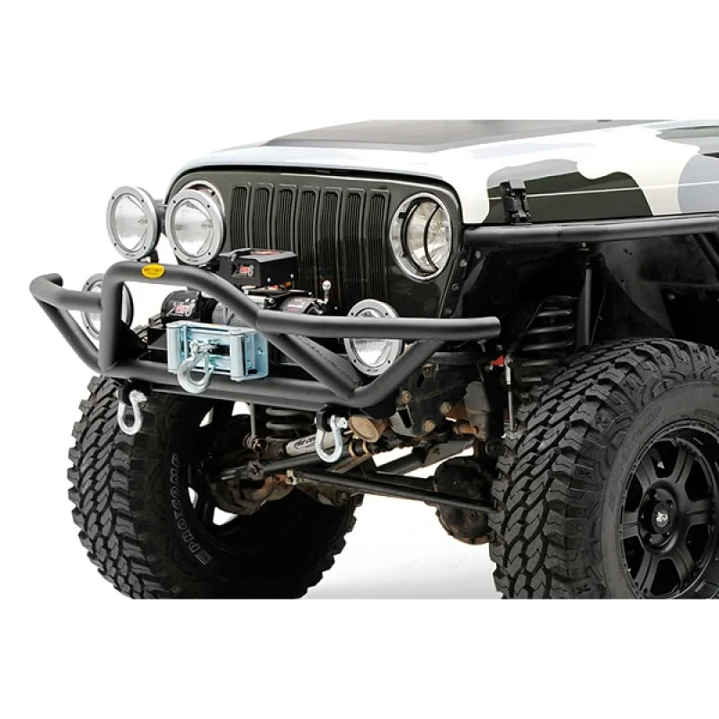

Here's the Smittybilt SRC rear bumper with tire carrier for $468. I got it for $100 used which is why I'm willing to try to fix it's latch rattle. The matching front bumper is also only $200. SO if I made it work. It would be a $300 front and rear bumper with tire carrier set up. Minus the cost of jerry can holders:
https://www.extremeterrain.com/smittybilt-src-rear-bumper-tj-yj-76621.html

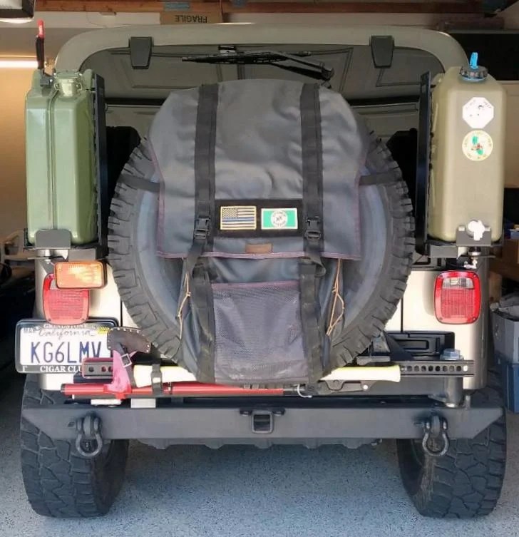

I use Rock Hard 4x4 can brackets. They might fit your Smittybilt tire carrier. They come pre-drilled for Rotopax hardware and with slots for hold down straps. They will hold NATO style cans, Blitz style cans, Spector MFC;s and MWC's, and Rotopax containers.
P.S. - not "everyone" is against using jerry cans although one jerry certainly is. Everyone has different needs.

Thank you! You're even carrying a hi lift. Your a rebel! ;) Who made your bumper and tire carrier?

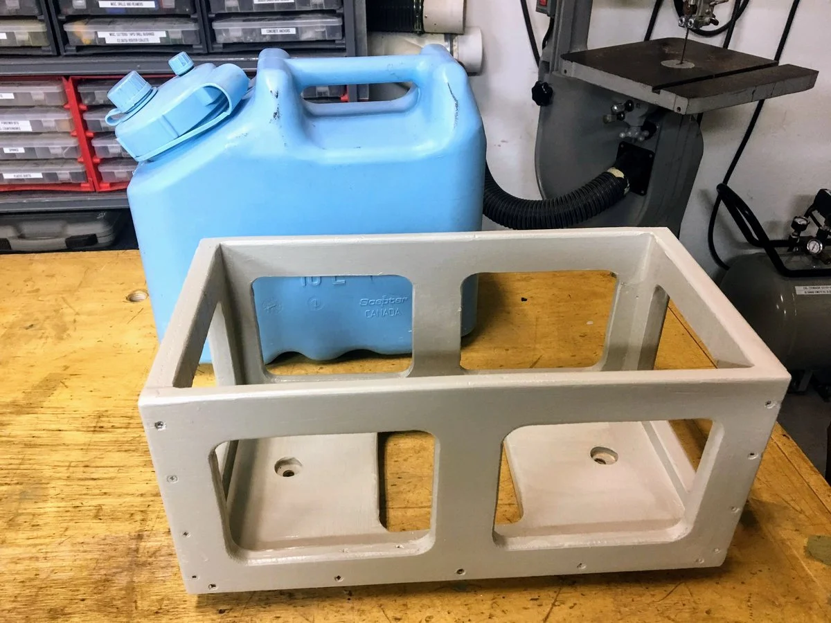

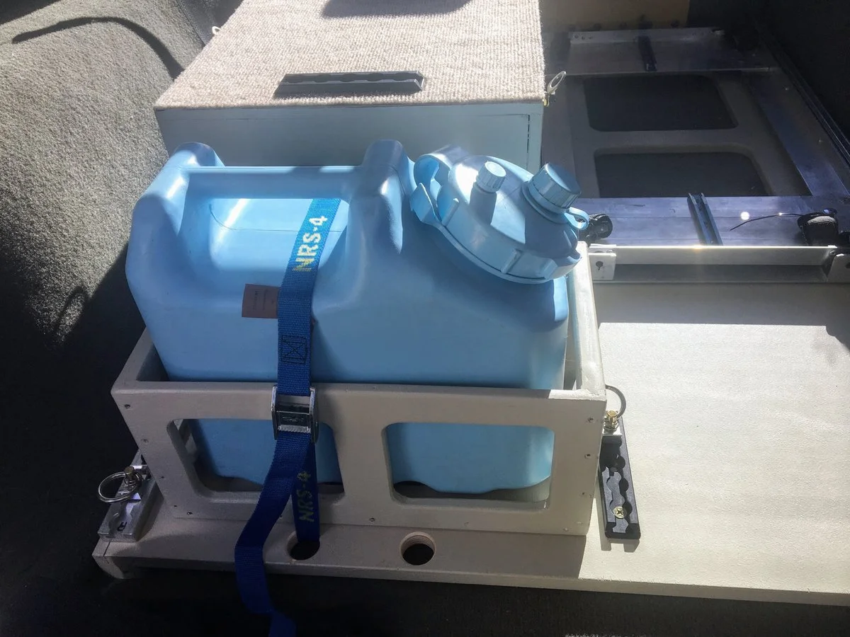

I use this holder for both 2 1/2 and 5 gallon MWC. I show mine secured to my cargo baseboard that you may have seen.
Would something like my carrier work in one of the rear foot wells and still let you have one passenger in the rear seat?
A mounting plate for this secured to the rear front seat mounting bolts?
If that much water is a priority could you get a 2 1/2 MWC behind the rear seat using a holder like mine secured to the rear seat mounting bolts or even the M8 child seat retainer bolts ?
I also have these.
If you use a Super Siphon, you can drain the cans in 60 seconds without ever removing the cans from the bumper. Saves a lot of time and effort. Lower can mounts might not be able to that
