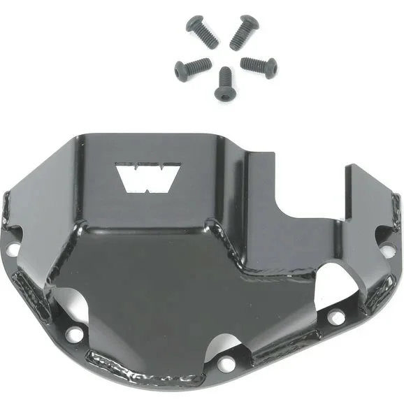

For moderate wheeling the Warn one works well, after harder wheeling it becomes smashed all up in there, deforming the factory cover. I ran one for a while, worked well enough. The Barnes one works well too, up to a point, regarding the aforementioned battering ram technique. . I tried on on my 60, it only lasted a few months until I couldn't access the bolts very well.
