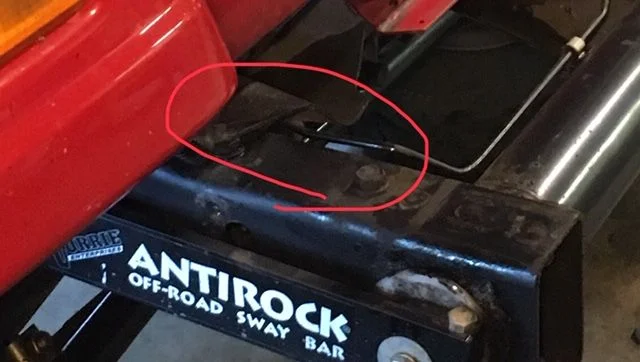

3 - not so much paint related, but does anyone know what these bolts are on the front of the frame on both sides? They don't seem to be doing anything & if that's the case I'm thinking about pulling them out:

I believe those bolts are for the stock sway bar and don’t do anything otherwise.

Ha, I feel like an idiot now, I actually removed those bolts before when I yanked my stock sway bar a couple years ago, had forgotten all about that. When I saw them this morning I couldn't for the life of me figure it out :LOL:
