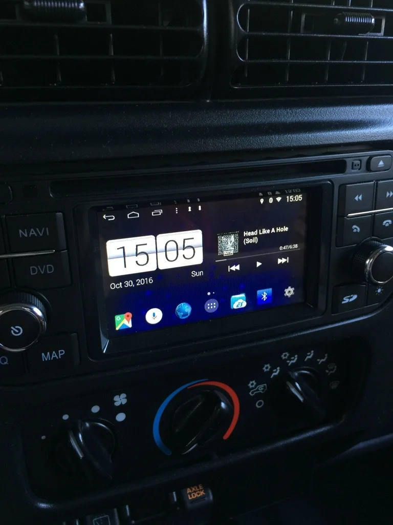

First you remove the top plastic trim piece from the dash. I start on the side where the VIN plate is and gently pry up from left to right. Right in the middle underneath that piece are two screws that hold the center dash bezel on. Remove those two screws then gently pry off that center bezel starting from the top. Four screws hold the stereo in and if it's the stock stereo there is a nut or a screw (I don't remember which) at the very back of the unit that you have to feel for and remove. Slide the stereo out and unplug the stuff from the back. Grab your awesome new S160 and plug in the antenna and the harness. It was truly plug and play. Then reinstall the trim pieces in reverse order.
Super easy and not complicated at all. Still loving the stereo. It sounds great and has every feature you could imagine.
I even have a Bluetooth OBDII reader and it interfaces with the unit perfectly.

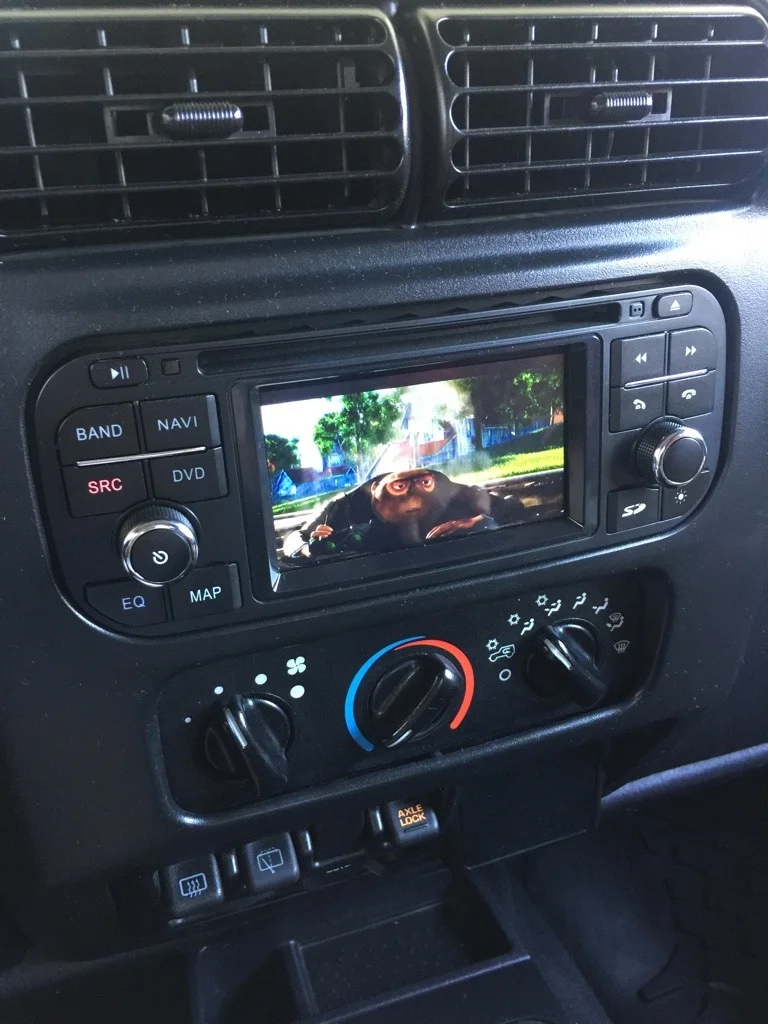

@xenocryst I love the stereo man. Best few hundred bucks I've spent on the Jeep. The only quirk I've found is when playing FM radio, when adjusting the volume it's kinda of jumpy. I'd bet it's the front end programs fault but I haven't bothered finding a different app to use. It doesn't bother me enough to want to change it. Other than that, it's amazing. I drove 4 hours yesterday and my boy watched movies off the SDCARD the whole time. I use Pandora on it all the time... And Netflix. Also, Google Navigation is so awesome.
