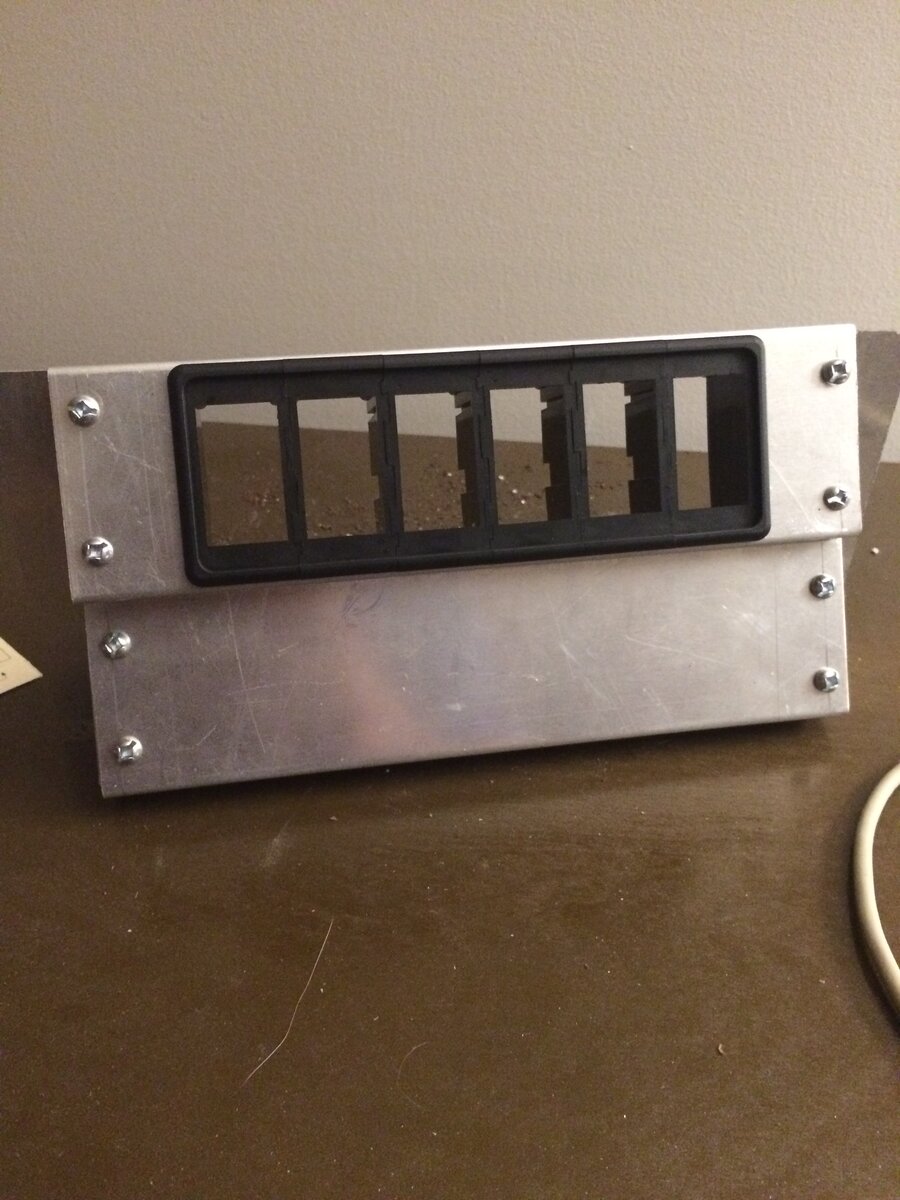

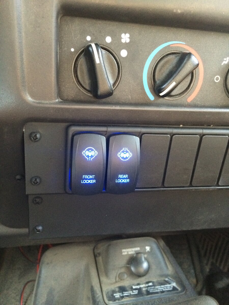

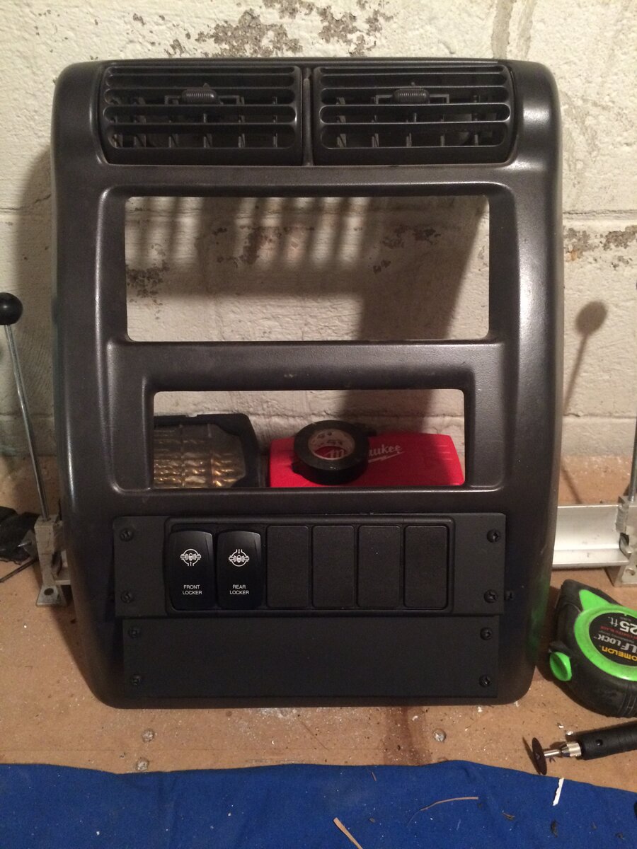

You have already done some work to get couple switches in place but if you wanted to start over the panel that I made is always an option, I'm sure I can find the instructions. Mine fits OTRATTW Switches and has room for lots of stuff.

I like the look of that, and I saw some instructions for it. It looks like it might just be easier for me to buy another stock 3 slot switch panel and cut out my ashtray spot. Id hate to lose it though because it holds a lot of change.

I put the instructions for that panel in my post. I'm planning on going that route. Any suggestions or tips for making it?

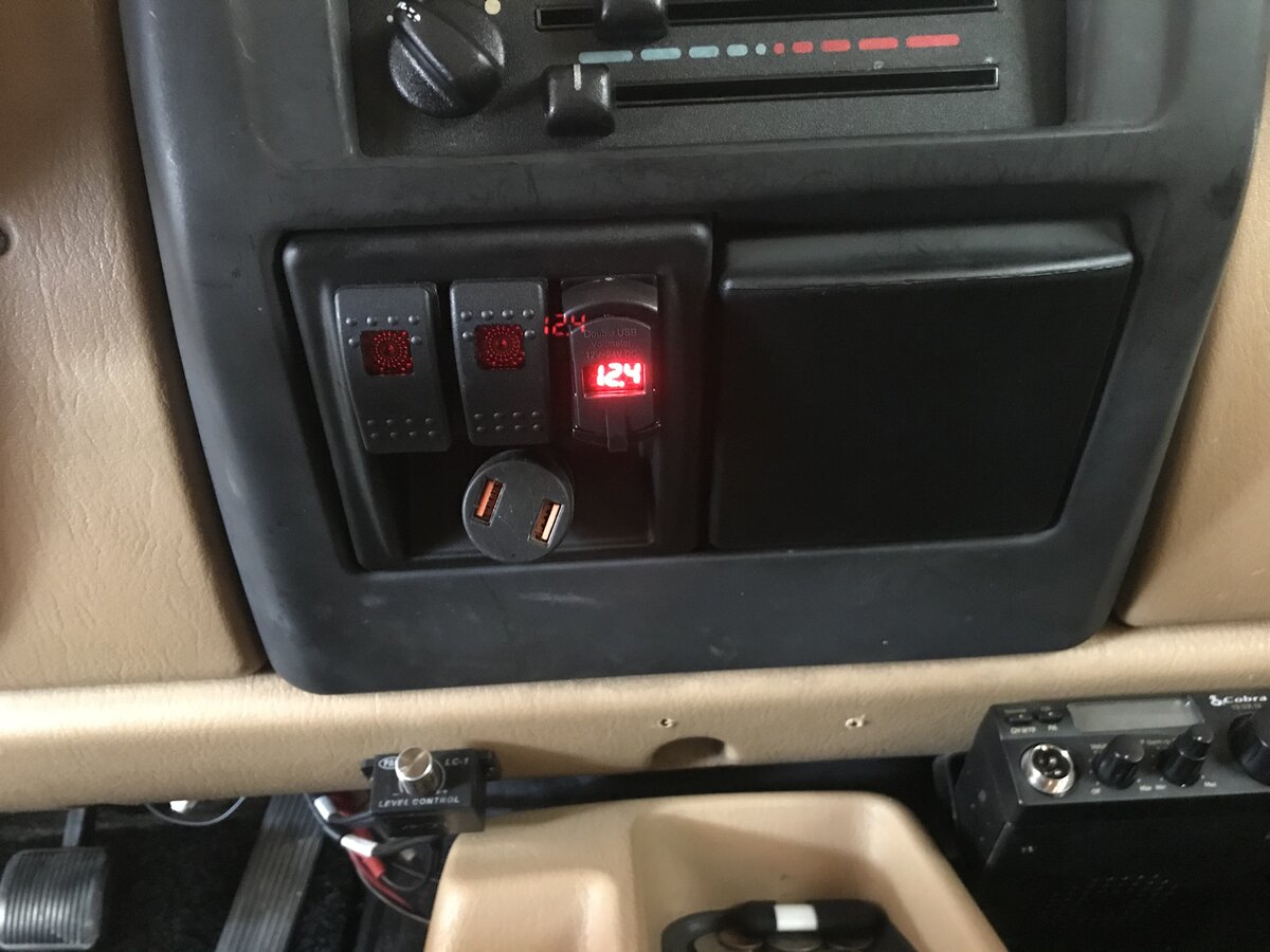

I installed the mod shown on the first post...replaced the ash tray with 3 switches and a dual USB port. You can find factory looking aftermarket switches which install in same manner on eBay, about $17 each. I also added a relay panel under the hood to control everything.
Just be as precise as you can with your measurements. Fitting the OTRATTW switch block in there was a real tight fit seeing as that's not what it was designed for, but mine worked out really well I think. Not sure which instructions you have but if I remember correctly I think there was a measurement or two missing and you just had to kind of fill in the blanks.
