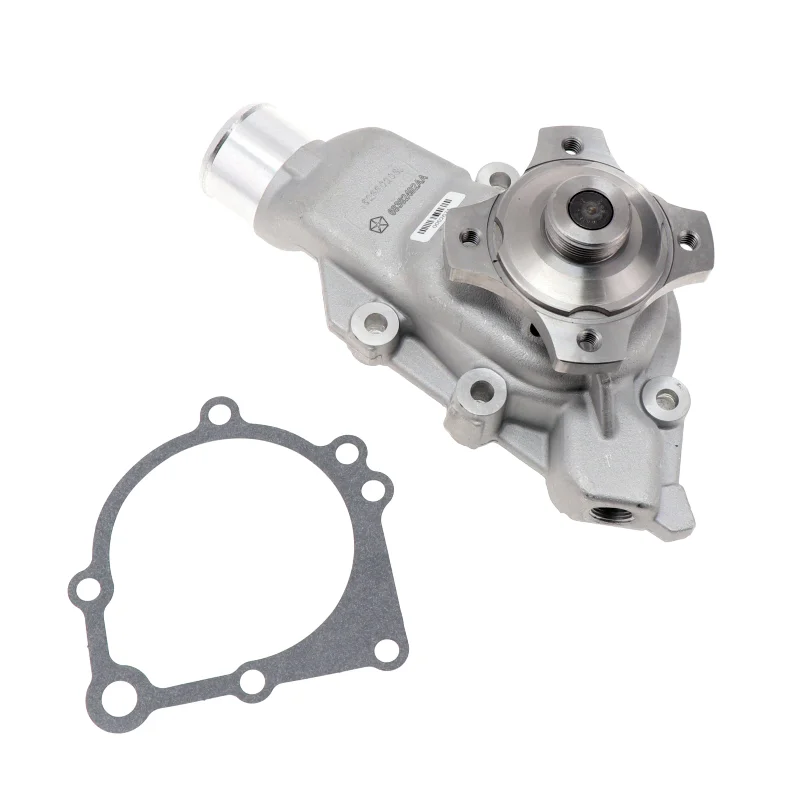

Thank you so much!! That really helped clarify my confusion. I don't mind the higher price if I can get many years out of it. I'm very nervous on the choice as I plan to drive the Jeep off road in California mountains/desert and do not want to overheat. Thanks!
I have had one of those on the shelf a few years. Haven’t driven the Jeep much so I have not installed it, Aka I can’t speak to its quality/longevity. BUT it was for a sure a different part than the cheap old AF number I had been using. I compared one of those to a parts store and they were exactly the same. Been several talks on the other forums about that.
I have a hunch that Mopar saw the complaints about water pumps and how many people want to keep using genuine parts so they rereleased an OEM quality option again. So I’d for sure give that one a shot if you can stomach the $200.

I think I have the 04626054AF, which I put in about 10 years ago. Was super skeptical when I got it, the housing looked just like the cheaper auto parts store ones. House inlet wasn't machined smooth. I ended up running it though, no issues so far. If there's a newer version though that looks like the original I probably go with that though.
Mine died in like a year. Could be misfortune I guess, but I was irritated. Ended up using a $30 Gates from Napa. It sucked also, it’s making a bearing noise by now but I’m not driving it so I haven’t messed with it. Definitely curious to see how the new part number goes for me once I install it and hit the road again.

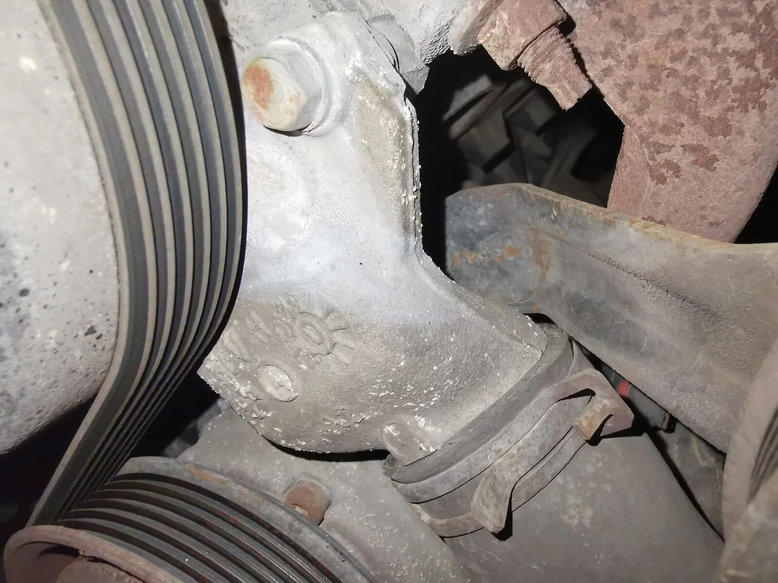

I was about to order the OEM 68382489AA, but the dealer can't verify my VIN for fitment. I've had that issue in the past and if I try t search on moparfactoryparts.com with it I can't get results either.
My VIN is 1J4F459SX1P304875 and it's a 2002 Sahara 4.0 Right Hand drive in Thailand.. probably made in Malaysia. I guess the confusing thing is that it seems to be a 2002 VIN but says made in 2001?
It also says on moparfactoryparts.com 68382489AA wont fit a 2002 TJ, but 68382492AA instead? How do I figure out which one fits, if nobody can verify my VIN? Also sometimes there are right hand drive versions of things, which could be a show stopper.
I don't have any local Jeep mechanic I could ask.. since Jeeps are not sold in thailand, only imported..
I can only see that part below, since the part number is behind the pully which would mean a lot of disassembly...
googled a picture of the older (68382489AA) and the newer one (68382492AA).. and just checked.. mine is all straight on the top side (68382492AA), while the old one has a curve (68382489AA)
can somebody confirm?
