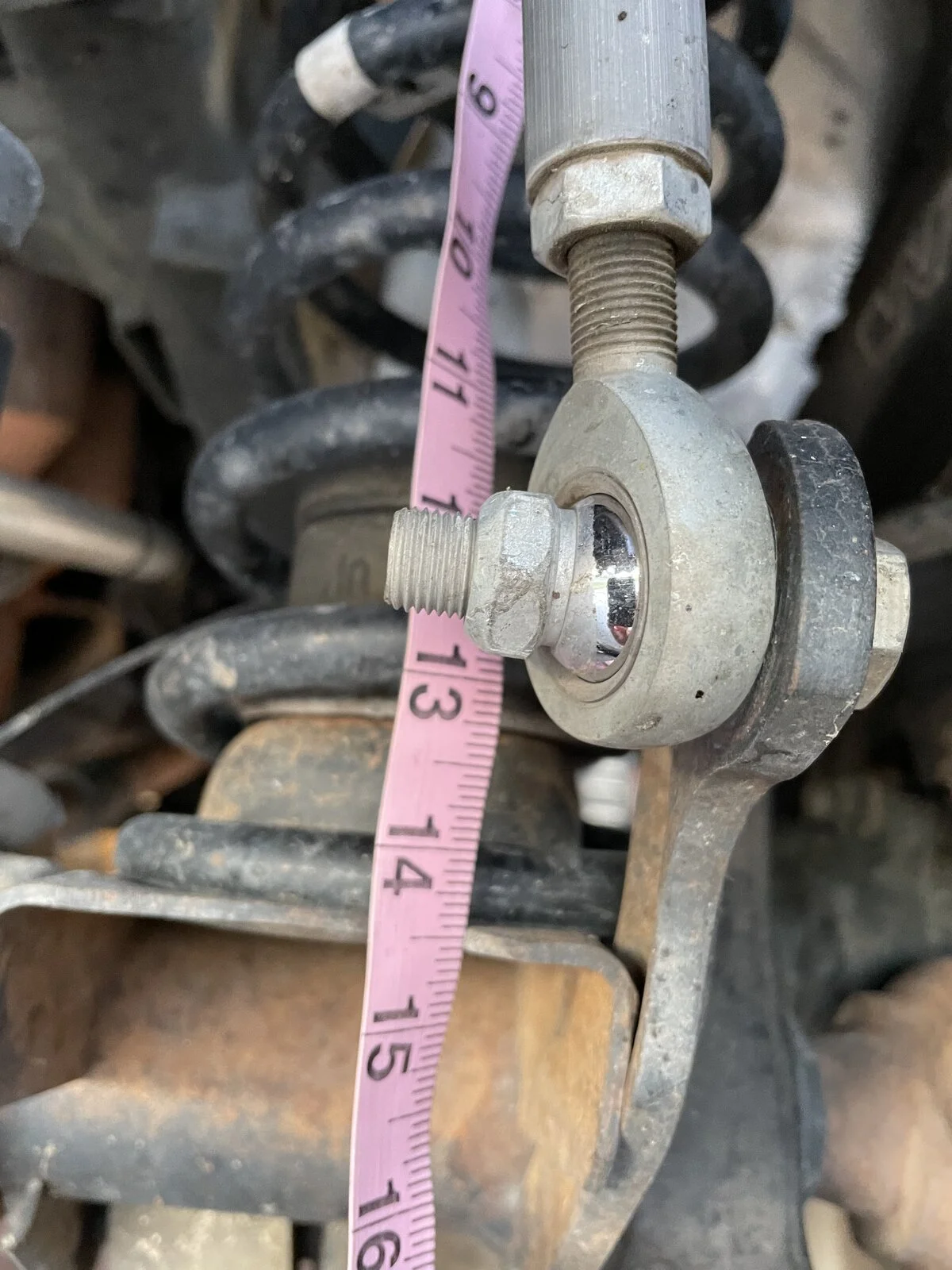

With about 2.75” of front lift, my Jeep has ~20” from shock mount to shock mount.
Thats weird. But I can confirm my number by one more measurement. The amount of up travel of the front shocks.
5.7" (up travel) + 13.05" (compressed length) = 18.75"

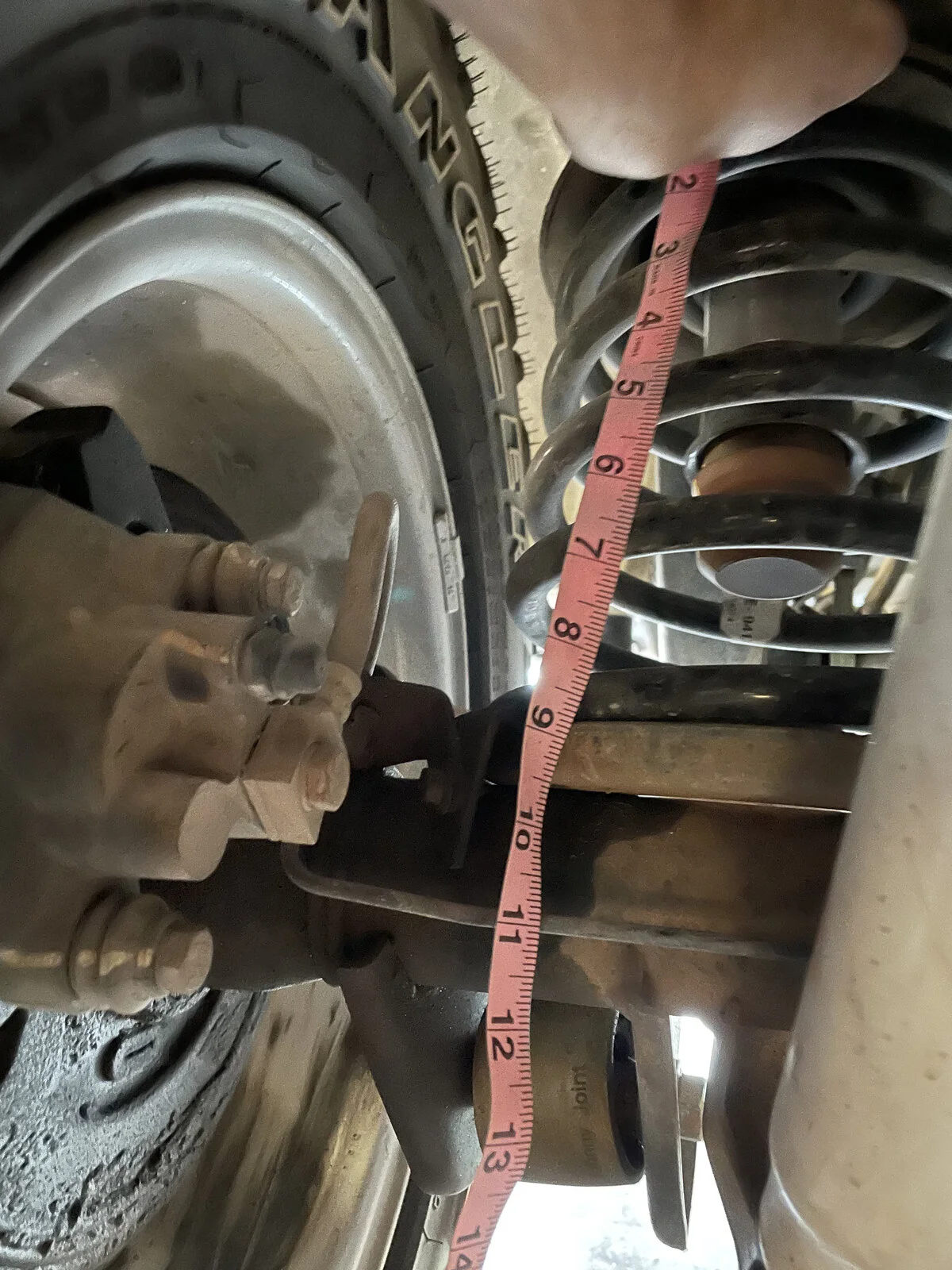

Have you measured how much lift did the springs actually give you?
Stock measurements are 12" front and 8" rear. (For Springs)
I ordered 3" JKS springs and 239/241 Ranchos. I'll measure when i get them on probably sometime next month.

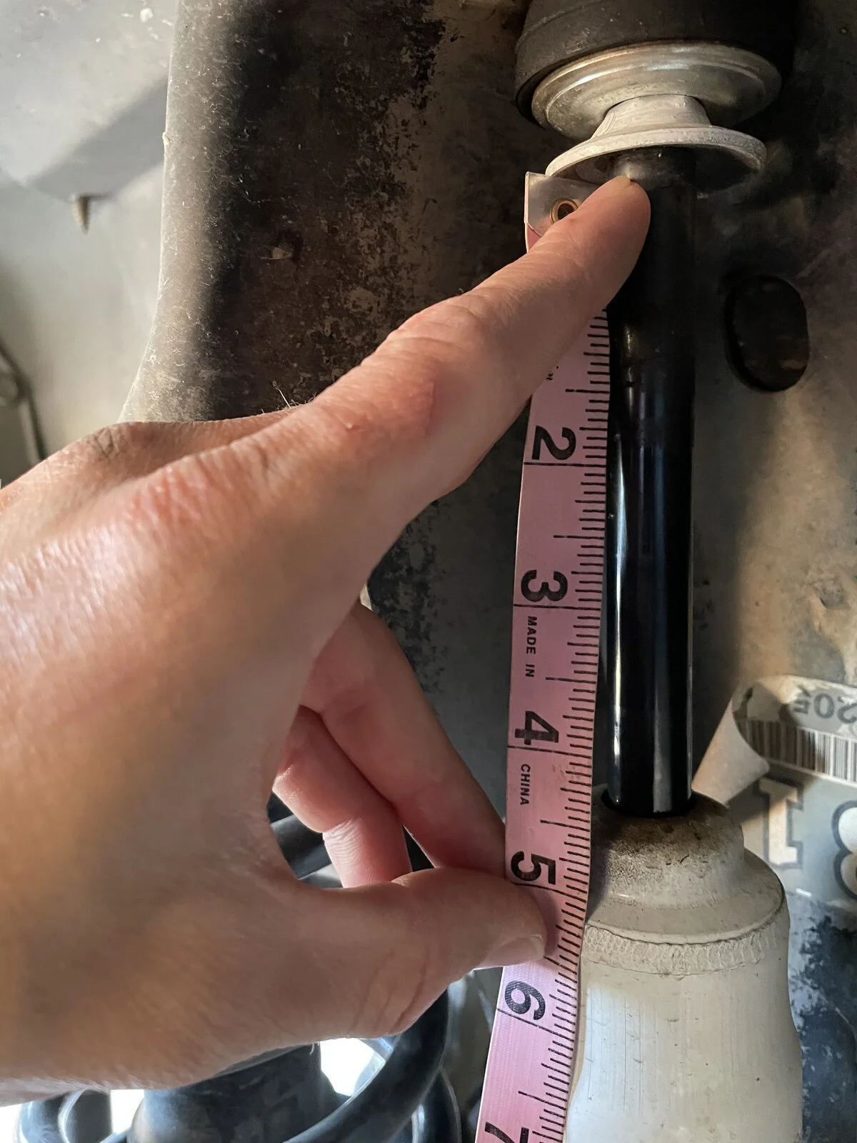

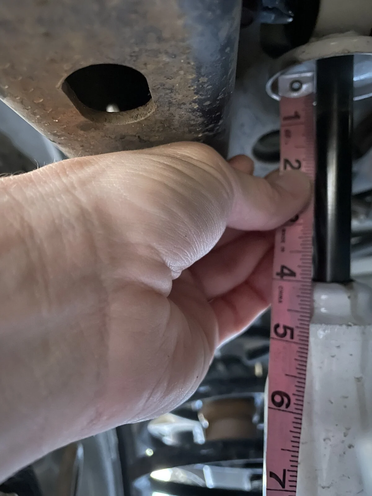

I ran into the same problem with my shocks ended up with 239/241 ranchos pics for real world
Rear shock at ride height about 4” shock shaft rancho 241
Front shock 4 1/2” shock shaft rancho 239
Front spring about 14 1/2” so about 2 1/2” of lift front
Rear spring about 9 1/2” so about 1 1/2” lift rear
