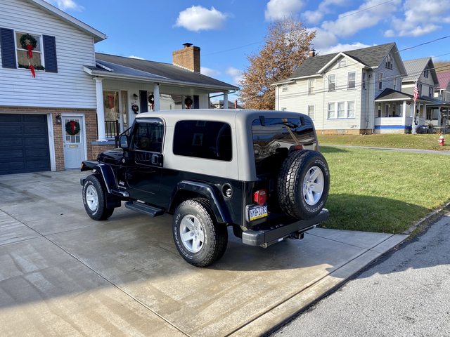

Congrats on the Jeep. Start with a 2" lift and 31s. Within a couple of years you will be on 35s and broke. I'm on Jeep #19 now. It's an addiction and there is NO CURE!
p.s. My first TJ pictured. Notice the dates between stock and 35s.

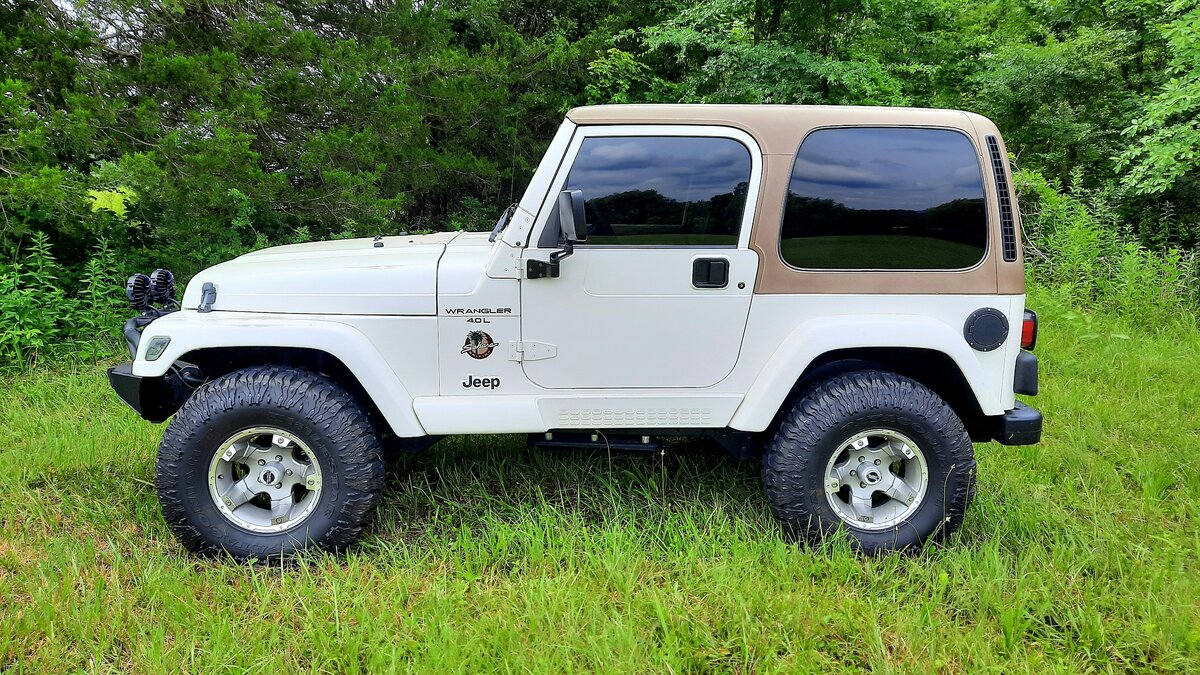

First of all congrats man, I bought my TJ as my first car 3 years ago when I was 17 and I can tell you you're in for some fun times. I've been running 31's on a 2 inch lift since I bought it which is the perfect size for the lift, although you'll never be satisfied with your tire size lol, I'm moving up to 33's soon enough. Enjoy the Jeep.

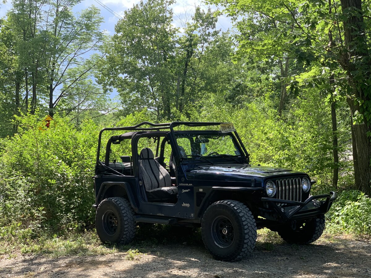

My jeep had a 2" budget boost lift on it when I bought it and I added 33" tires. Its my daily driver so I don't do any rock crawling or mudding but I do take it off road on trails and no problems with rubbing.

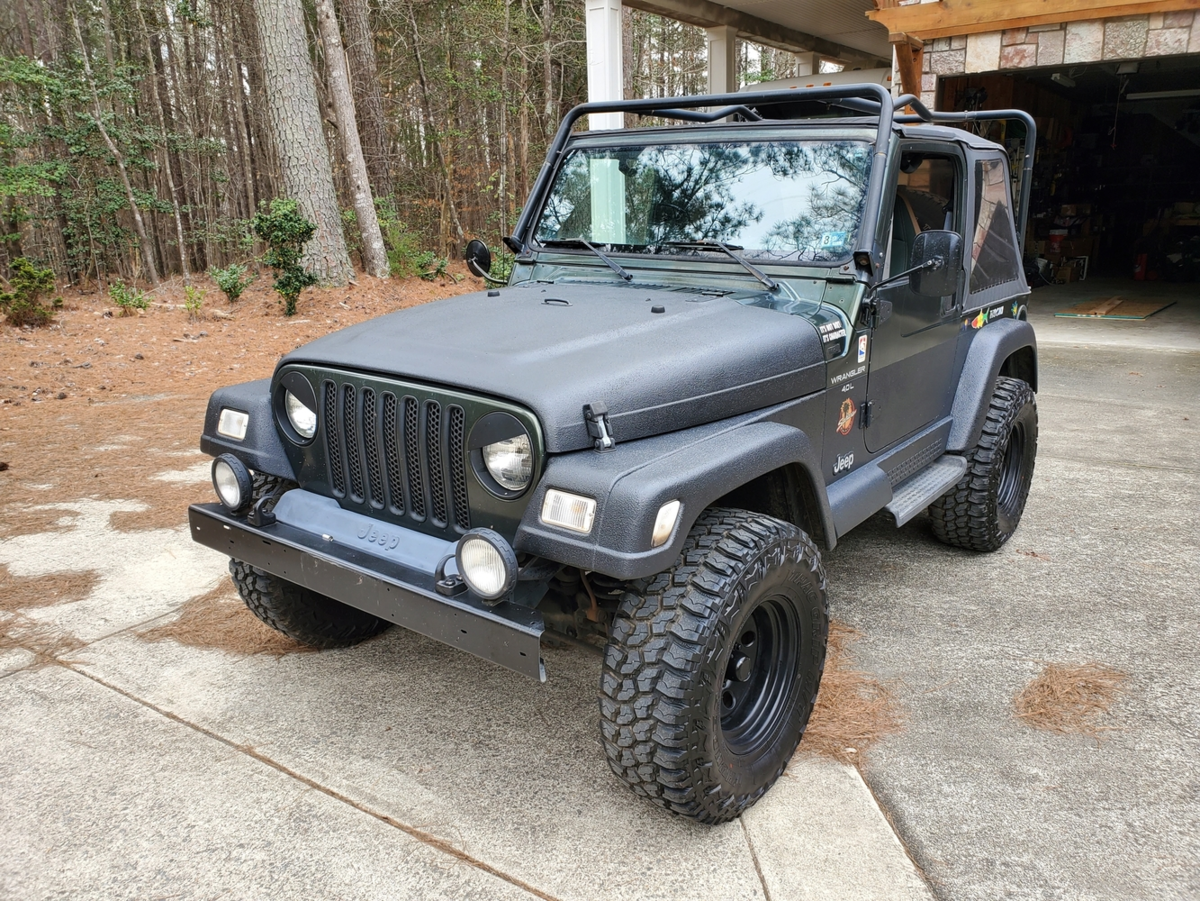

I have 2" lift with 1.25 BL with 31's. I would like to get 33's but it's a dog on the hills on the freeway as it is, LOL. I don't want to re gear anytime soon, so will stick with the 31's for now. May try 32's later down the road if I can find a set for free. LOL
I love the way that sits, I've been generally shooting for the same thing, I've got 3 inch coils in front and 2 in the rear with 33s, also no tire interference anywhere.

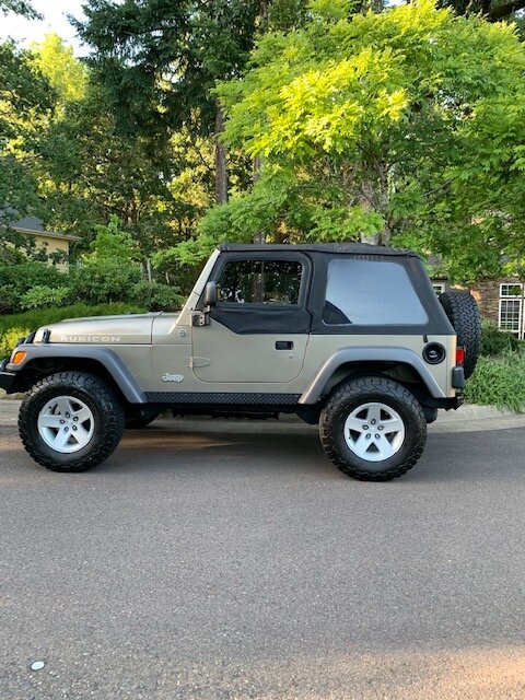

Here’s stock height, flat fenders and 32s. If you don’t plan on getting off the road much this isn’t a bad look. Although I have an 1.25” body lift waiting to be put in, and am saving for a 2.5” Old man emu lift. Gonna tuck some 33s after that and call it a day.. Until I get bored of that too after a year.
