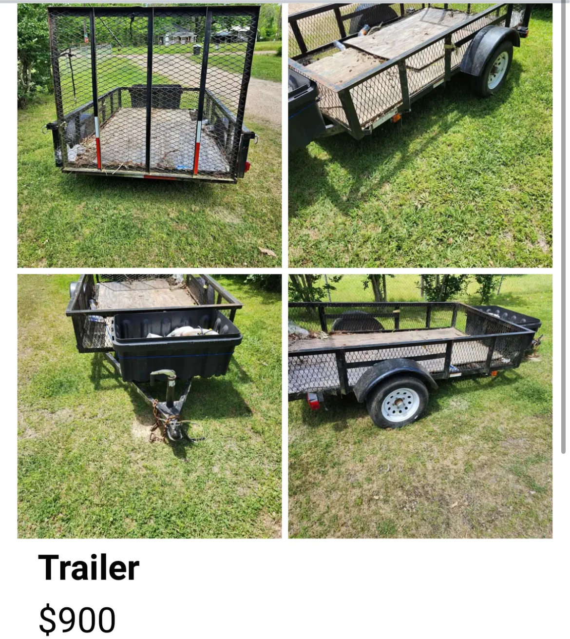

Thanks for the guidance, everyone. This one on FB marketplace looks promising and is nearby. Seller says title in hand. It has the mesh wire floor, meaning it’s relatively light. Looks like it doesn’t need too much TLC. I’m not familiar with trailer axle manufacturers, so I’m not sure what to look for there. The price is competitive based on all the other listings I’m seeing. I may have to go check this one out!

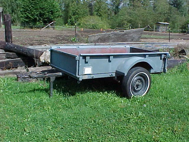

This was my grandfathers trailer that he towed behind his flatty & then CJ5. It tows great behind my TJ. Has a straight axle and uses 5x4.5 bolt pattern wheels.
It might not matter now but having a the same bolt pattern as your tow rig can be nice sometimes.
