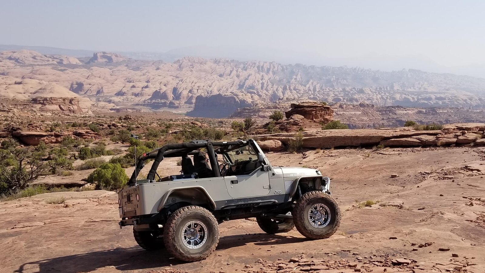

It’s a Dana 60 up front, and a full float, 35 spline 9” in the rear. Clayton 4” long arm plus a 1” body lift. Genright armor and fenders. Kinda wish I went hiline fenders as it’d make the upgrade to 40’s easier, but I may stay at 37’s As it works pretty well as Is.
Not sure, maybe it’s the difference in front bumper size?
I agree with this. My Jeep took on a whole new look when I ditched the full width bumper for the Warn stubby. I probably wouldn't have done the MCE fenders if I'd had the bumper first.
Great looking Jeep and why did you quit working for Howard Stern? (AKA Bababooey)

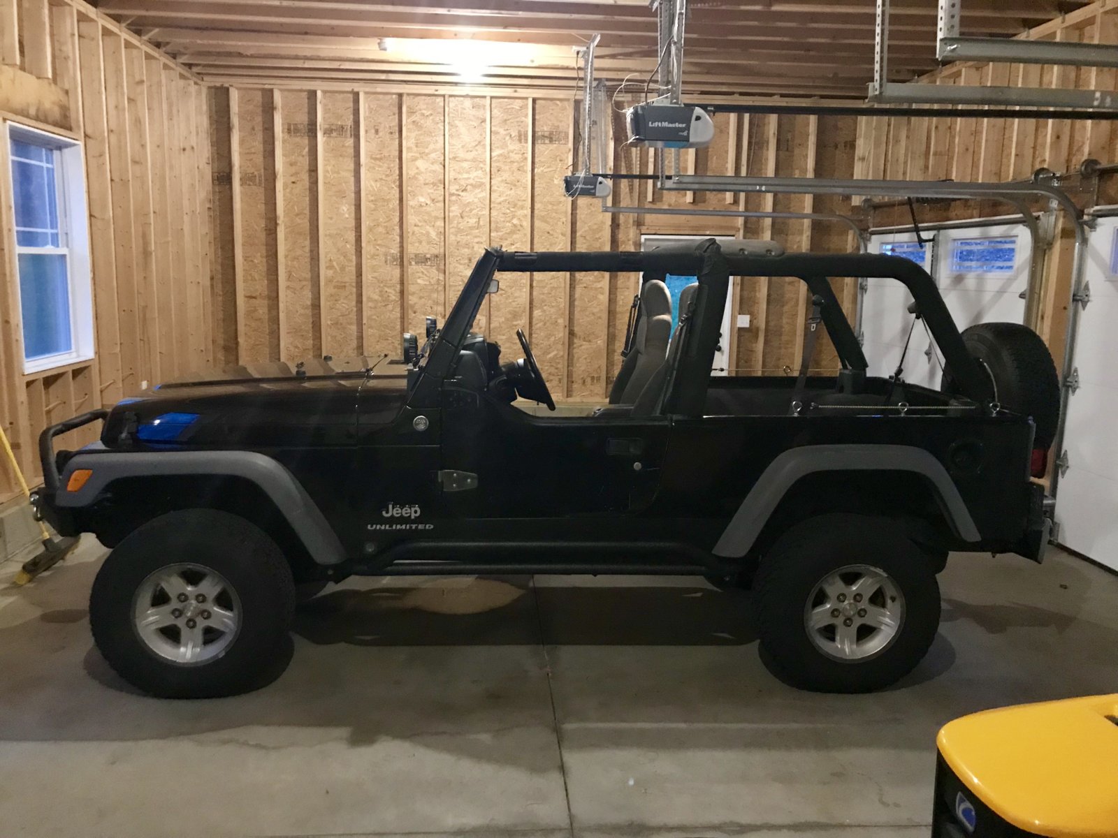

So would you guys go 31 / 32 / or 33's on this LJ?
Currently has a 2" OME lift with 30" tires. Willing to add a body lift to clear 33's if needed.
Honestly it's really just an esthetic thing for me, as even the 30" tires do what I need them to.
But the 30's just look too small with the lift on there.
33's for sure. I really don't think they start looking awesome till you get to 37's, but being where you are, 33's.

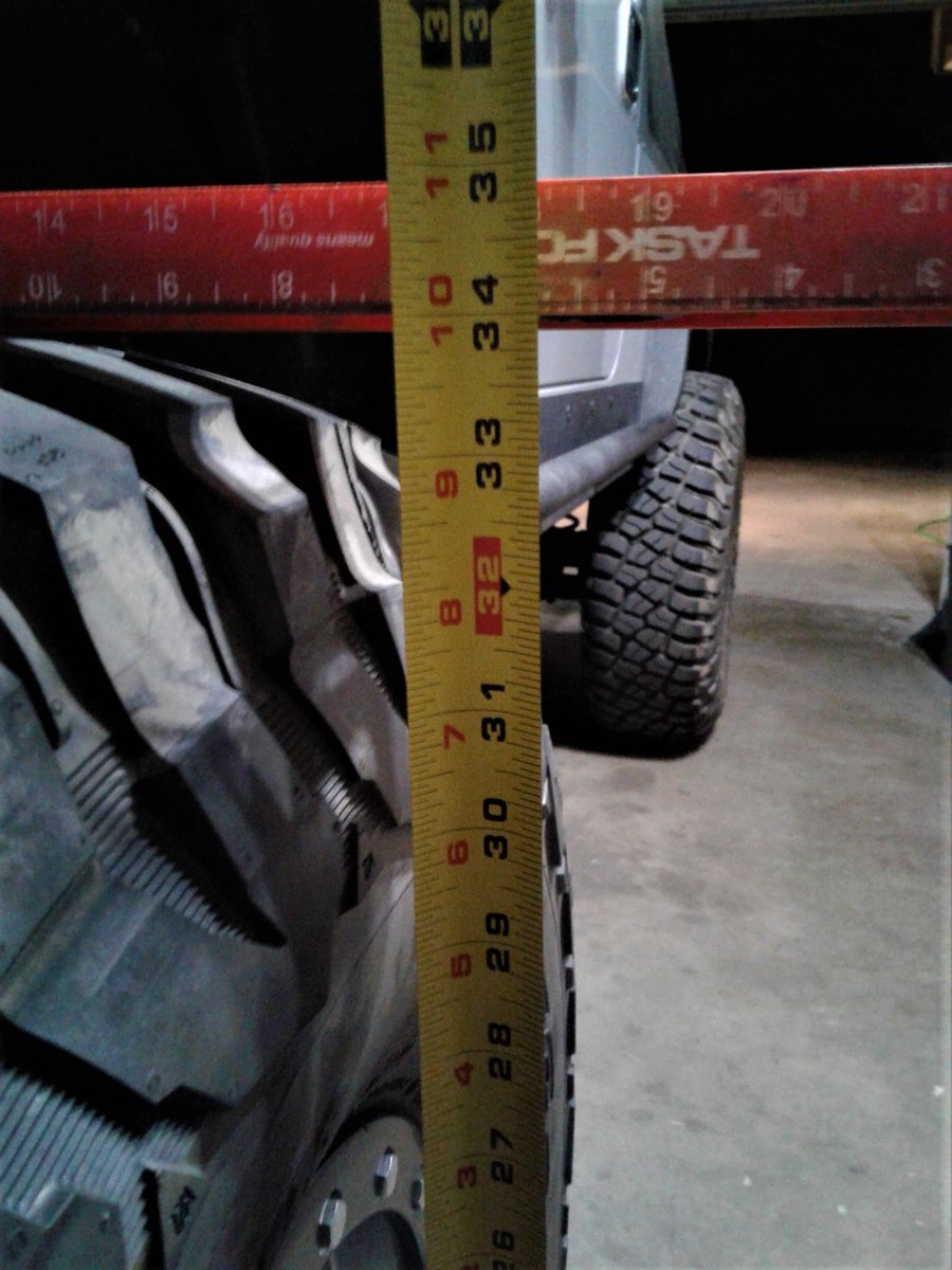

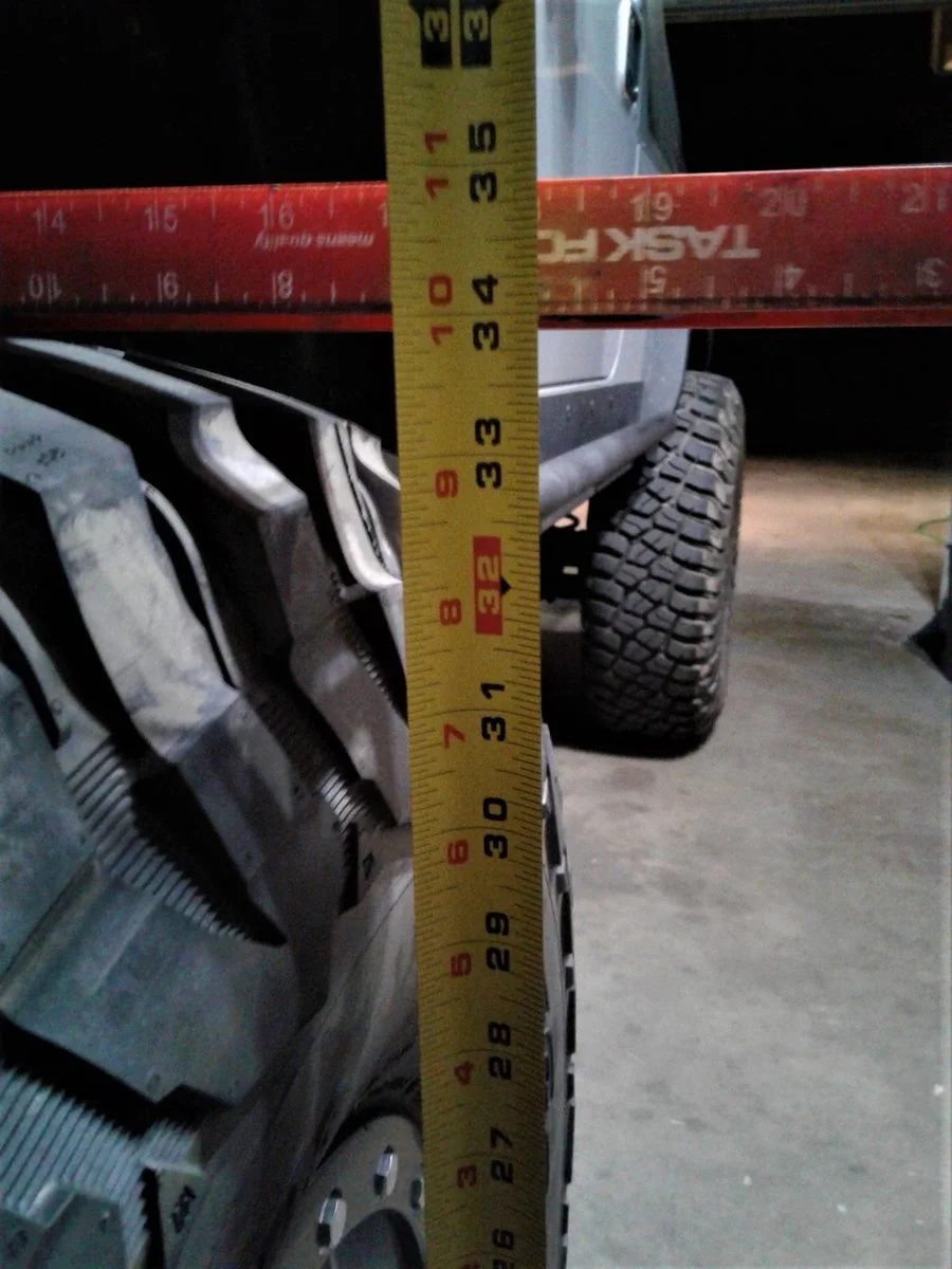

Yep. 35/12.5/15 BFG KM3's, right after mounting them.

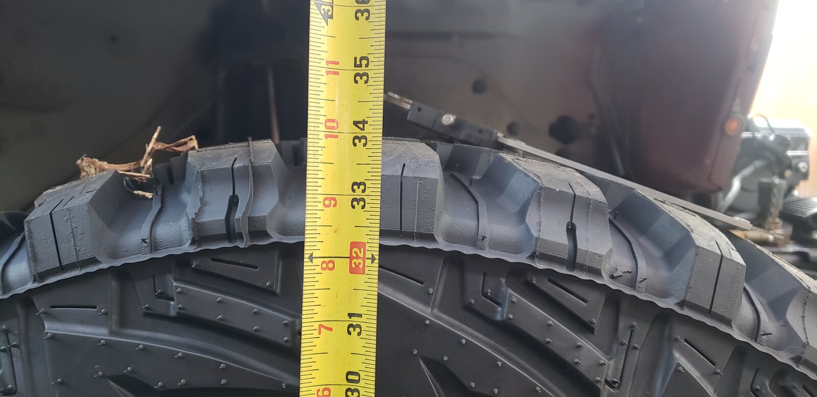

This is a personal pet peeve of mine everyone always talks bad about BFG’s saying once they are on a vehicle they don’t measure 35”. (Edit: Not saying you are or calling you out, it just seems like I see this on forums all the time, just quoted you for reference)
@jjvw just posted a pic of his brand new MTR’s and they are not 35” either.
@Alex01 measured his recently and they weren’t either.
Does anyone actually have a tire that measured 35” once mounted on a wheel, that is advertised as a 35? Seems to me they all measure 34ish inches.
And when we are talking on a forum saying “do this much lift to fit 35’s” we are talking about tires advertised as 35” not literally 35” when measured on a vehicle.

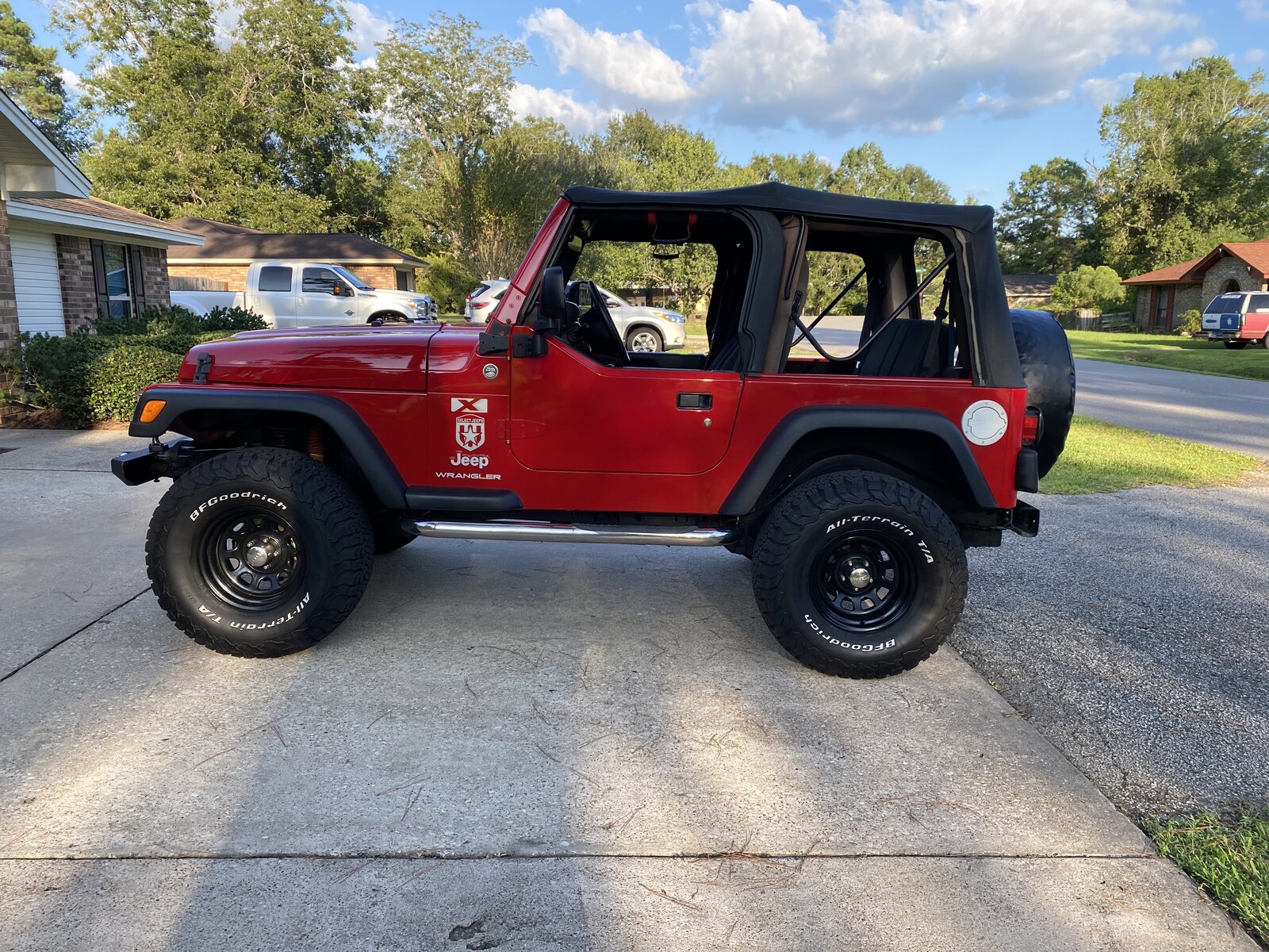

Here’s what my TJ looks like with 12.50/33 BFG All Terrain T/A KOs on 15”/10” Dick Cepek steel wheels & 3” (or maybe 4”) skyjacker lift. This is the way I bought it 3 weeks ago.
‘Hope this helps you decide.

That's a beautiful Jeep. Please get rid of the white gas cap cover or paint it black with SEM Trim. That would really make your TJ!

Do you have a photo of them mounted on a Jeep with a tape measure on the side? That’s the measurements everyone is always bad mouthing BFG about.
It’s just a pet peeve because I have not personally seen a advertised 35 when measured that way that is not 34ish inches. I just always hear that BFG’s are tiny look at this. MTR’s are a TRUE 35 but as seen in this thread they are both 34ish inches.
Not saying you are or calling you out, it just seems like I see this on forums all the time, just quoted you for reference.
Nothing taken personally on this side at all. My point of showing the measurement was simply to show the actual mounted height of the 35" KM3's. If anything, just a basis as which to compare other similar size tires.
