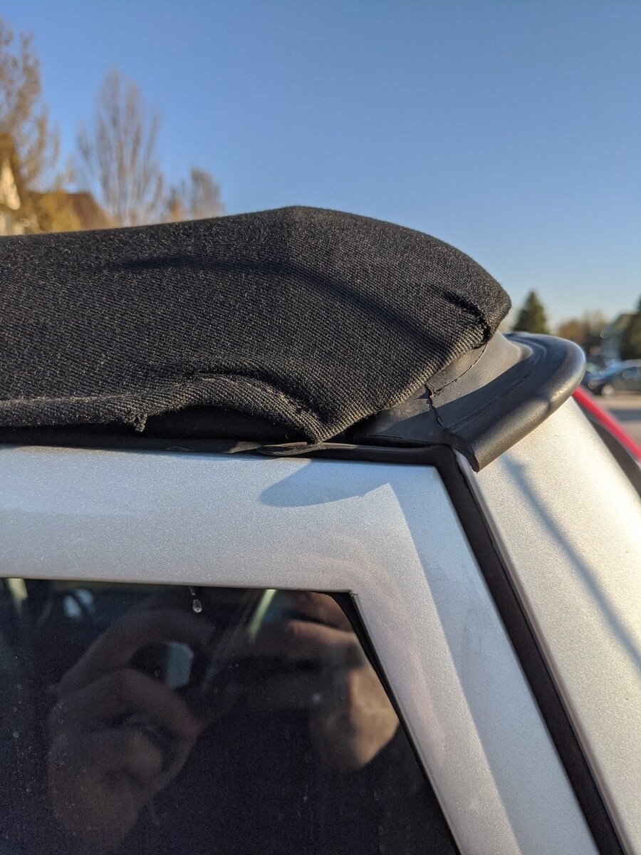

I bought the one that doesn't use the factory soft top door surrounds. Not intentionally, but I did. With this style, they have it so that the material wraps around the rollbar and joins with velcro instead.
Unless there's something I'm missing, there's so much excess fabric at that spot, that I can very easily slide my hand and arm into the extra space. Since it is that way, the top fits very very loose across the top, creating 3-4" rolls in the material. Which puddles and funnels water.
So many issues. The headerbar and the top's strap placement are two other issues. Mind boggling really.
The stitching on the top, passenger side is loose enough to allow a standard flathead screwdriver to freely slide into the gap.

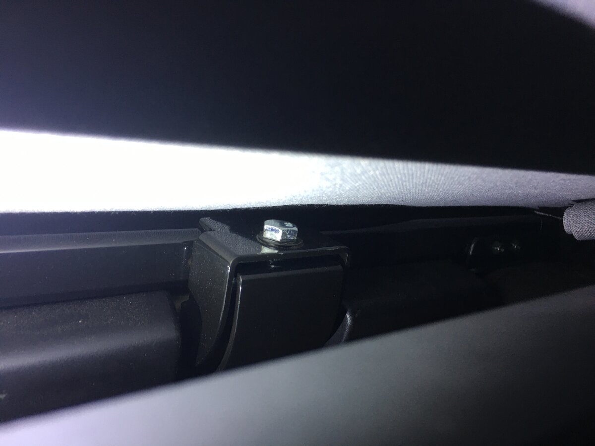

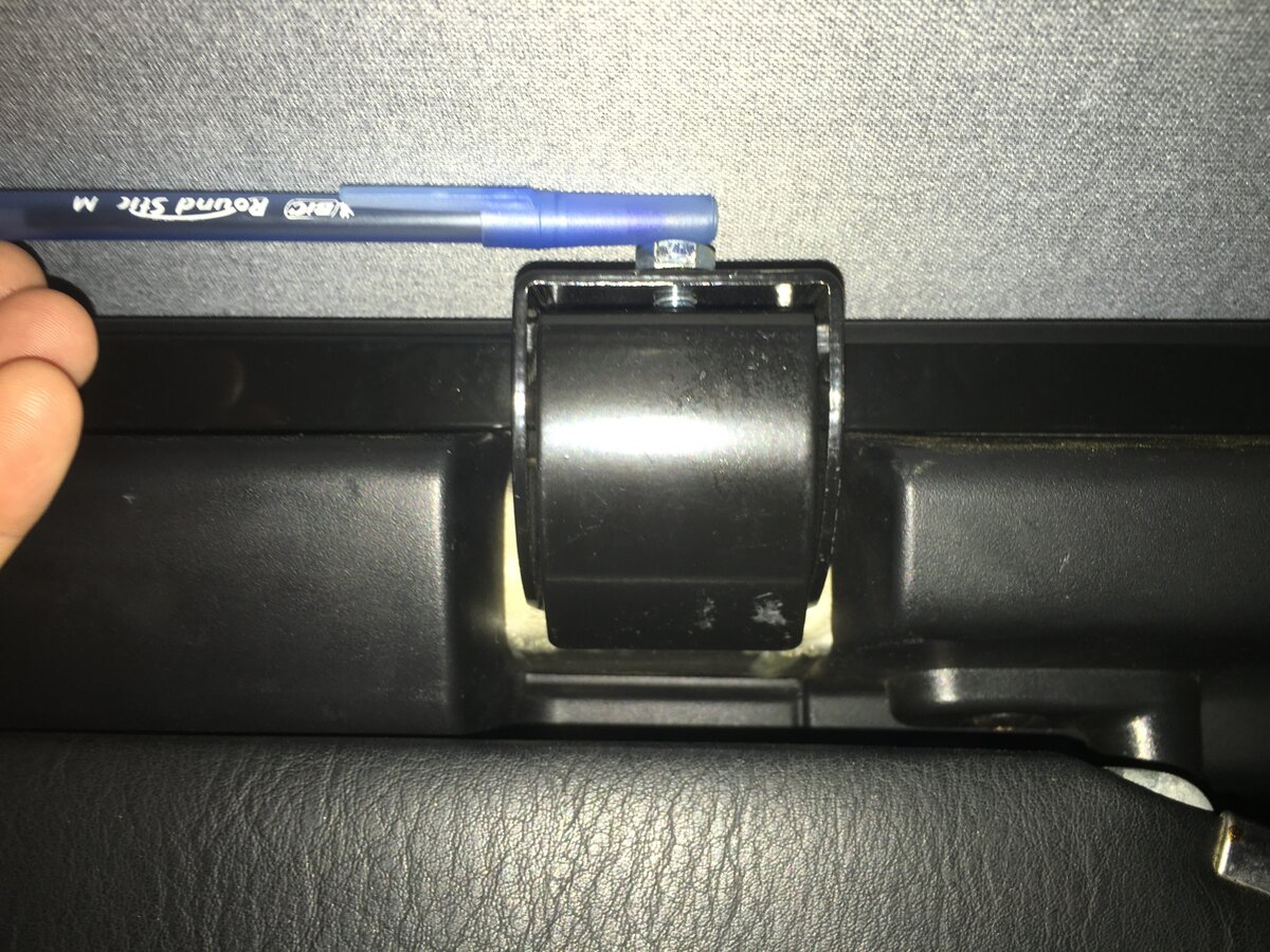

Oh yeah, here's another oddity.
From what I read online, they (bestop) recommends for the headerbar to be "rolled" as far forward as possible, so as to not have a huge gap between the headerbar and the windshield header seal.
One place that I read said the bar is designed wrongly, and doesn't fit the windshield correctly, but that I'm not sure about. I am sure that it may be next to impossible to mount it the way they recommend.
That aside, if it could be "rolled" forward as far as it needs to be, the would raise the backside by about half an inch to one inch. That would have the bolts pressing very firmly into the fabric.
This is how close the bolts are with the bar mounted as it is seemingly designed to sit, leaving a large gap over the seal.

Your top doesn't have the parts that clip into the door surrounds?
Mine can be clipped into the surrounds or wrapped around the roll bar if you don't have the surrounds installed. I have mine clipped in and the extra fabric rolled/folded up and tucked up above the surrounds. I can easily get my finger in-between the bolt heads and the fabric. I'm using the door surrounds that came with my Supertop NX and I'm using the cross bar that goes between the door surrounds, that might be why the fabric isn't close to my bolts.

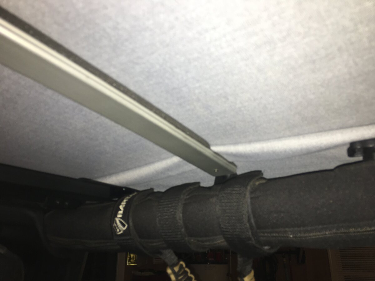

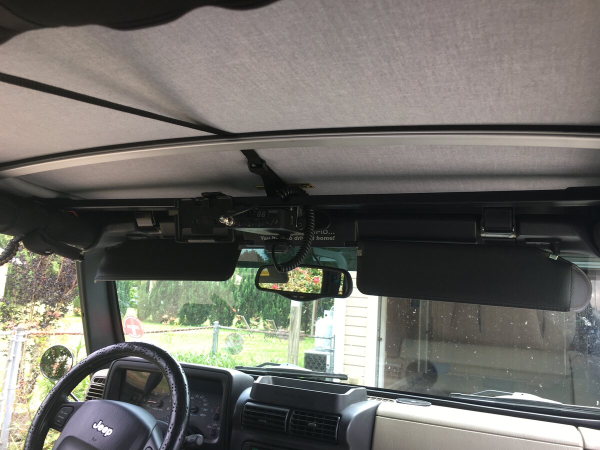

I had eliminated the aluminum bar over the driver and passenger due to excessive rattling with and without the top on & didn't quite understand the purpose of it... unless its to prevent rain puddling in a few years with the top sagging?

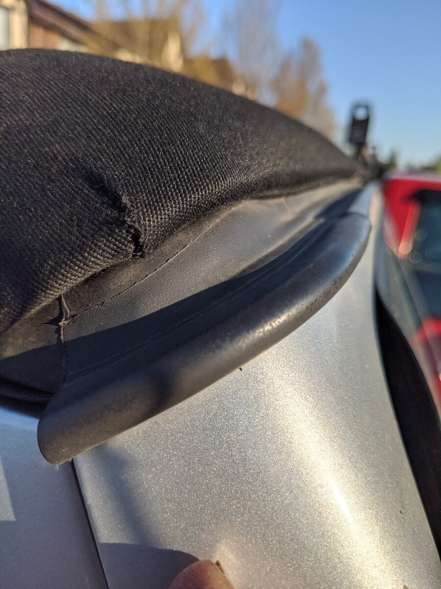

My header is made from plastic and warps up away from the windshield at the edges (twill supertop nx) my tops a bit short but expected some stretch over a year but hadnt done so, bestop is sending me a new top and header bar.
heres my gap currently.
on the other hand though, customer service is very responsive and has assisted me in the past basically no questions asked and have yet to be charged shipping or parts
your header bar clamp bolt looks like a carriage head style bolt would be a good candidate for swapping .

Not that I'm aware of. I'll take another look today and see what I can see. Does yours have a strip of plastic in that spot, like the front has for the headerbar?

I was wondering about the aluminum bar in MountaineerTom's picture. Was this something that came with the top you both have? Mine didn't come with one.
They are carriage bolts. Them using those had me scratching my head a little too. Since the bolt has to be installed from the top, there's no other route to take though. Since it has to be tightened using the head of the bolt.
No bolt that I'm aware of anyway.

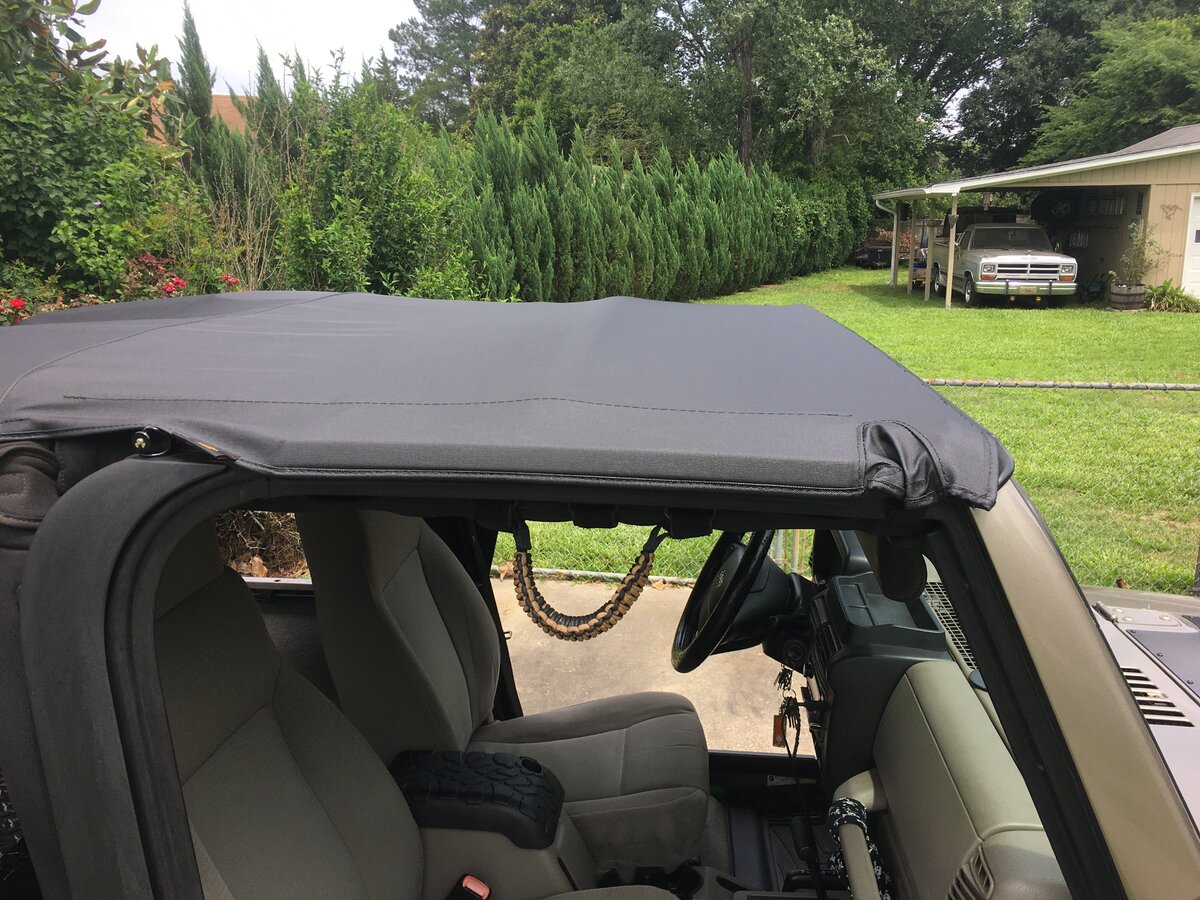

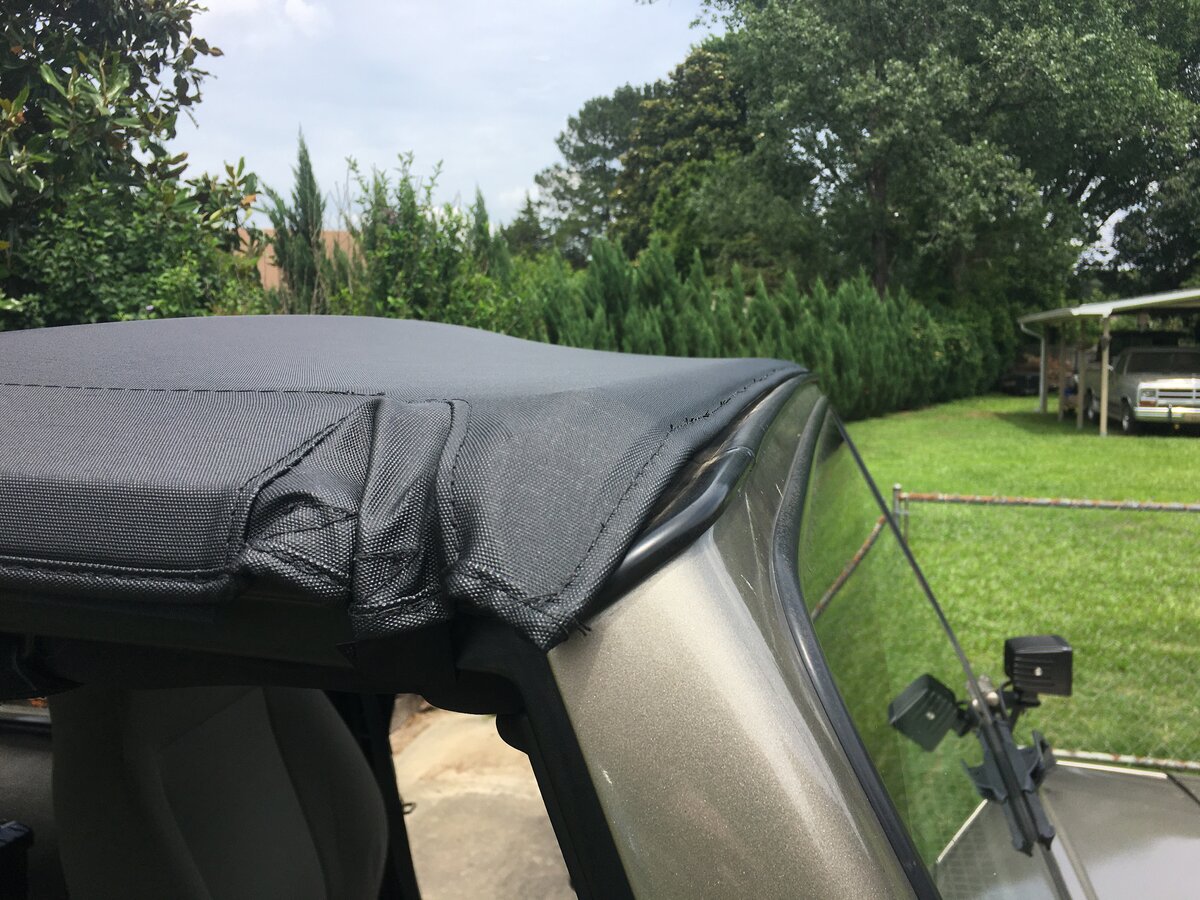

Here's the gap in mine. It clearly needs to roll forward quite a bit, but it's design doesn't allow it.
Turns out that it does have the ability to fasten to the door surrounds. Thats a relief.
Pulled the surrounds out of storage and got them on.
I'm not entirety sure of my plan or my origami skills for the wad of fabric in the corner, but atleast there's some headway made.
I read online where some were saying that they had a really hard time snapping the sides into place. One even mentioned trying to use pliers, and eventually tossed the top in the trash. Mine wasn't difficult at all. It could be a one-handed job. I remember my factory top was a little like that, but that was a good thing.
Here's mine after I got it into the door surrounds. Plenty of room, so long as the headerbar sits with a large gap in front.
my bestop supertop nx came with the aluminum bar, but i dont fully understand its purpose other than creating additional noise with or without the top up.
My Supertop NX came with the aluminum bar too. It’s purpose is to support the top in that area to prevent water pooling as far as I know. If I drive with the a/c on the recirculate setting and all doors and windows closed up, it balloons the top up and it doesn’t even come close to touching that bar. I decided to leave the bar in place when I put the safari top on to make it tighter and help with water pooling, if needed.
@03coloradowrangler , it looks like your header definitely needs to roll forward. Mine has almost no gap between it at the the forward bead on the rubber seal.
I think you’d have to make that upper hole on the bars let a square to get a carriage bolt to work or else it would just try to spin when you tightened the nut on the bottom.
@bedhed , in your first picture it almost looks like your top isn’t inside the channel of the header, towards the middle. It may be where the header just needs to roll forward more against the bead of the rubber seal. I can’t tell for sure.
The folds of fabric on the corners were a little tricky. I tried to fold them with them front part laying over the rear, if that makes any sense. Think the most aerodynamic way of doing it.

Hm. I'm not really sure why the safari top doesn't come with one the aluminum bars then. That's not a big deal though. I think I have a couple strips of aluminum flat bar that I could make something up with.

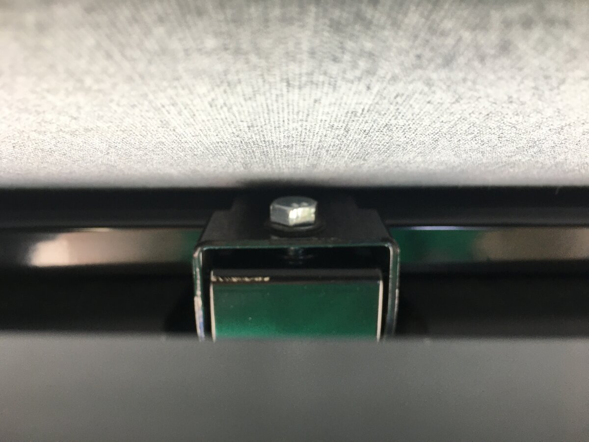

Does the NX top have a header bar that comes separately? With this one, I'm not sure how it could be rolled into the right position, tightened, and it not naturally fall back into the position it's in now.
This isn't the best picture to show what I mean, but maybe you all can see what I'm trying to describe.
This is with the bar sitting in the position that it naturally wants to sit. With mine, if I roll it forward into a better position, as soon as I start to tighten the bolts, it falls back into the position shown in the picture.
Oh, and this one doesn't use an adjustable nut. The bolts tighten into a rivet nut.
That’s weird. I‘m pretty sure mine came with a separate nut in the bottom. I’ll look after work.
Mine wasn’t quite as close to the bead on the rubber gasket as I thought, but I think it’s closer than what you guys have.
