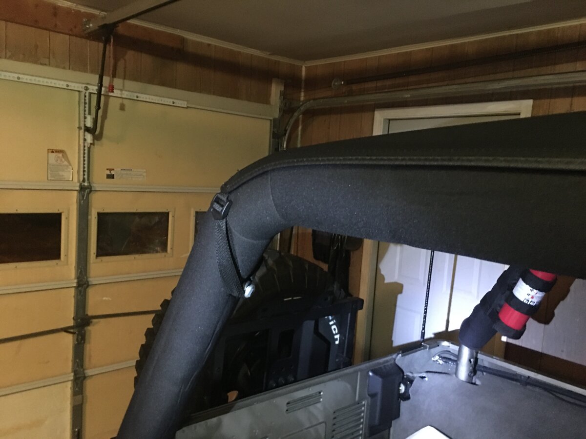

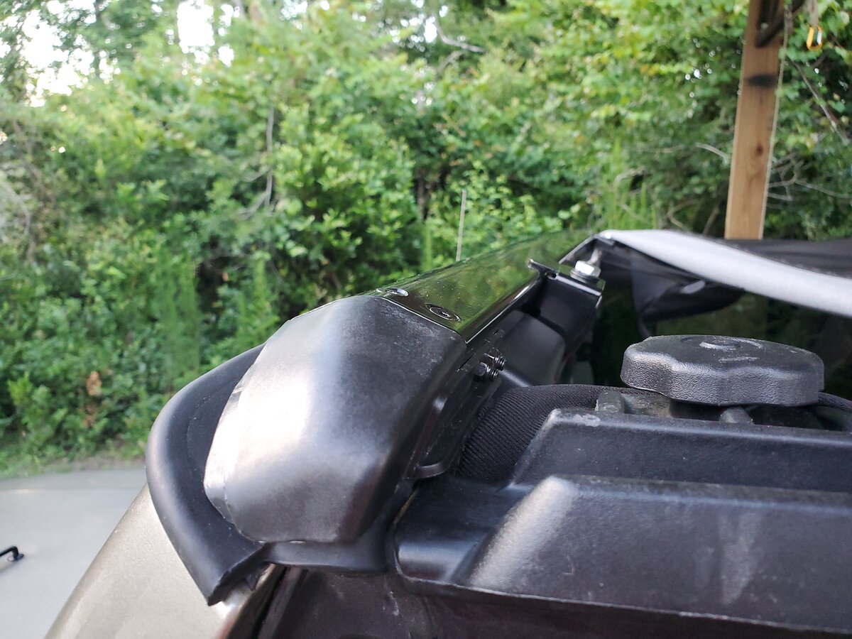

That looks about the same as mine. Here's a picture from a different view.

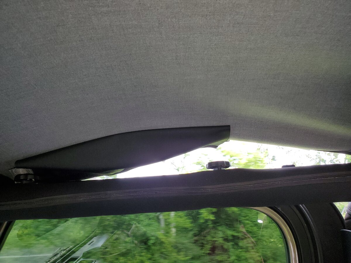

Took a couple more pictures of the inside.
I called and taked with bestop tech support. After sending pictures to her to look at, she said that the header bar is sitting in the wrong position, which I suspected, but she said that the bar needs to be rolled forward and force be applied to the center of the bar while the bolts are being tightened.
I still don't see that happening, but I know of no other company who sells a different one, so it is what it is.
Oh, and she said that it is normal for the bolts to be pushing into the fabric once the bar is rolled forward as they suggest.

Do you have the rear straps wrapped around the upper seatbelt bolt anchor?
Exactly, yeah. I put a bestop bikini top on a Scrambler that I worked on last year and that's the way it was. Attached to the footman loops on the wheel wells.
I don’t have the scrap around the seat belt loop. I started to do it that way, but it pulled downward moreso than rearward.

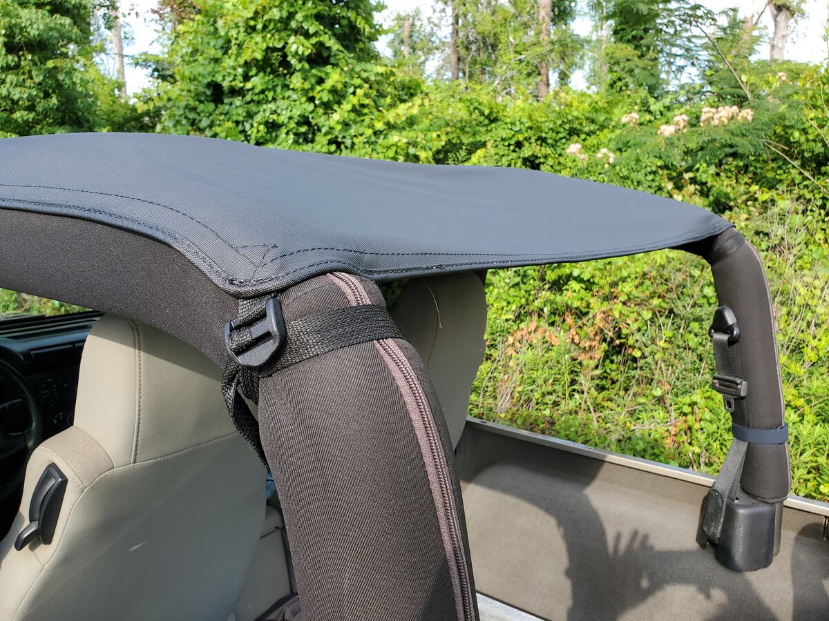

This is how I have the rear straps.
Reactions: bedhed

I took a few pictures of this flubbed up header bar.
This is the position that she told me yesterday was wrong.

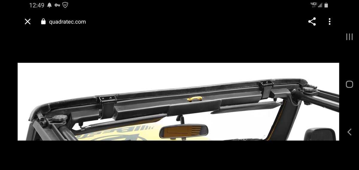

I don’t remember what my header looked like When mounted before I put the fabric on, but it looks like yours doesn’t match the shape of the top of your windshield. Could they have had the wrong header in the box? I wonder if they would send you out a new header to try?
I only saw the one style after I entered in my make and model. I have now seen that they have now made a "Factory Style" that appears to have been done correctly. Atleast partially.

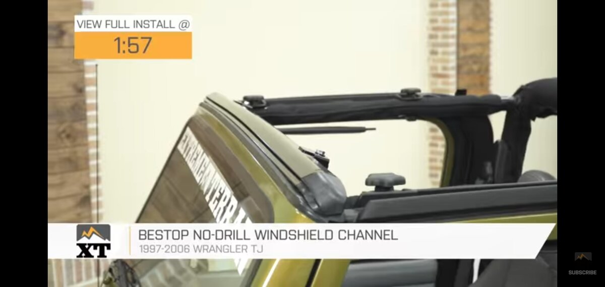

I called back and talked with tech support this morning. He looked at the pictures that I sent over to the other tech yesterday.
What he told me was that the bar won't sit perfectly upright, but the way mine is mounted is too far back and that it needs to roll forward a little, so that the front seats against the windshield seal.
It won't do that without sitting upright, and tilting it backward any whatsoever will cause it to fall back into the position that it's in now.

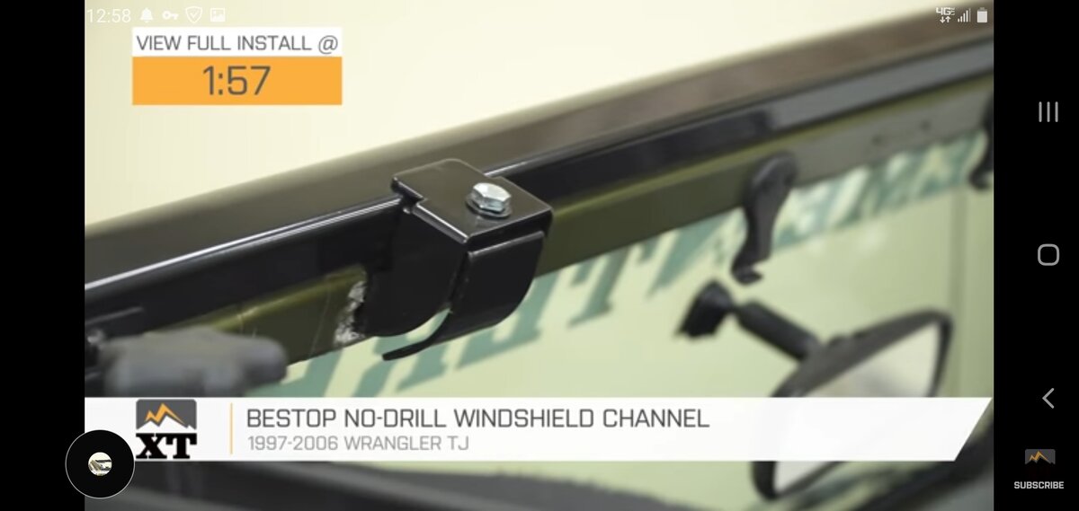

He sent a couple of video links.
After I looked at the first one, I pointed out how mine is mounted the same way as she has done it in the video. In this video, she used no force to roll the bar forward like I was told to do yesterday. I thought that was interesting.
After I pointed that out, he wanted me to watch this one, saying "it is a better one".

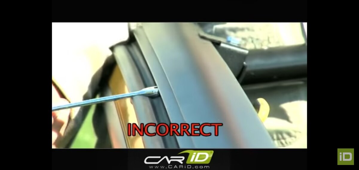

In this one, the guy shows the incorrect way, in the screenshot, but he the proceeds to rolling it upright and flush with the seal while saying that it needs to be that way.
The funny part is that his he doesn't continue the step-by-step install. It stops there and moves on to another year model wrangler.

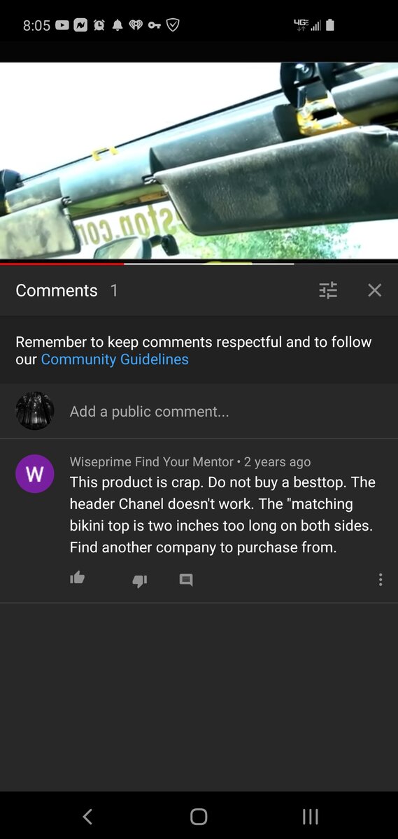

I saw this and realized that I'm not entirely alone in these issues.

the factory style header in the first photo (top) is for the framed style or factory setup. not sure if you noticed but the header has plugs coming out on each end for the tubes to slip onto.
Reactions: MountaineerTom
Ah. Yeah, I did see that in another picture. So I guess that bar is for framed soft tops.

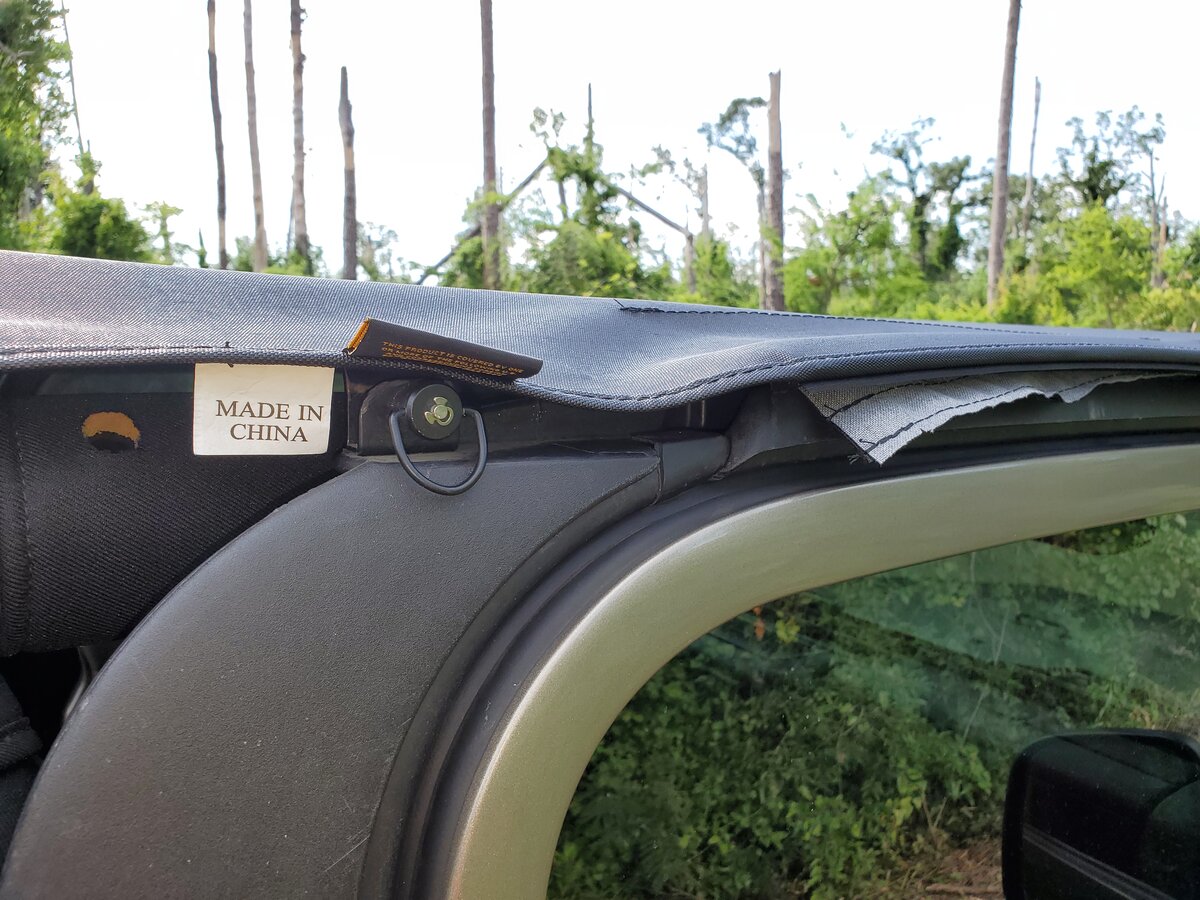

SO, I threw another hail mary. I went to pull the top off and snap a picture to show you what the door surrounds look like, and an idea hit me.
Here's what the factory surrounds look like.
Here's what I tried.
It lifted it enough that it removed the slack and made the sides much tighter to snap in, like they should be.
If I cancel the return, I'll round off the corners of that block so that it's not poking into the material like it is. Anyway, I drove it down the road and the sides never once popped out.
Oh, and I relocated the rear straps to the seatbelt bolt like you did yours. That is better. The whole top now pulls pretty snuggly when all of the straps are pulled.
I'm pretty stoked. Now that just leaves the sketchy header bar, but I xan worry with that later. If need be, I'll get a cutting wheel and welder to it.
