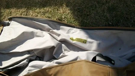

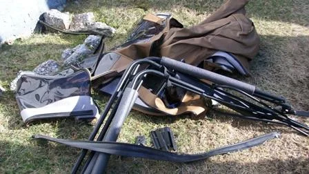

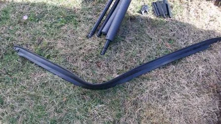

O.K., took picture of everything I have and one of the rubber strip and one of the front of the soft top, it is like a semi-rigid lip.

Ok your TJ came with an aftermarket soft top with one of those klugey "Erector-Set" top support mechanisms. I've only seen those in my worst nightmares, so I'm sorry I can't help you on how to get it installed/erected.
I'd seriously consider buying a used factory OE soft top that includes the OE support structure/mechanism. The difference in what you have vs. the OE top and support is in the degree of difficulty of putting the top up and down with the factory mechanism being easy, yours being difficult. As in a pleasant dream vs. a nightmare. :)
Just an update for anyone interested. I paid a visit to the previous owner, makes sense right? and first off, that long rubber piece has nothing to do with it, which added to the confusion but it's very simple and embarrassing but remember, I have 0 experience with tops and rather than look more dumb than I really am, I'll blame it on long-term alcohol abuse resulting in brain damage. With me being over 20 yrs his senior, he had a puzzled look when he asked me if I took the weatherstrip off the top of the windshield (after removing the hard top) because there is a groove that the front edge of the soft top goes right into. That is done before the support bars get raised. Simple!! and now I know and am excited because it is in brand-new condition, he had it on only twice.:)

X2 to this. That top is not OE and looks pretty crappy. It's free, so at least you didn't pay for it. However, if it was me I would consider buying a new (or used) factory top (Bestop) that comes with the correct hardware.
