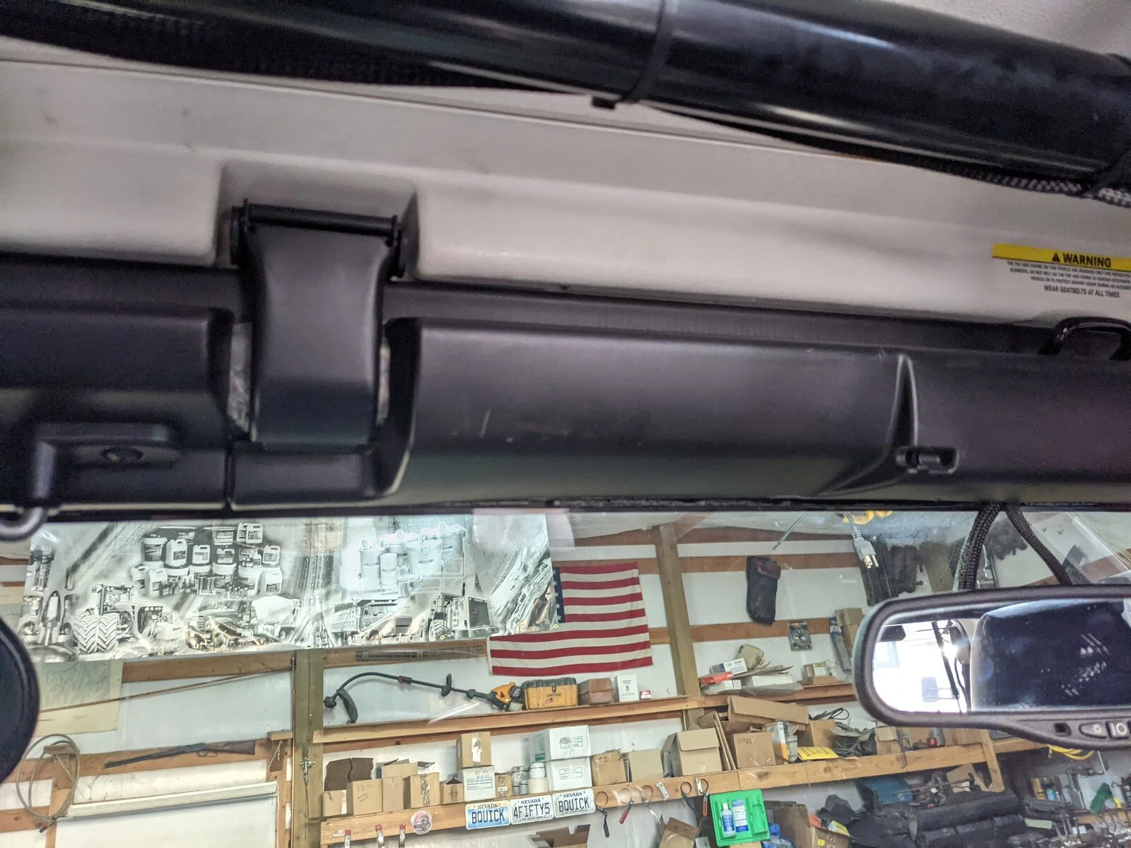

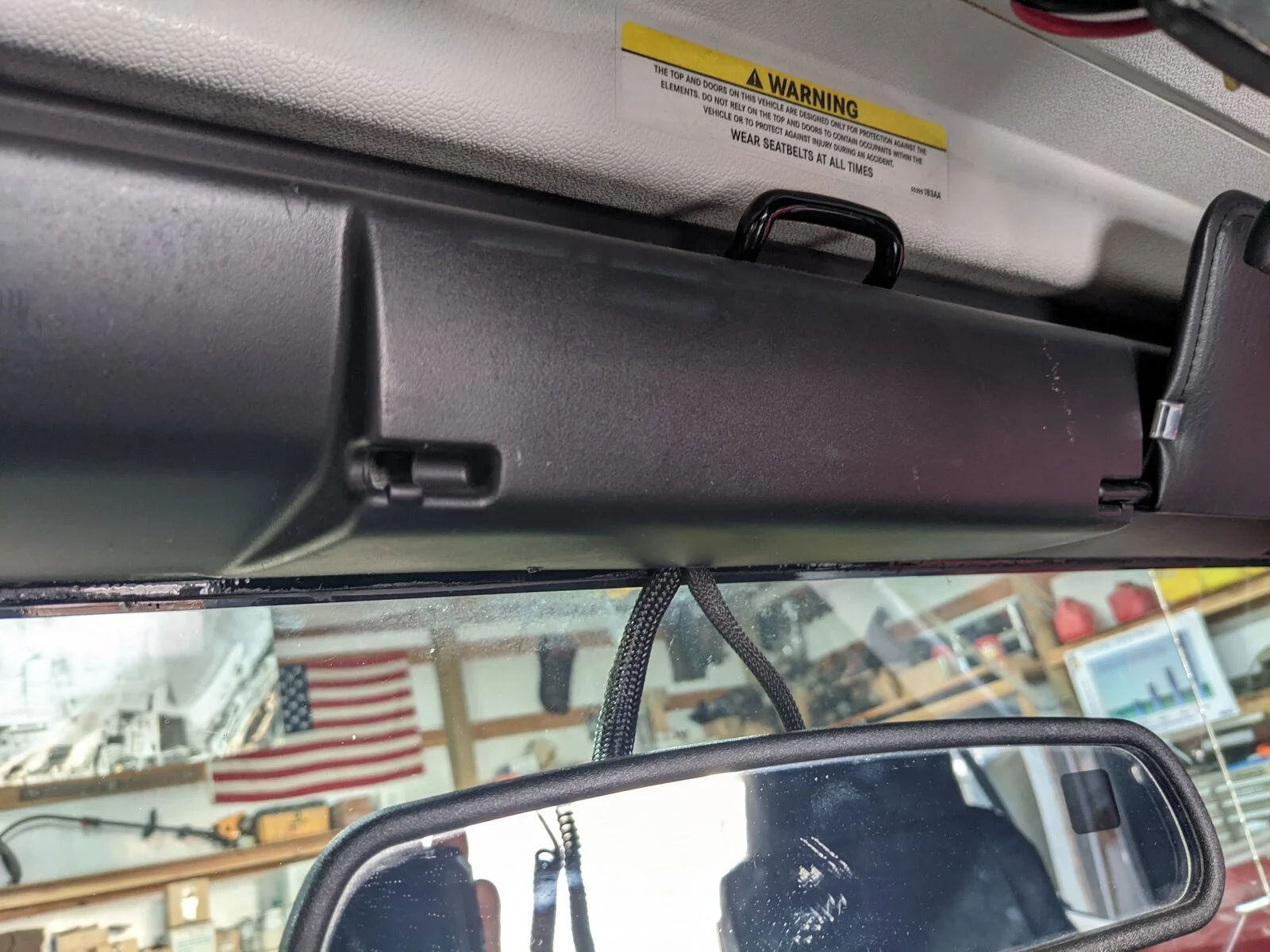

Is this the Bestop header?
I'm having a time figuring out which bikini tops fit the LJ with full coverage. And which work with this header, if that's what it is.
Website says TJ; UNLIMITED.
I'm not seeing an actual header in those pictures. All I think I see, top related, is the white interior of the hardtop where it clips to the windshield frame like a soft top header does.
Then there's the windshield channel. The header and channel both hold a fabric top to the windshield frame, they just do it differently, at least according to Bestop even though their Header Standard and Header Extended Bikini tops,
