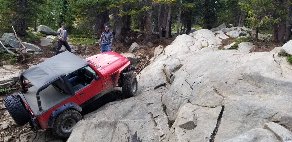

I run bestops safari top and tonneau cover in the summer months. I dont have an issue with flapping noise at all. Its not 100% at keeping water out but thats a chance you take running a safari top.
(just trying to show how taught it is, hardly flaps at hwy speeds)
Same here. Nice and tight. Can even stay warm in the snow!
