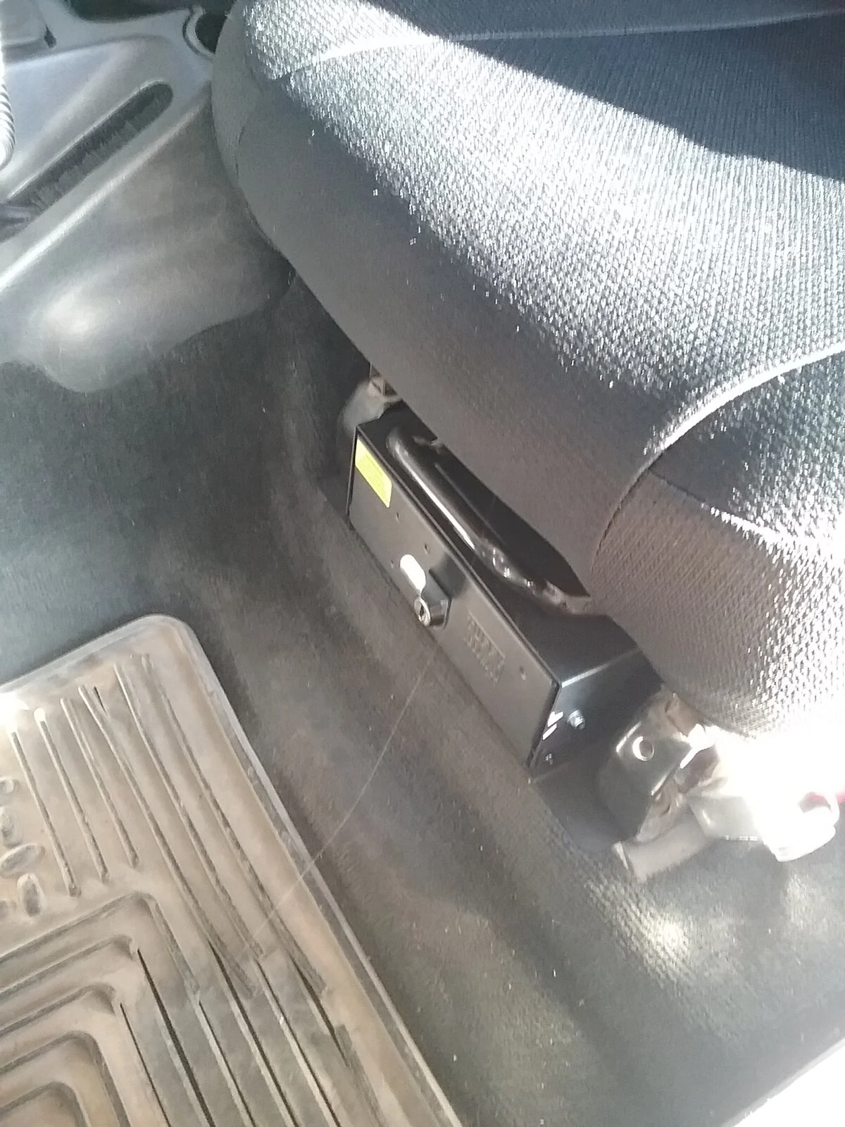

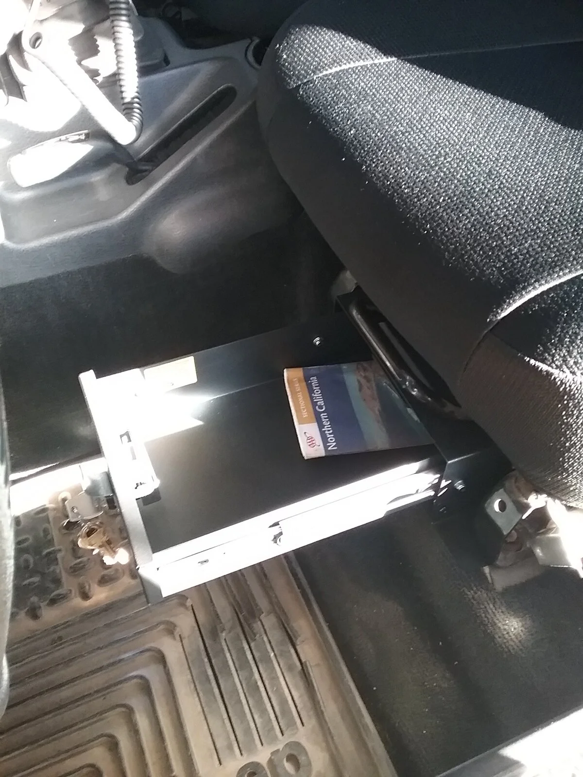

No experience with Bestop's version, but I just installed the Tuffy lock box under my driver seat with no issues, other than trying to get the two bolts next to the tunnel installed. That was a PITA.

No experience with Bestop's version, but I just installed the Tuffy lock box under my driver seat with no issues, other than trying to get the two bolts next to the tunnel installed. That was a PITA. View attachment 283343View attachment 283344
Good thing you keep that map locked up there, Bob. I hear those are highly valuable to the ever elusive map thieves. ;)

Paper maps are antiques now so they are worth their weight in gold. Now you gotta do like @Zorba and get a smart phone to get around! 🤫
