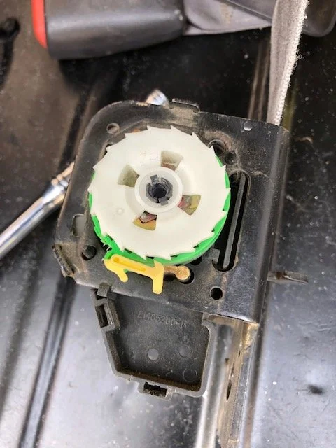

It'd be hard to find a better than factory conventional 3-pt. seat belt. What are that belt's symptoms? Could someone like one of your kids have spilled something sticky into its mechanism? If so it's possible that simply flushing the mechanism (primarily the orange cup and yellow lever/trigger) out with WD-40 which is more solvent than lubricant may restore it back to good operating condition.
Also be aware that our seatbelts can be locked up if the Jeep is parked on a hill, they won't lock by yanking on the seat belt. See the silver ball below? It is designed to roll out of its cup during a sudden stop which locks it up. Unfortunately that means it also locks up on any kind of a slope.

@Jerry Bransford So I took my rear seat belts apart yesterday and the first one I did was the working one and it was gummed up a bit but I lubed it all up and reinstalled and it works better than ever!
Then I went to take apart the other one (the non working one) and low and behold it doesn't look like the other one. The cup and ball are missing.....

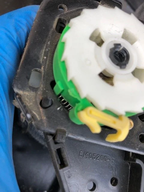

Am I missing something here? It should have that part correct? Also in the second photo you can see that spring behind the green piece....it's pretty hammered. Not sure if it's even supposed to be in there. Needless to say I cleaned that all out and reinstalled but you can't even pull on the belt at all, it's constantly locked up.
Guess I need to order up a new one?
