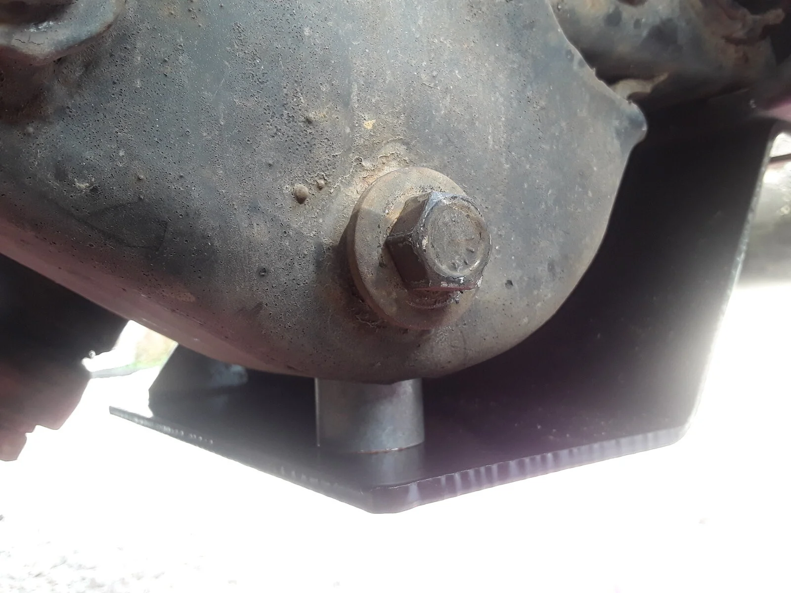

OK, I have a significant update to provide on this.
I thought I would have another look at the Teraflex steering box skid, having looked at how the Savvy one is fitted. I have now managed to fit it, but it does not fit in the same way as the LHD version. Rather than having a tab or bracket that allows fixing with the lower steering box bolt, you need to put a bolt up through the drain hole in the frame. I followed the really helpful advice from @MountaineerTom and @Irun and pushed a wire up from the drain hole and through the small gap at the top of that section of frame. I then threaded a flange nut onto the wire and dropped it into the frame, the nut runs down the wire and lands over the hole. You can then remove the wire and insert a flat head screwdriver in from the top and jam it on the nut. Then apply anti seize to the bolt and insert it from the bottom, through the skid and the spacer included in the kit and tighten, once the nut is pulled down into the frame the serations hold it enough to allow full tightening. It ends up like this
As Teraflex include the instructions for the LHD version that fits on the steering box bolt (centre of picture above), provide no hardware for this fixing point other than the spacer and Jeepey.com who sell it in the UK seem to have no idea this is how to attach the part it is only due to help from this forum that meant I had any clue how to fit the part.
There is second mounting point onto the lower bumper bolt, which is easy to attach. The third fixing point requires a hole to be drilled in the cross member. I have drilled this hole but I am unable to get the self tapping bolt supplier by Teraflex to work. Once I have some M8 bolts and flange washers I thank I will use those instead of trying with the included bolt any more.
While it is not quite as bad as a part being missing, supplying the skid with instructions for another version that attaches in a different way is pretty piss poor IMHO. The fact the company that sells it does not know how it fits is not exactly great either - especially as they also have a workshop that fits them and they have ended up fabricating brackets to get them to fit.
