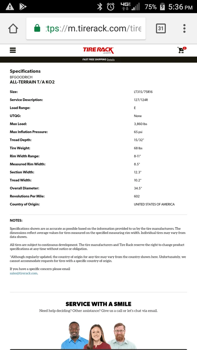

It may not be all posts, but a good number comment on measuring free mounted on the tailgate. Maybe not to 80psi though, yikes.
When shopping for tires, look up the "revs per mile" in the tire spec section.
Take 20168/revs per mile, this will give you a tire diameter in inches.
This method will give you a better idea of the actual tire diameter, however, it doesn't account for tire inflation pressure or rim width.
Here is an example with 315/75/r16 BFG KO2's
20168/602=33.5
That's only 33.5" for a 35" nominal size.
You can use this to compare tires while shopping without actually seeing them in person. Hopefully this helps.
Edit: notice how BFG claims this is a 34.5" tire
